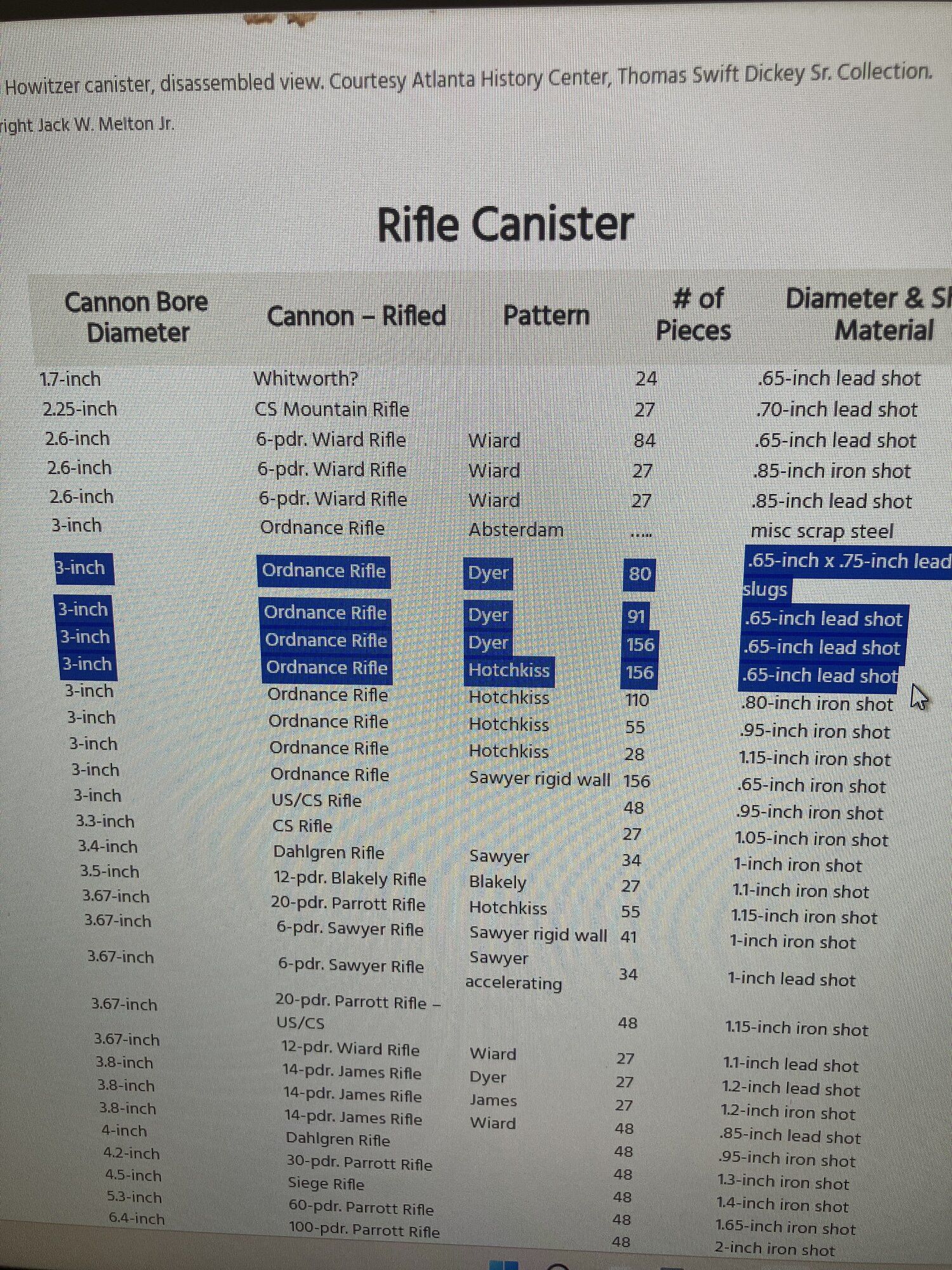

I did a little more digging and found this. Seems some 3" ordinance rifles had .65" shot. Does that sound right?
Edit: I just realized it said lead. Any of the irons perhaps?

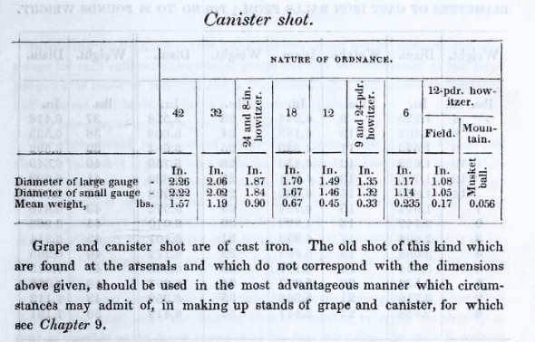

The lead canister shot was for rifled guns, to prevent injury to the rifling. Tousard's "Artillerists' Companion" (1809) mentions lead shot for canister, but that iron was preferred, as it could ricochet better, etc. He gives the following sizes of common iron canister shot... Some just under an inch...
The standardization of the iron shot was apparently imperfect, particularly going back some more decades into the mid-1700s.

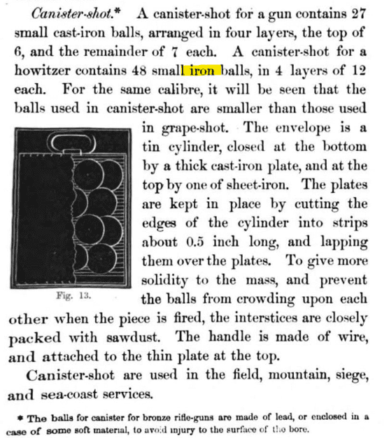

From p.78:
