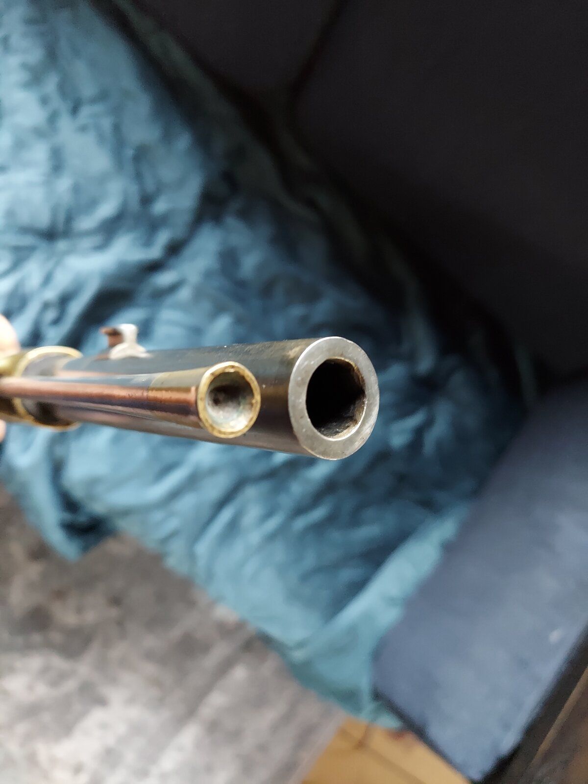

I just picked up an original Mississippi .54 (4th Model Harpers Ferry Conversion).. The bore measures out at .526. (micrometer and slugging barrel) I have a Lyman 54 Cal Minie mold that throws a .533 bullet. Is that to large to size down to a .525?? I really want to shoot it with a Minie if possible.
I notice that rifling is deep. I suspect a hefty charge is needed to expand that skirt to make it shoot accurately.

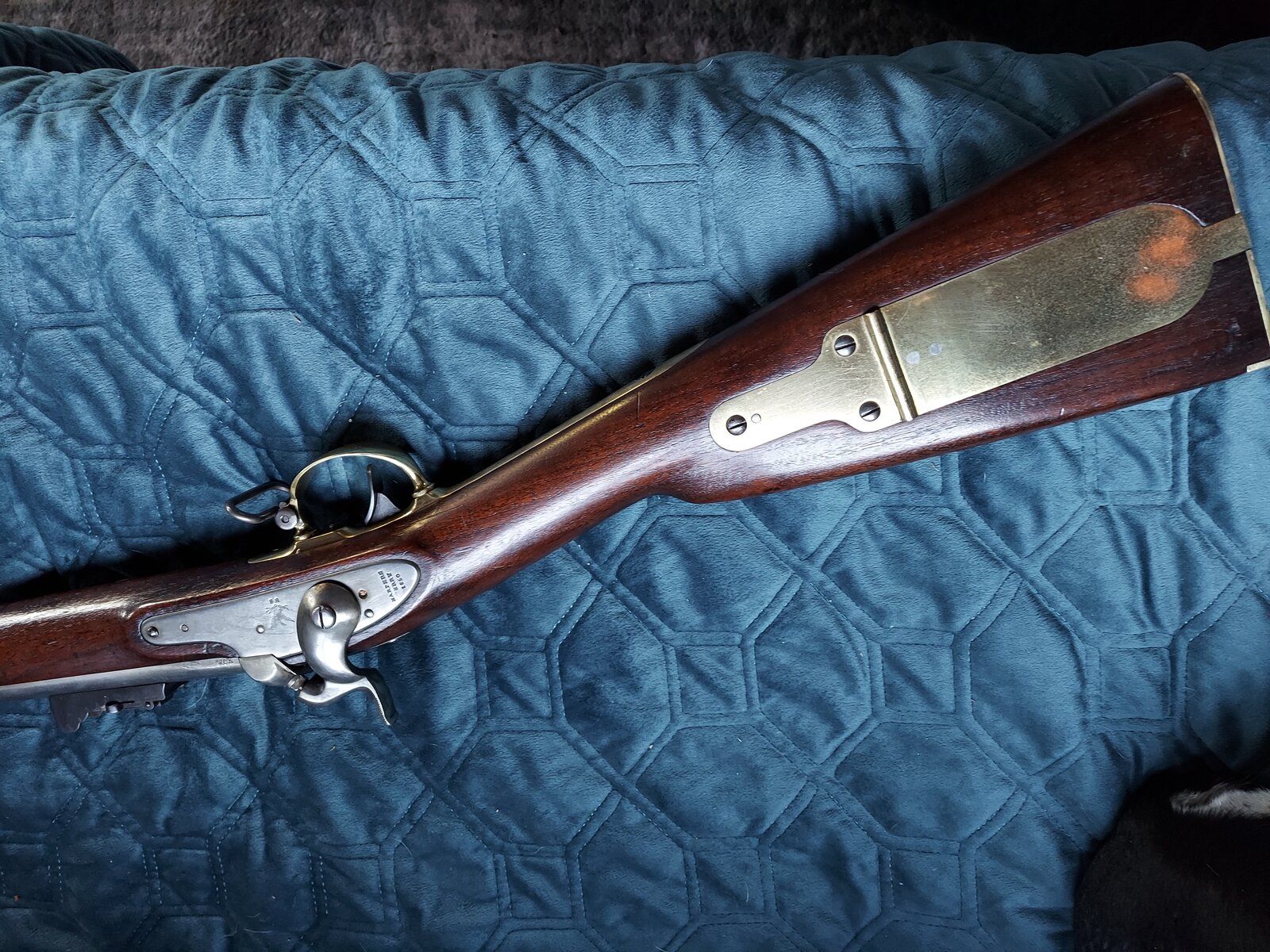

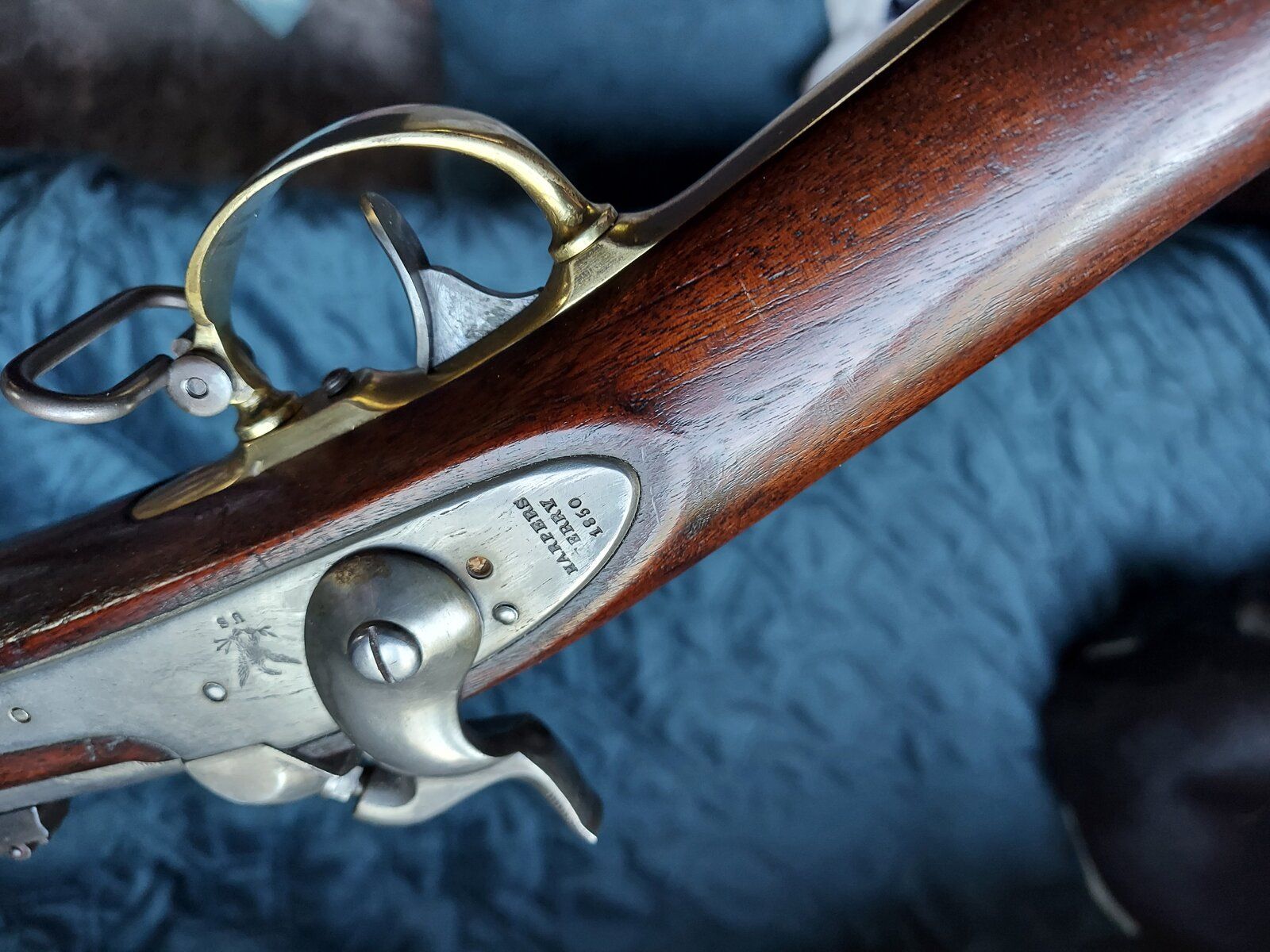

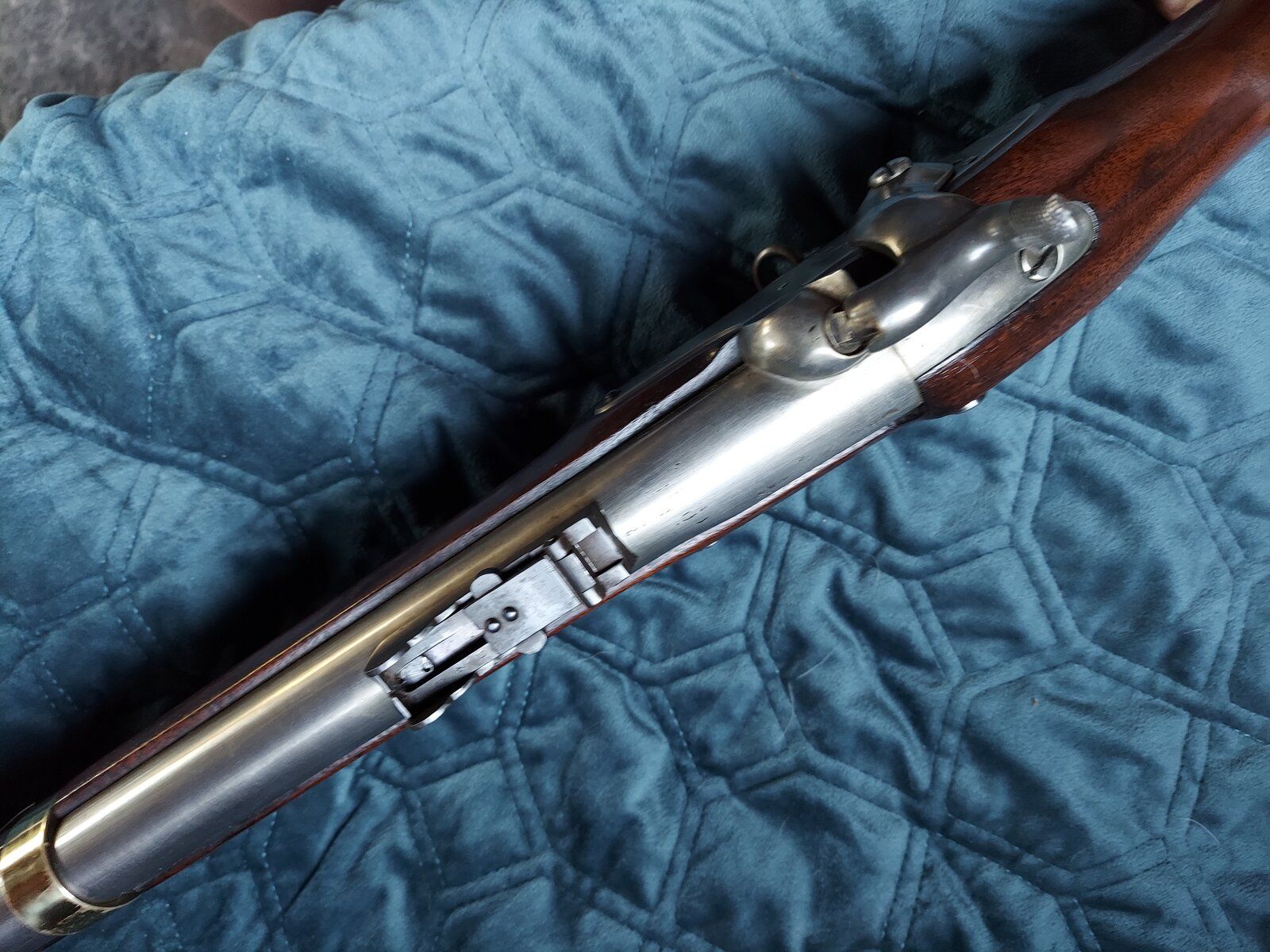

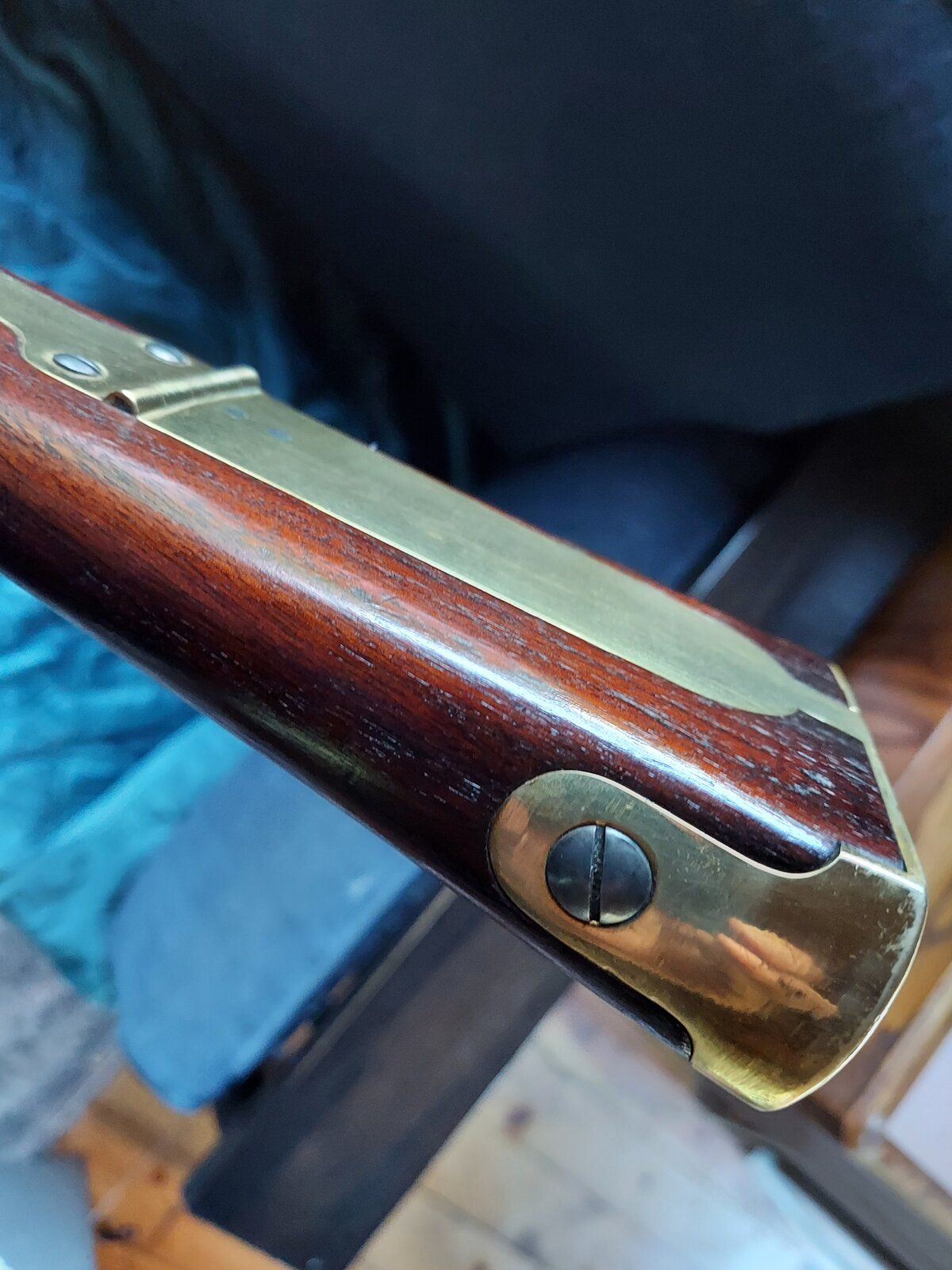

Here are some Pics ..

As you definitely know, the Model 1841 was a favorite of Confederate mounted infantry/ flying columns, and popular with infantry as well. Mine is in .58, and while it currently lacks a front sight preventing use, I've modified mine like some of those altered by Colt... I just neeed to get the crazy yataghan bayonet for it I guess? Some of the better shooting I ever managed in a skirmish was with a borrowed, loaned .54 using Minié/Burton balls... Thanks very much for the pictures! These are such handsome long arms, no?
I have attempted to measure the bore and it seems a bit bigger than previously posted. The 7 lands makes that tricky !!. I think close to the .530. My Lyman mold throws a .533 minie and it won't start down the bore. I am having a minie sizing die made in .529 which is a moderate step down and should work well. They are beautiful weapons and probably my fav along with the 1855 Rifle. I will follow up with results and maybe some range data. Always love doing that kind of experimentation...
That Model 1841 is one of the most beautiful US martial arms ever made with a lot of history going for it. And you have one that appears to be in exceptional condition as well as being produced in Harpers Ferry. Thanks for sharing the photos.

The sights and the brazed-on side-mounted bayonet lug on your superb example would have been added much later... Possibly in the 1850s or 1860s. That one was certainly never "ridden hard and put away wet..." Superb condition.
Interesting that the adaptation of the 55 Rifle rear sight would not have also involved making all of this variation into .58 Standard caliber? Maybe it was early enough in the adoption of the .58 Minie/Burton bullet that they didn't want to throw all the eggs in one basket so to speak. Its survival in such good condition probably speaks to that. At that time the energy would have been in making 55 Rifles and Rifle Muskets. In Confederate hands it would have gone immediately into service but possibly not so much in the North which was focusing on .69 and .58.. Does that make any logical sense?

I know the bore is less than .533 which is the diameter of the minie bullet I cast. It won't go down the bore but you can tell it is just oversized.. My guess is that bore is around .531. I have ordered pin gauges so we will soon see.
Bore comes out at .5325 which makes sense for seating a .530 round ball.. A .532 sized minie will work nicely.
