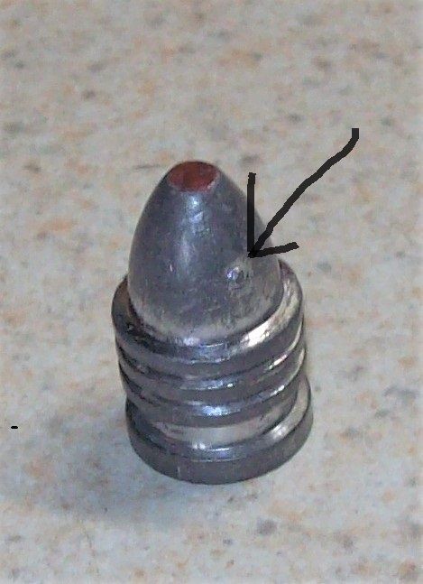

5. & 6. USE A CENTERPUNCH TO PUT A SMALL INDENTATION ON ONE SIDE OF YOUR MOULD IN THE NOSE SECTION. THIS WILL GIVE YOU AN INDEX MARK ON EVERY BULLET YOU CAST.
An index mark has many different uses. For example, if you size your bullets as many do, make sure that your index mark always faces the same way before you run the bullet into the die. If there is the slightest imperfection in your die, now you can be assured that you are compensating for it and minimizing its effect on your bullets flight.
Which leads to my next point. When shooting individuals, use the index mark to make sure that every bullet starts into the rifling exactly the same every time. Using the front sight as "l2:00 o'clock" while you are at the bench, try a group at 12 o'clock, 3 o'clock, 6 o'clock, etc. and see the difference it will make in your group size. Hairsplitting again, but it does help.
I can't take credit for this idea; it belongs to every benchrest shooter I ever talked to. These are the guys who are trying to put 10 rounds into the same exact hole at 200 yards. The guys who shoot in the Cast Bullet Association feel that it is doubly important for them. They're trying to do the same thing using cast bullets only. Or you can ask the guys who are shooting blackpowder cartridge using iron sights at 1000 yards whether they use index marks. If it works for them, it'll work for us.

THIS is that index mark he talks of:
