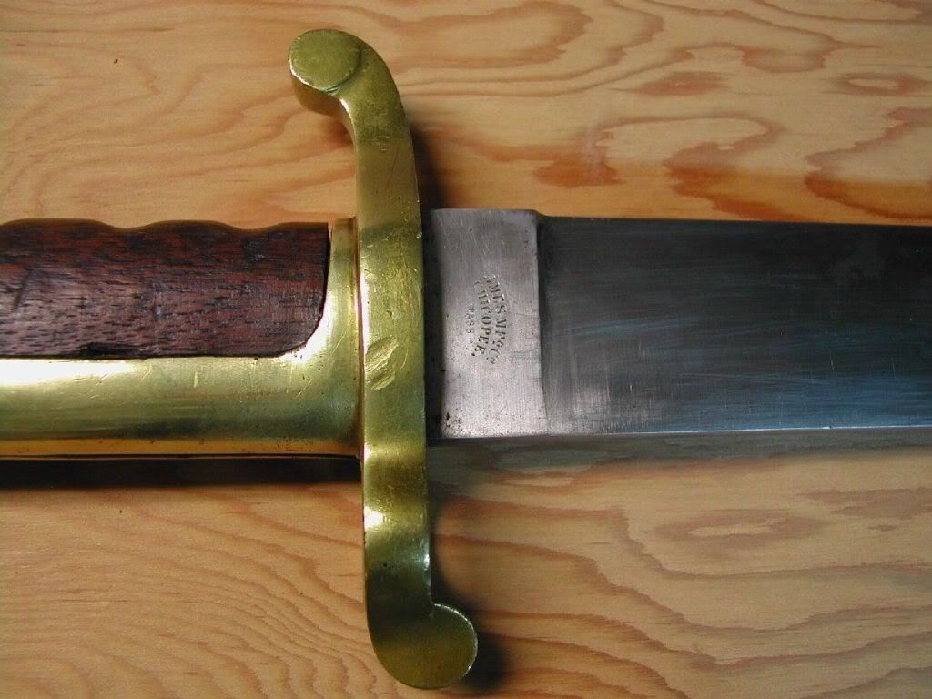

-Model 1840 Musicians swords.
Manufactured by Ames Mfg Co
Chicoppee
Mass
(left ricasso)

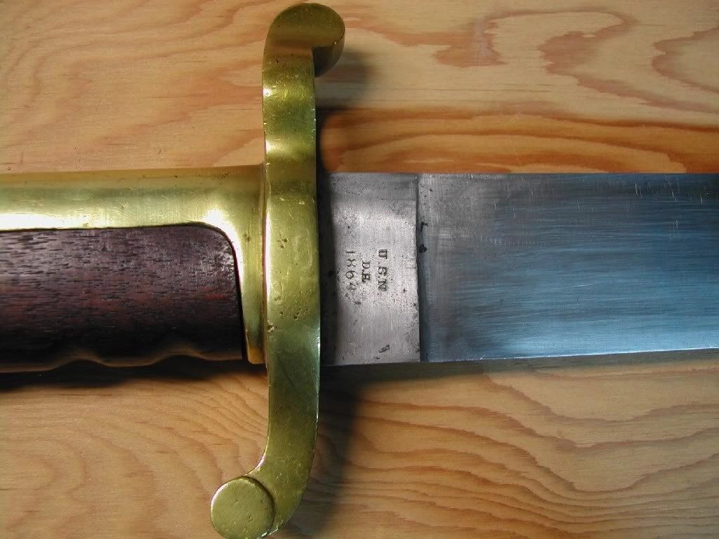

U.S.
C.S.L.
1864

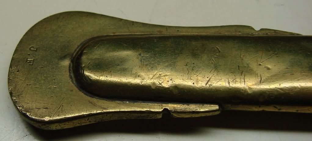

Inspector's initial J.F. on the drag.

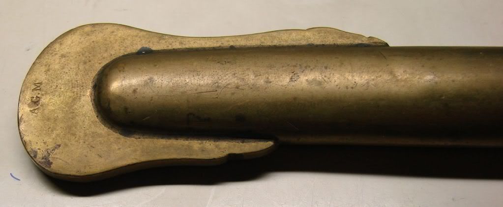

Inspector's initials A.G.M. on the scabbard drag as well as A.G.M on the brass Knuckle Bow.
