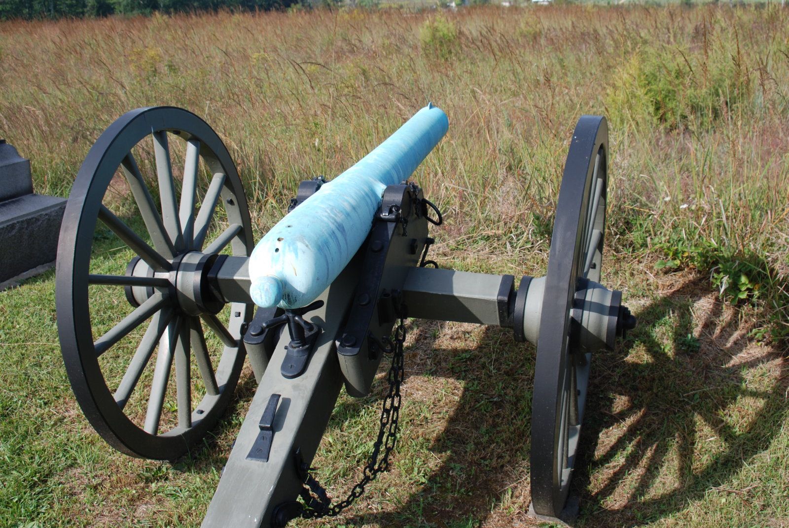

14 pound Aimes Rifle type One, Chicago Board of Trade Battery position, Stones River N.B.
The CBT Battery fired almost 1,500 Aimes projectiles on Dec 331, 1862.
Some 1841 Model 6 Pdrs were rifled to accept the Aimes projectile, as well as identical new cast tubes like this one.
The Aimes Type 2 is an elegant, very modern looking design.
The battery placed here near the Round Forrest fired over 1,000 rounds on Dec 31, 1862.
The Army of the Cumberland had 45 Aimes rifles in June 1863 at the start of the Tullahoma Campaign. The Army of the Tennessee had Aimes rifle batteries during the Vicksburg Campaign. If memory serves, there was at least one Aimes battery at Gettysburg. After the Tullahoma-Chickamauga-Chattanooga, the Aimes Rifles were relegated to fortifications. With the death of Aimes, there was no longer anybody lobbying for the Aimes Rifles. The projectiles were used until the end of the war. There are four Aimes Type Ones on the square in Franklin TN.
Indeed, the bronze rifled James were a transition piece. However, they were very effective. The idea was that bronze guns were extremely durable, unlike their cast iron contemporaries. The bronze could easily be recast into new guns. The advent of the semi-steel 3" ordinance rifle of the same profile made the bronze Type Two obsolete.
Note: The reason for the smooth model looking design of the 3" rifle was the discovery that the 90 degree corners of the decorative elements on cast-iron cannon projected cracks. Fatigue failures from the stresses caused by the traditional decretive elements account for the smooth bottle shape of cannon circa 1850 onward. Of course, the bronzed Type Two was not subject to the fatigue cracks, but Aimes adopted the elegant modern shape to be stylish, if nothing else.
