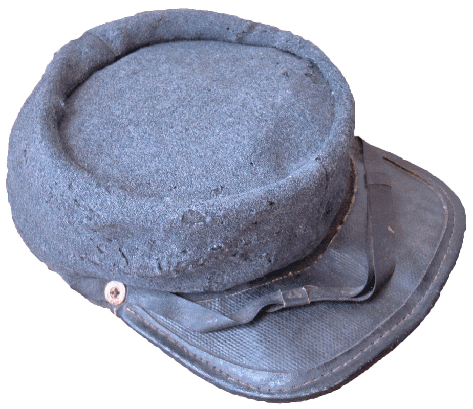

There are fewer than 10 known, maybe a few more that we are unaware of, but no two are really alike, with the exception of the osnaburg lining, the tarcloth brim as pictured and English Army Cloth (wool). My avatar is of an RD artillery kepi from the Richmond Howitzers, in my collection.

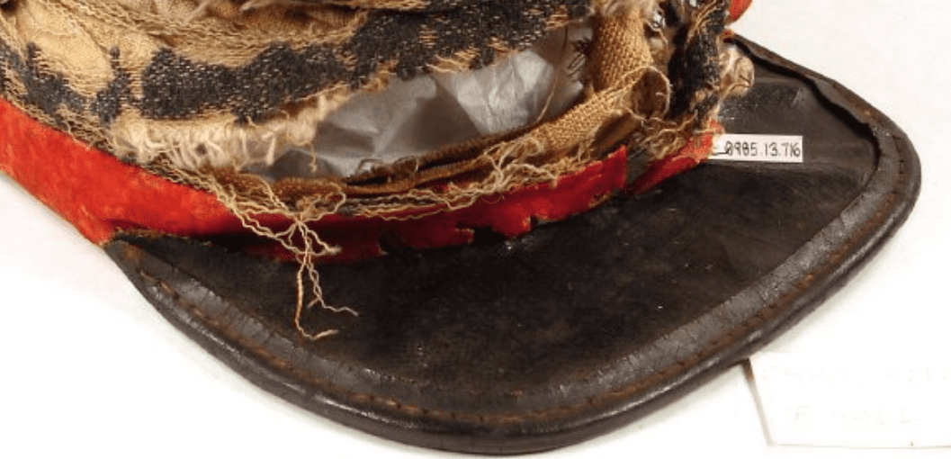

For the visor, perhaps you can get pasteboard from art supply stores online (or perhaps make your own by laminating manila paper with glue). Then cover with plain weave cotton, and paint black. Then glue on the edging (also painted fabric), and stitch tightly... looks like perhaps a common leather type stitch (two needles on one thread...). Here is a closeup of Pvt. Royall's cap, which is the one described in the "Sketchbook."
Royall cap; Am. CW Museum site...
