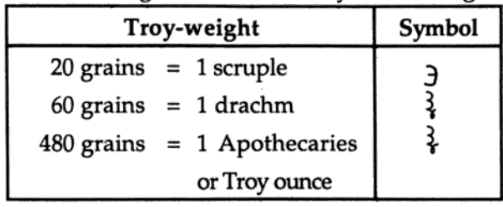

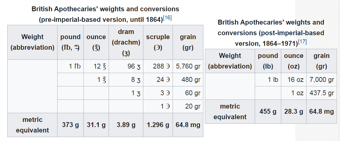

I remember the first time I saw the symbol for ounce - I thought I had developed double vision because it looks like a 3 with the top half of another 3 above it. Here's a chart that should be very helpful when you run across a symbol that you don't recognize as a regular letter.
