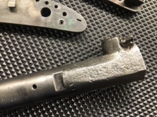

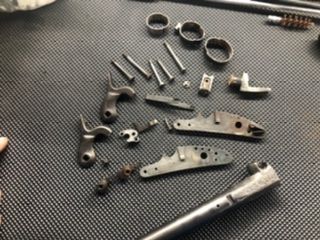

I have a musket I'm trying to bring back to life. It was handed down threw my family. I have the breach plug out and after a metric S ton of cleaning I still see no end in sight of rust. I have a donor rifle for the lock work but I see I have missing screws and screws busted off that need removed then tapped . The leafs are all busted off the rear site and the pass threw from the nipple to the chamber is plugged. The screw is buggered and froze up.
the nipple is froze up and buggered also.

I had in the back of my mind that the parts would not interchange. Ugh. I stumbled across this forum after I started the restoration. Here are a few pics.
the donor rifle I have has a Norfolk 1863 side plate. the one I am restoring has a 1964 Providence RI side plate.

The rifling is good from about 7" out to the end. It is remarkably still sharp and visible. The bottom 7" is a whole different story. I wonder if there was a load stuck in there for a extended period and then it got pulled or pushed out. I'm leaning that way bc the breach plug had been removed once b4 I got to it.
You're lucky it wasn't still loaded when you got it. Bore doesn't look too bad, but get the barrel inspected before you shoot it. I'm a little leery about that stock though. Looks a little too "orange". The pitting at the breech shows what the old fulminate of mercury caps would do to metal.
The metal has been chemically cleaned, I think, with some sort of rust remover such as naval jelly, and the wood cleaned to a bright color, and I would guess it was your uncle who made these improvements.
After cleaning a 5gallon bucket of rags worth I finally got the barrel to stop putting off rust.
I was able to get the passage from the nipple to the barrel open and now I am looking forward to getting the screws replaced and the lock work repaired. I'll have to do the rear site as well.

So I got the nipple out and all but the one screw on the barrel below the nipple. The screws I needed I ordered from lodge wood. Thank you for the info on where to get them. I pulled the rear sight apart and had to file the sides a bit to get the blade to rotate into place. Looks like it was dropped a few times on it. The lock work is all original and the hammer is off the donor rifle. Unfortunately the original had a huge hole in it where it would impact the nipple. The middle band where the sling swivel should be. Has had the sling band busted off. I'm not planning to replace it at this time.
had the barrel inspected b4 I reinstalled the breach plug. The worst part of the barrel was at the breach. And not as bad as I thought. So I can shoot light loads threw it.

On the down side. The lock plate isn't as sharp and clean and crisp as it used to be. Still need to find a screw for the bayonet lock.
