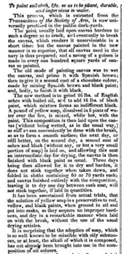

From Mackenzie's reciept book, 1851 edition...
Mackenzie's Five Thousand Receipts for Domestic Arts, 1851...
And from Military Collector and Historian, Summer, 1994:
