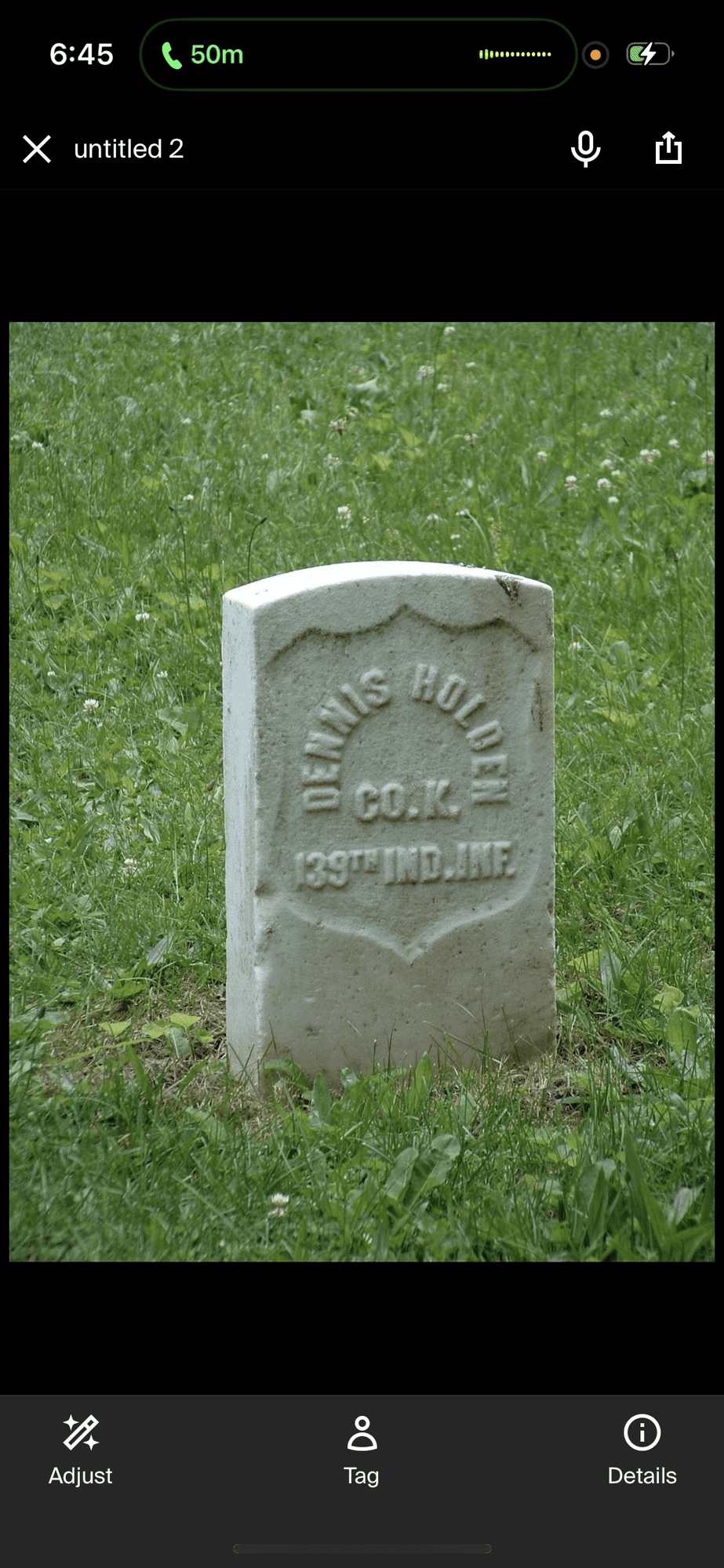

If anybody can help me out with this, I greatly appreciate it. I've recently found the location of the burial site of my great-great-great uncle, Dennis Holden. All the obvious family information seems to line up, I definitely had an uncle named Dennis Holden who participated in the Civil War and the grave is located in the town I know he lived in alongside his brother who also served. The problem is the inscription. The headstone was contracted in 1884 and it lists him as being part of the 139th Indiana infantry company k. The problem is that all government records seem to list him with the 142nd Indiana infantry. After searching through all the records for the 139th there is no Dennis Holden mentioned. My question is, how can this be? I can't imagine the family making an error with headstone that is this egregious, however, government records put him with 142nd, and I would think these records would be pretty precise. Any thoughts about this mystery? Thanks for all of your help.

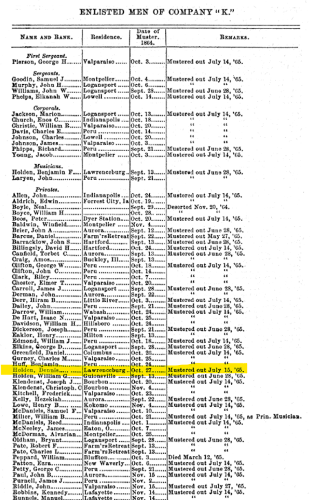

At the link below is the Vol. 7 Report of the A-G of Indiana showing the rosters for both of the regiments mentioned. (The report is derived from official rolls, returns and other documents).
The shown rosters of the 139th IN Infantry (see pp. 416 - 427) shows no soldier with the last name of 'Holden' in the regiment.
However, the displayed rosters of the 142nd IN Infantry (see pp. 444 - 458) reveals the name of 'Pvte. Dennis Holden' as a member Co. K. He was a resident of Lawrenceburg, m/i on Oct. 27, '64 and m/o on Jul. 15, '65. (See p. 457).

Based on the above information found, it appears Pvte. Dennis Holden belonged to Co. K, 142nd IN Infantry. The unit inscription shown on the headstone seems to be incorrect. This could have been due to any one of a variety of unknown reasons for any mix-up. But this finding needs further corroboration to be conclusive.
I must concur that it appears the headstone likely gives the incorrect regimental number.

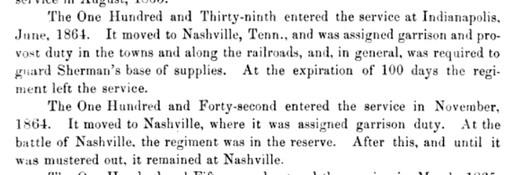

The 139th Regiment of Indiana Volunteers was organized for 100 days service in 1864.

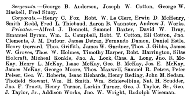

Here's another roster of Company K, 139th, As mentioned, no Dennis Holden shown therein...
Company K, 139th Indiana was in active service from June 6 to Sept. 29, 1864...
142nd Regiment of Indiana Volunteers was mustered into US Army service for 3 years from late 1864.
As mentioned, Dennis Holden is recorded among the privates of Company K, 142nd Indiana Volunteers, mustered into service Oct. 27, 1864. Discharged July 15, 1865.

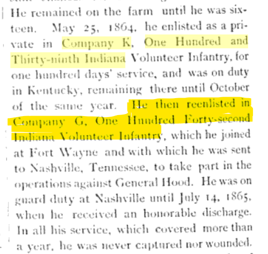

Some veterans of the 139th subsequently enlisted in the 142nd Regiment, like William Henry Worden of Whitley County...
But it does not appear that Dennis Holden had previously served in the 139th Indiana.
