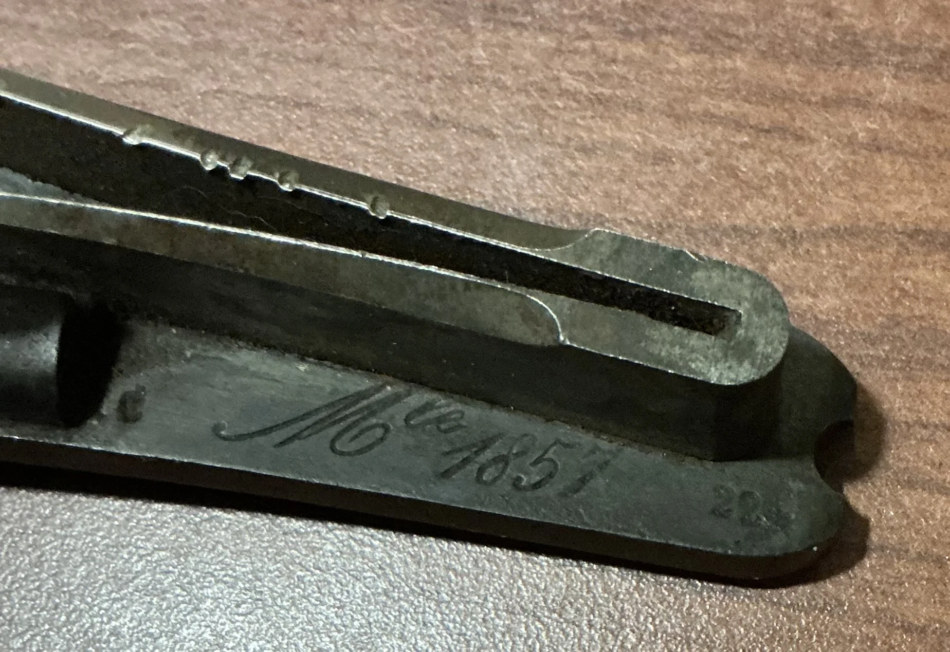

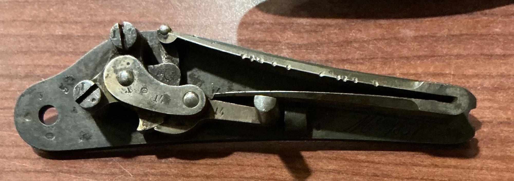

This lock is very similar to the one I posted a few days ago. I have seen several of these on the internet.
From what I can gather, it is a French Model 1857. Of the ones I have seen on the net most have the arsenal stamped onto the face.
The face of this lock is totally void of any stamps, but there is Mle 1857 stamped on the reverse. So is this a French Mle 1857 or is it a Belgian copy?
Thanks
The French state arsenal markinga are all in similar script, HOWEVER, I notice the mainspring has asemblers marks on them - the old British/Belgian type made by hamering a turnscrew(?) into the metal - |,\, /, X, V. Plates, springs anor lockplates were often stamped on the edge. The model stamp on the inside looks very French as do the numbered inspectors' marks (14, etc) on the individual parts. So this could be a piece, possibly an outside contract piece, with a broken mainspring repaired in Belgium.

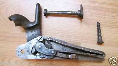

This is a French/Begian lock from a 'Zulu 12-gauge' with similar markings

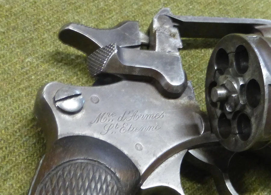

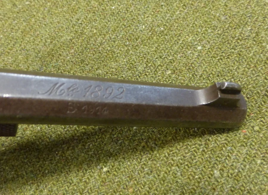

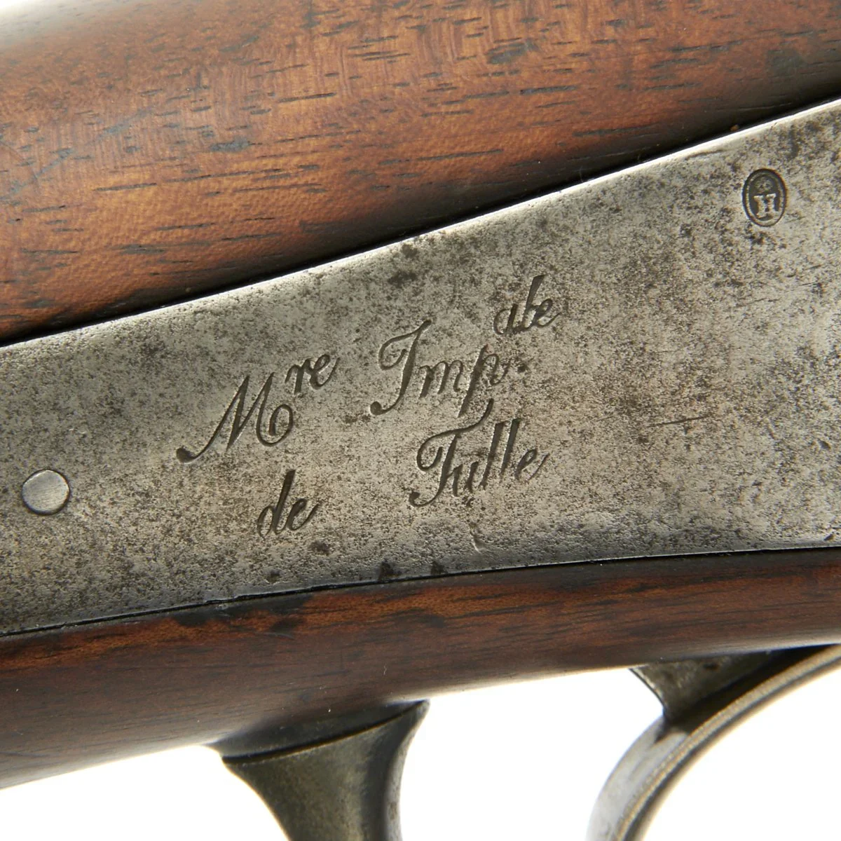

Pure French locks would have their markings visible on the lock plate
Ah, yes, those French - such spendthrifts with those curls and swirls on their lettering, and the lettering itself usually slanted italic-style!
