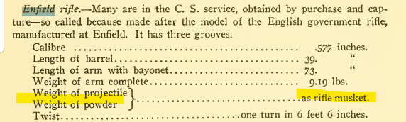

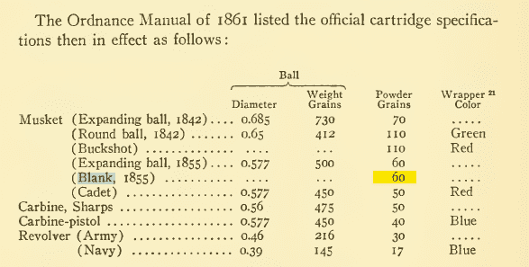

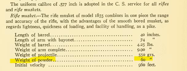

The 1860s live round for the Enfield cartridge contained 60 grains of black powder.
Blank cartridges also 60 grains.
The British at the time were using blanks with 3.5 drams of powder, or just over 90 grains. But they were cheeky fellows.
Reenactment events often have posted maximum charges for use on site. 60 grains max seems standard. As mentioned above, wadding and ramming the cartridge paper might add something to the report, but being particularly loud wasn't necessarily their purpose.

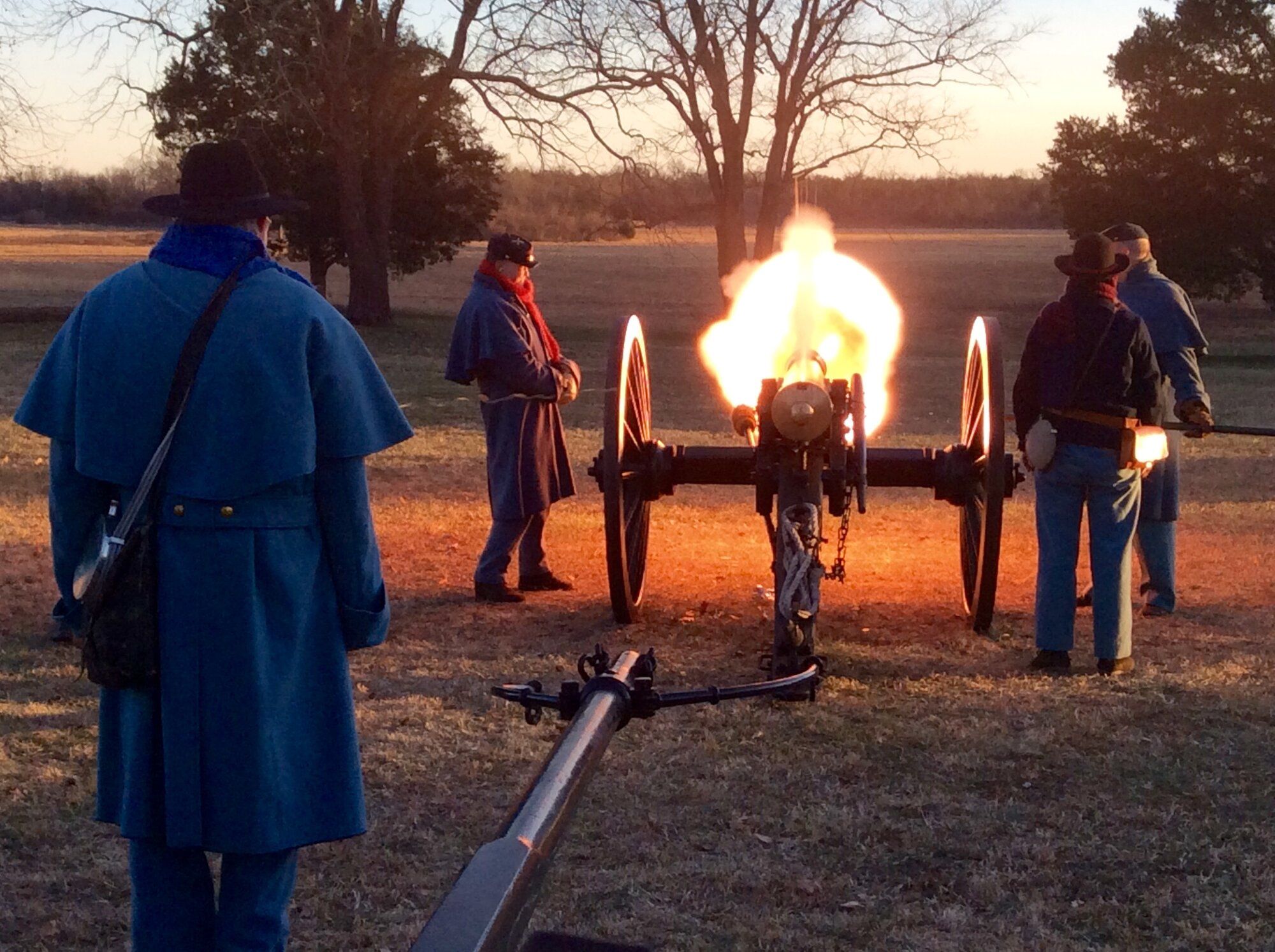

while my expertise is in Artillery, here are my thoughts on it. Your mileage with muskets may vary.
Black powder is not black powder. For artillery, our battery is very particular as to the brand of powder we use. Powder from different manufacturers won't burn the same for blanks even if it's the same size of powder grains. We have found for us that Schutzen powder was the best for artillery, with Goex next. both of those give us the most Boom per load. We know one battery that purchased powder at the Daniel lady Farm bulk purchase they had a few years back. They are sorry they did. When fired out of a cannon, that powder gave no boom, just a Fwooosh. While is's expensive to do, it's best to try a few brands to see what gives you the best results.

A while back, Stones River received a considerable store of U.S. Navy torpedo warhead explosive for use in our 12 pound living history demos. The grains were about the size of thumbnail. The report was a drawn out kaaa-whooo-whammmmm with an enormous fireball that would roil down range. Nobody ever got used to it… numbers one & two eased back away from the muzzle as far as dignity would allow & perhaps considerably more.
