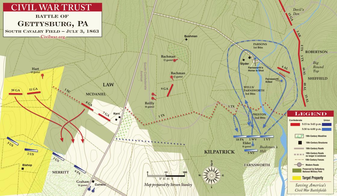

Thanks 67th Tigers; I shall have to get a copy of Busey and Martin for the long haul - I can't seem to find the numbers for the South Field action either , save 300 engaged with the 1st Vermont but I was under the impression more of the 3rd div. were committed

Superlative, thanks again! - am I right in the notion that the 5th NY was not engaged as part of Kilpatrick's assaults, and that the 18th, 1st VT and 1st WV were committed sequentially?
The 5th NY Cavalry were posted to support Elder's battery. I believe a squadron may have moved forward but didn't charge. Indeed the 1st WV, 18th Pa and 1st Vt charged sequentially (in that order) against the 1st Texas Infantry. The last charge broke through but then what? They were unsupported and surrounded by the enemy.
