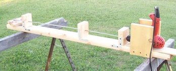

An Electric Drill, 2x4's, and a file, and you are all set up to make a home-made lathe. The pictures show one I made of the same materials listed. I do all my ramrod re-shaping with this set up.
Kevin Dally
I like your lathe, Kevin! I may have to copy it.:thumbsup:
