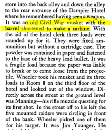

There is an article online dated September 6, 2015, by the Pioneer Press titled, "Gun used to kill bandit in famed 1876 raid returns to Northfield." Apparently there is also a watch given to him by one of the banks and a pistol he carried after the incident. You have to supply an e-mail address to get access to the whole article. The gun does not appear to be a cut-down musket but instead a breech-loading Smith Carbine.
There is a photographic portrait of Henry Wheeler seated and holding a fur hat in one of his hands at this link:
There are a number of images on a flicker account including the carbine, Cole Younger's pistol and belt rig. It's a Moore Revolver, the belt is black leather army surplus with a rectangular eagle plate and black leather holster.
Smith Carbine at:
.32 cal. rim fire single action model 1860 Moore revolver at:
