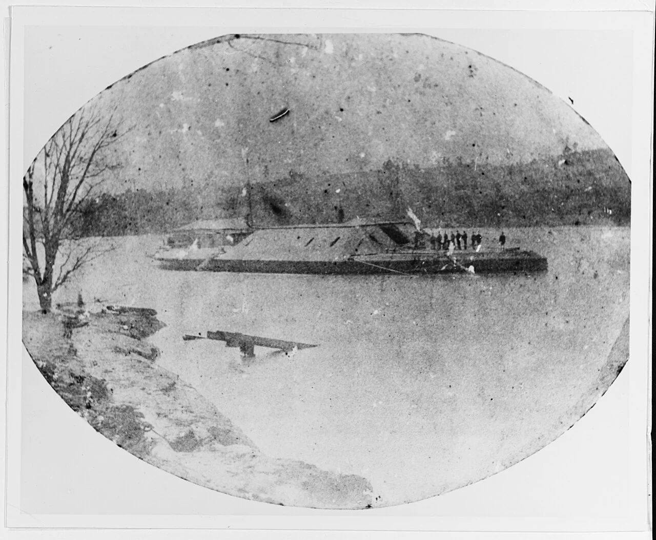

The plan of the ship by Robert Holcombe, which I have an original copy of from Bob, showed a conventional rounded stern. Then some years later, after Bob had retired from the Curator's post, the Museum decided that it had the same porpoise stern as the "Wilmington". I pointed out that the vessel remains did NOT fit that configuration ("Wilmington" was a conversion from a Porter 189ft pp plan with the "porpoise bit added). Eventually they reluctantly agreed.
Received wisdom is that Jackson was a rebuild of a centre wheel ironclad which Lt Augustus McLoughlin (spelling?) insisted be called Muscogee after the local Native Americans. When John L porter arrived as the vessel was under "reconstruction" he peremptorily told the Lt "Your ship is called Jackson" - and that was that.
Porter is credited with the design of the centre wheeler , but there are so many differences between a Porter ironclad and the Jackson that I think it was Chief Engineer James H Warner's project as completed. the hull bears a distinct resemblance to his plan for a monitor type turretship..
The photograph of her afloat after launching was taken in December 1864.
