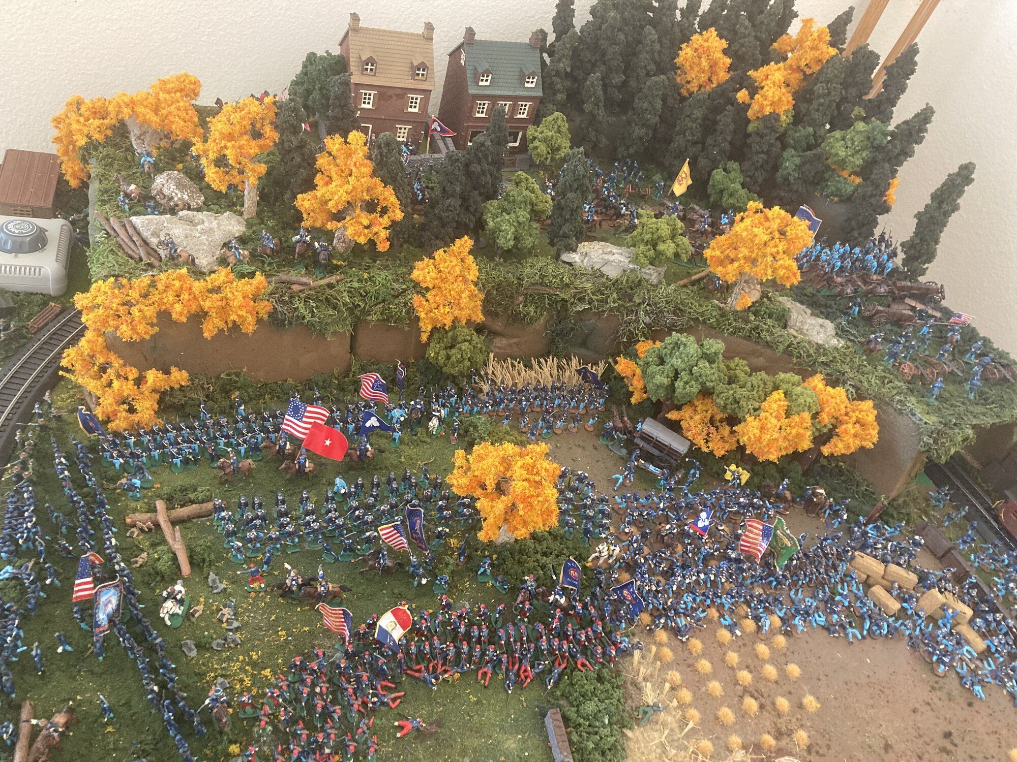

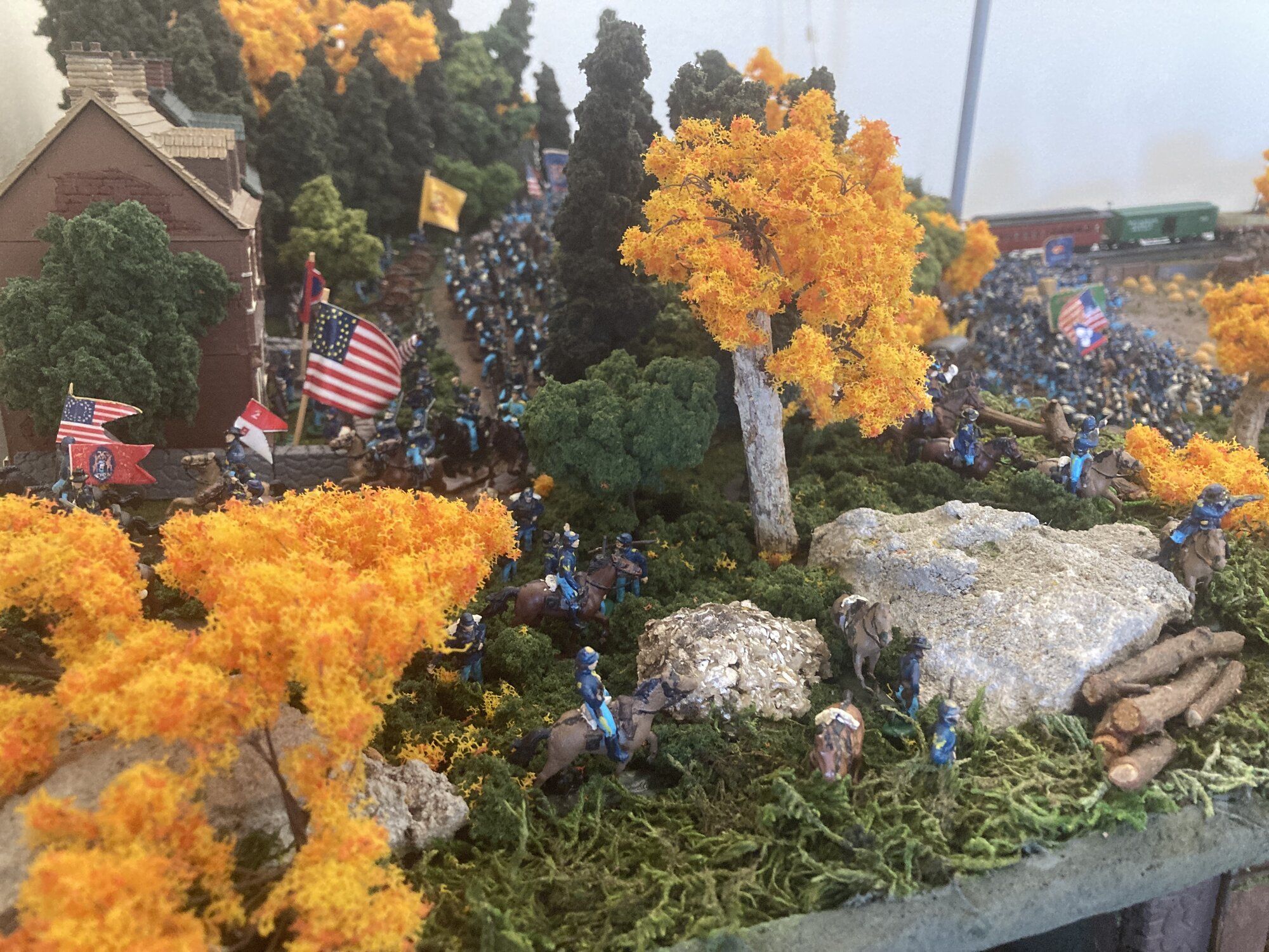

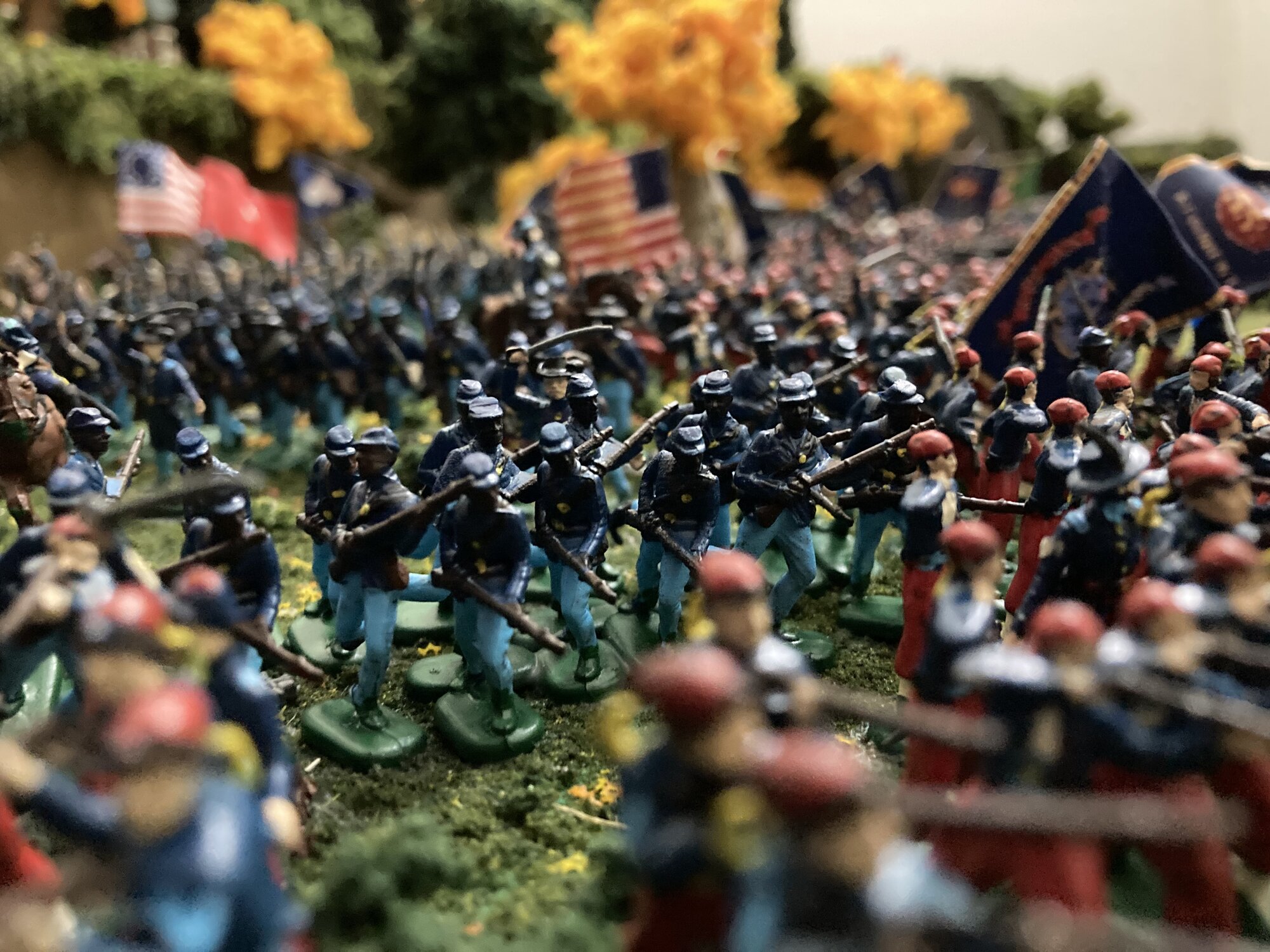

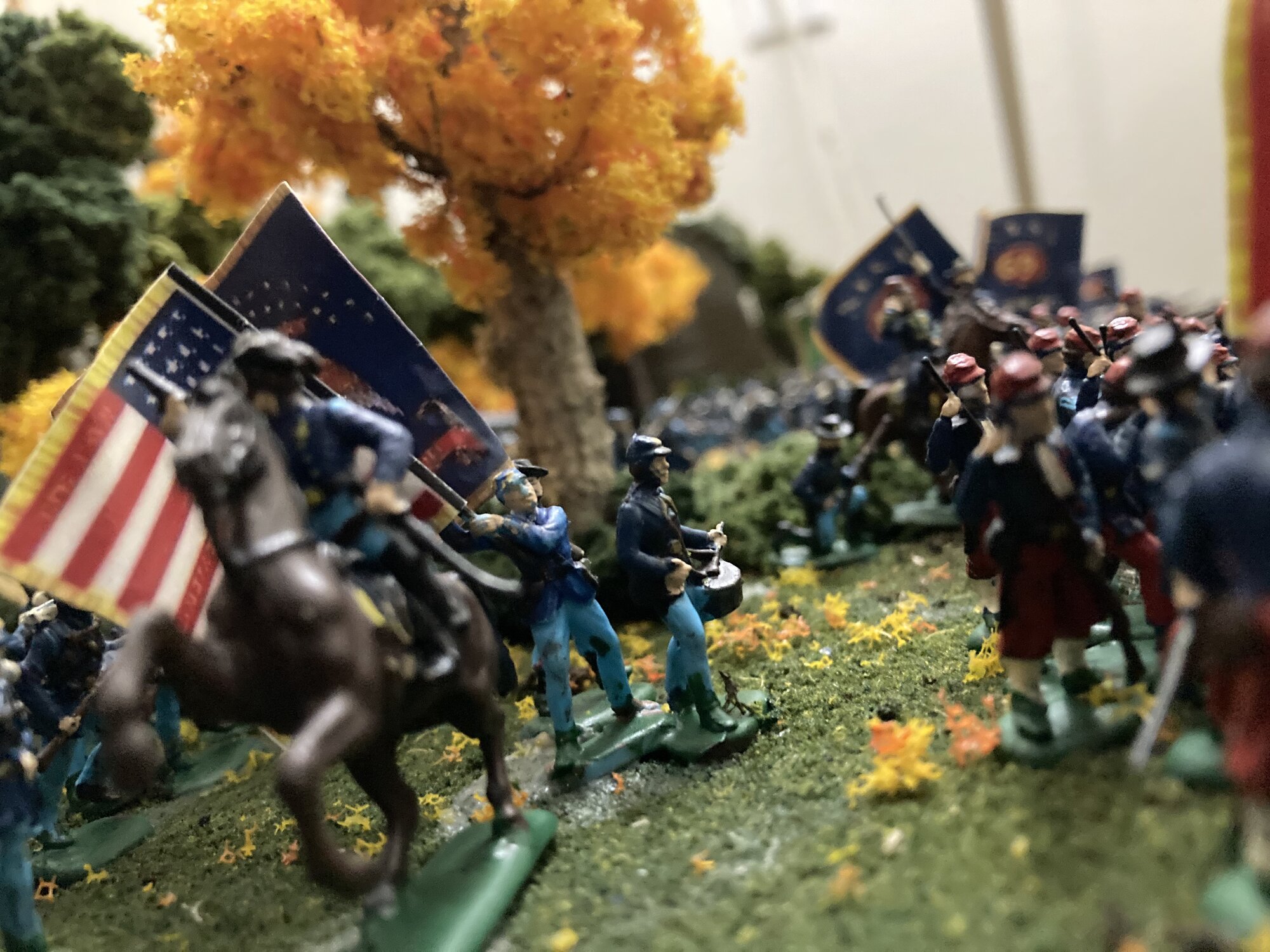

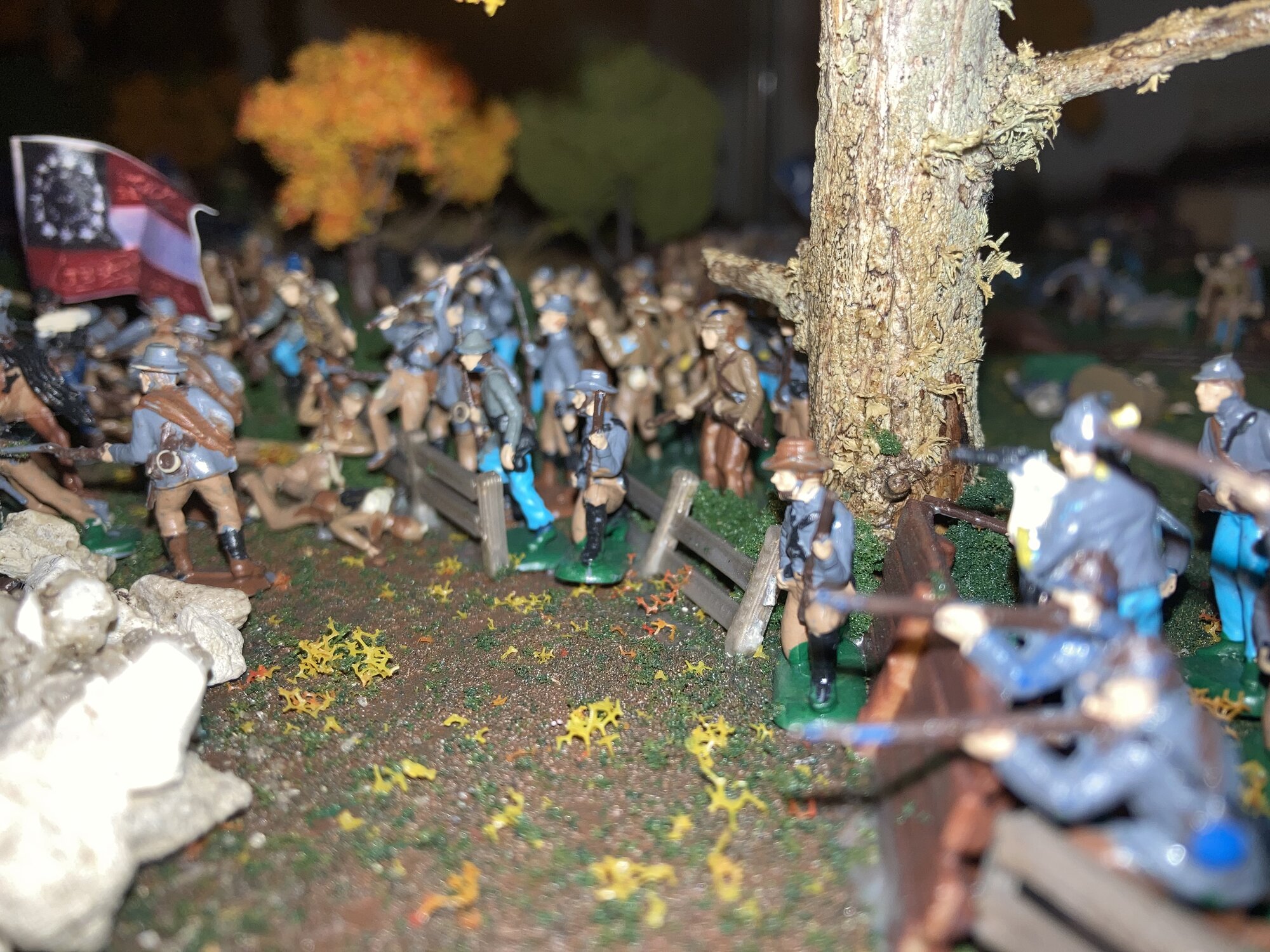

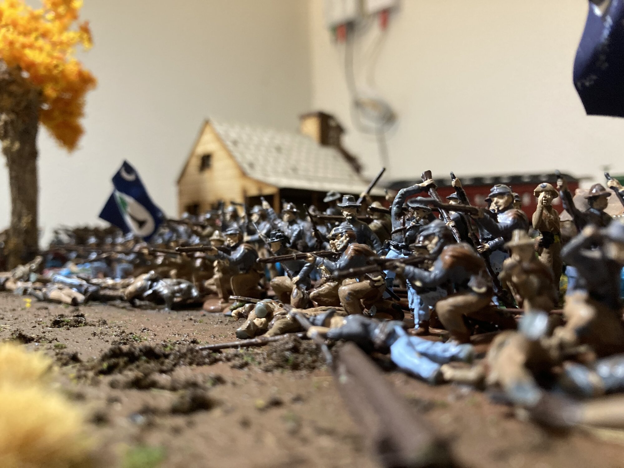

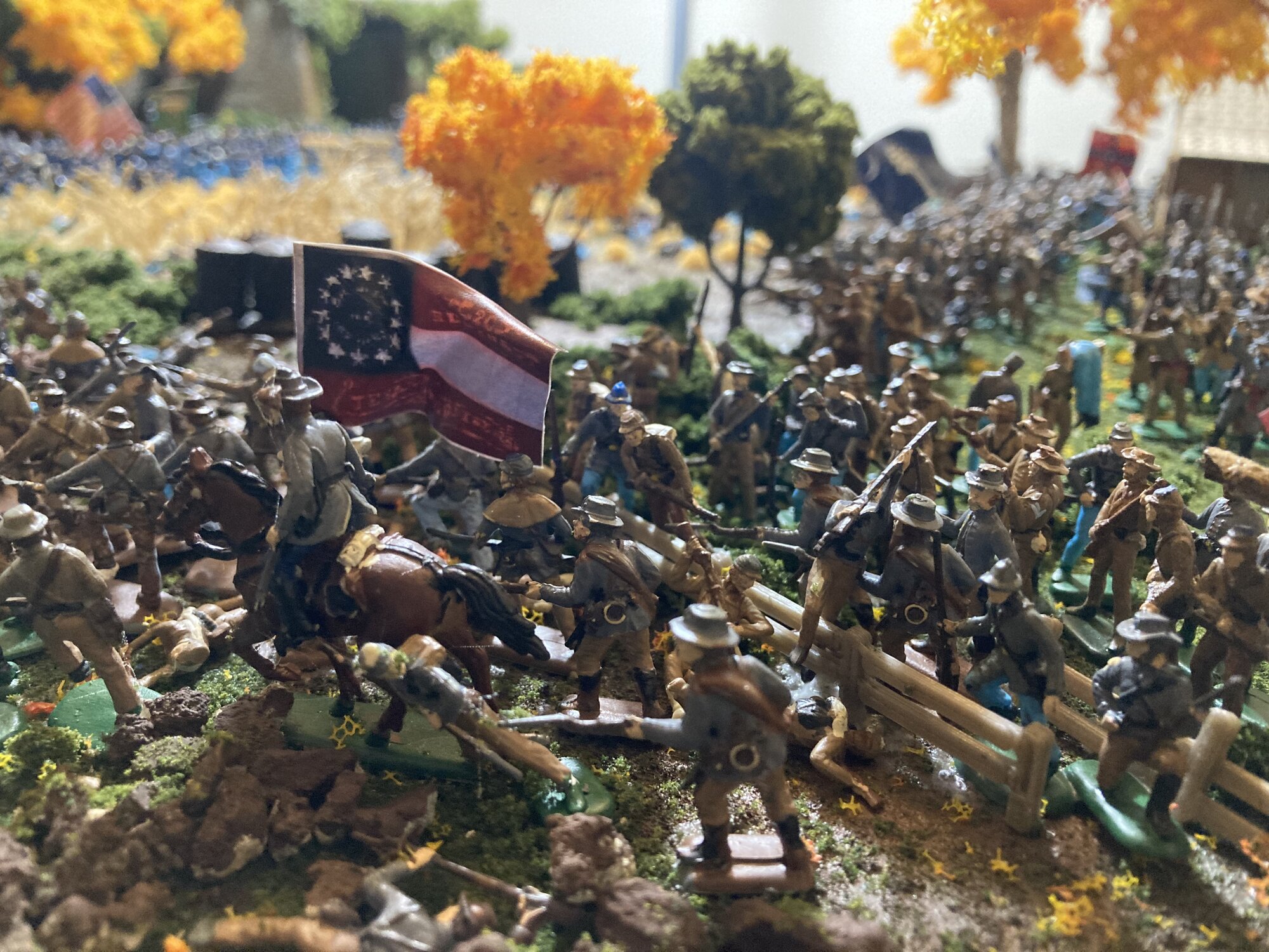

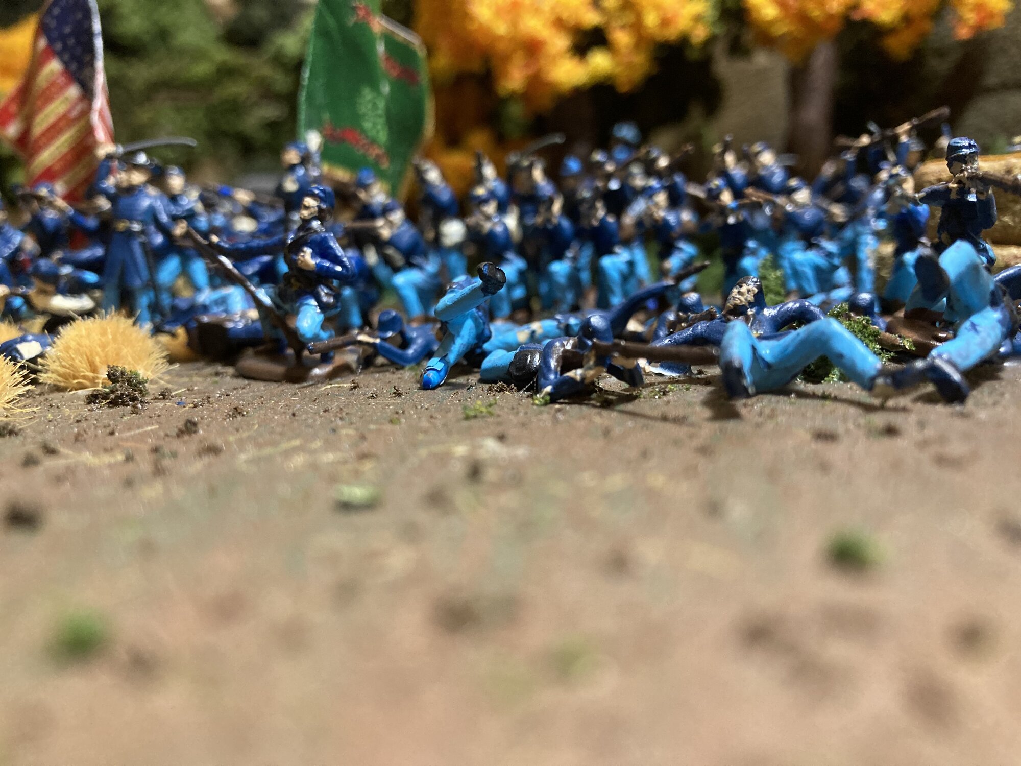

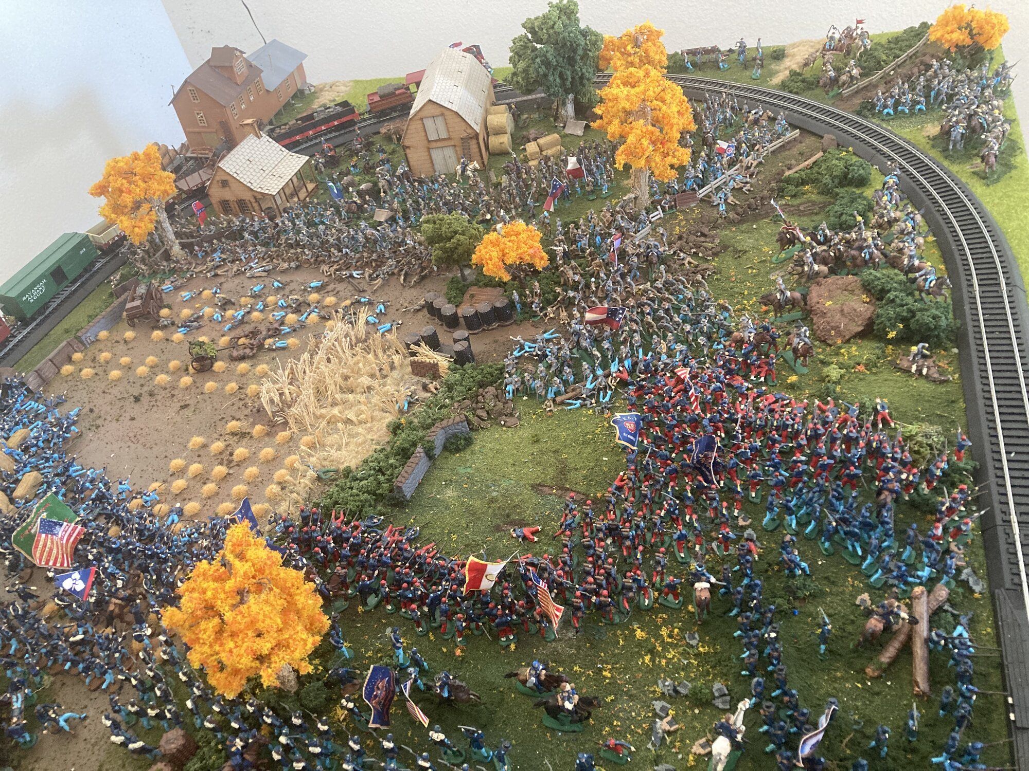

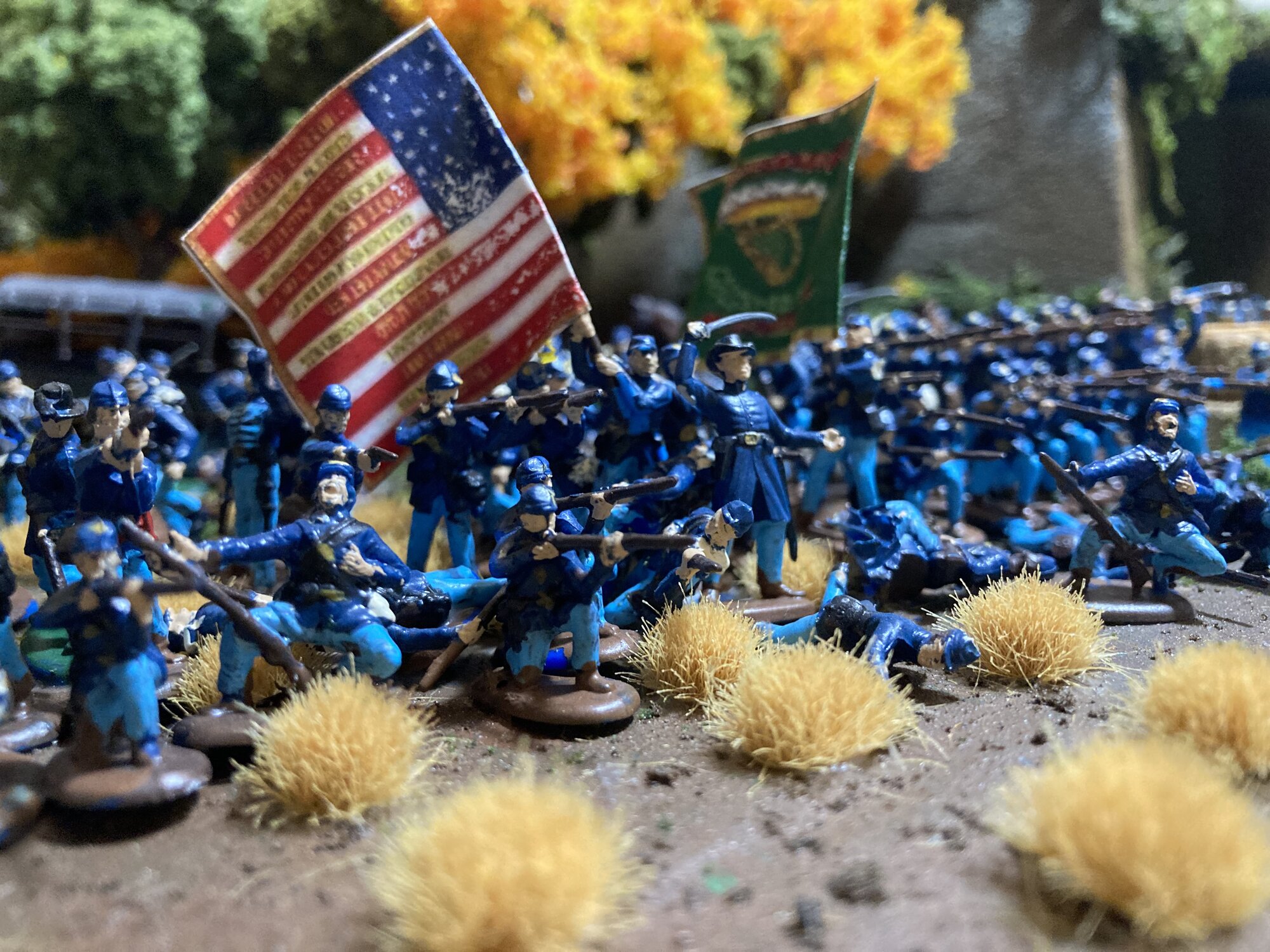

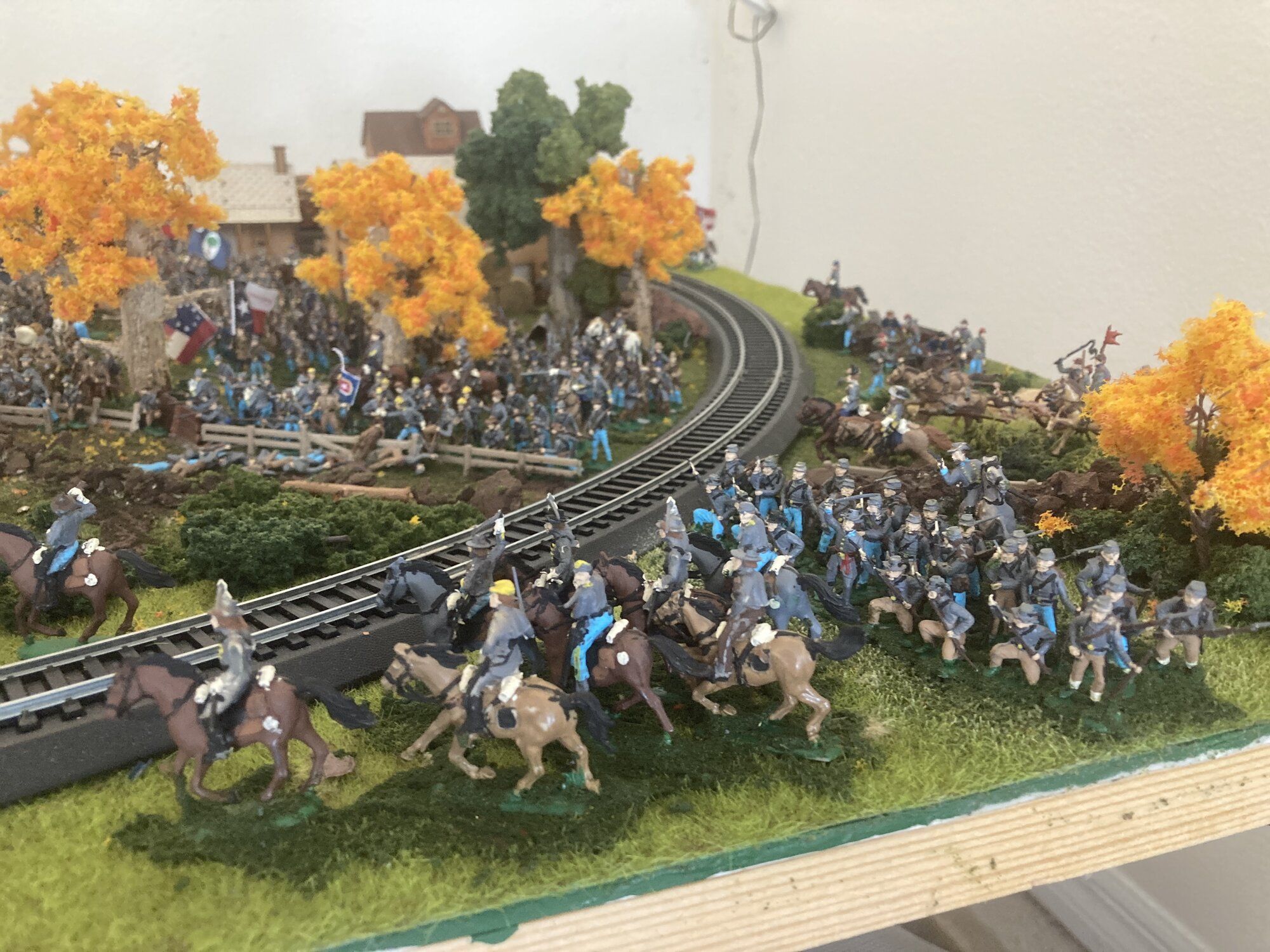

Hi folks! Would like some advice. I made a diorama/train layout of a fictional battle. I used a little over 1000 figures, but what is irking me is that I glued them all. I only painted the based instead of texturing them. I am going to attempt to attach photos, could I get some feedback/ideas! I am a beginner at this soo…Thanks so much!
Ideally you could remove the bases and pin the figures into the terrain. You would do that by drilling holes in the feet and inserting pins. The pins could be made out of cut paperclips. The other option would be to blend sculptamold or another material that you add paint to inorder to replicate the ground work. You then would take a spatula like artists use for oil paint to spread it over the bases. In either case it will take a lot of work. That is a very impressive diorama.

That's a fantastic diorama. I'd be tempted to leave it as it is, great work on the set pieces and layout.
Your work is pretty impressive. So much work has been involved in what you have done, that to remove those figures and re-base them would almost be like starting over.

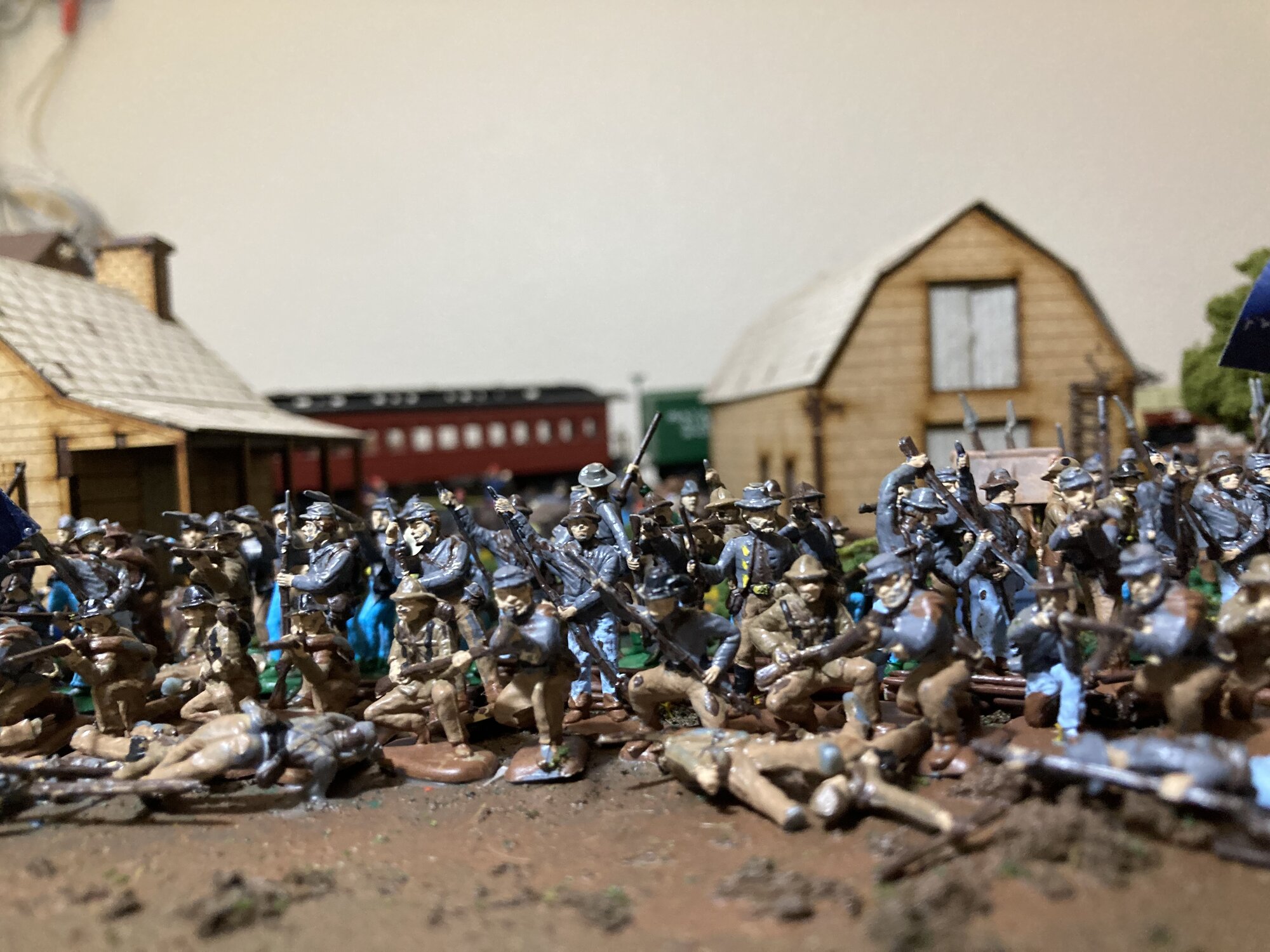

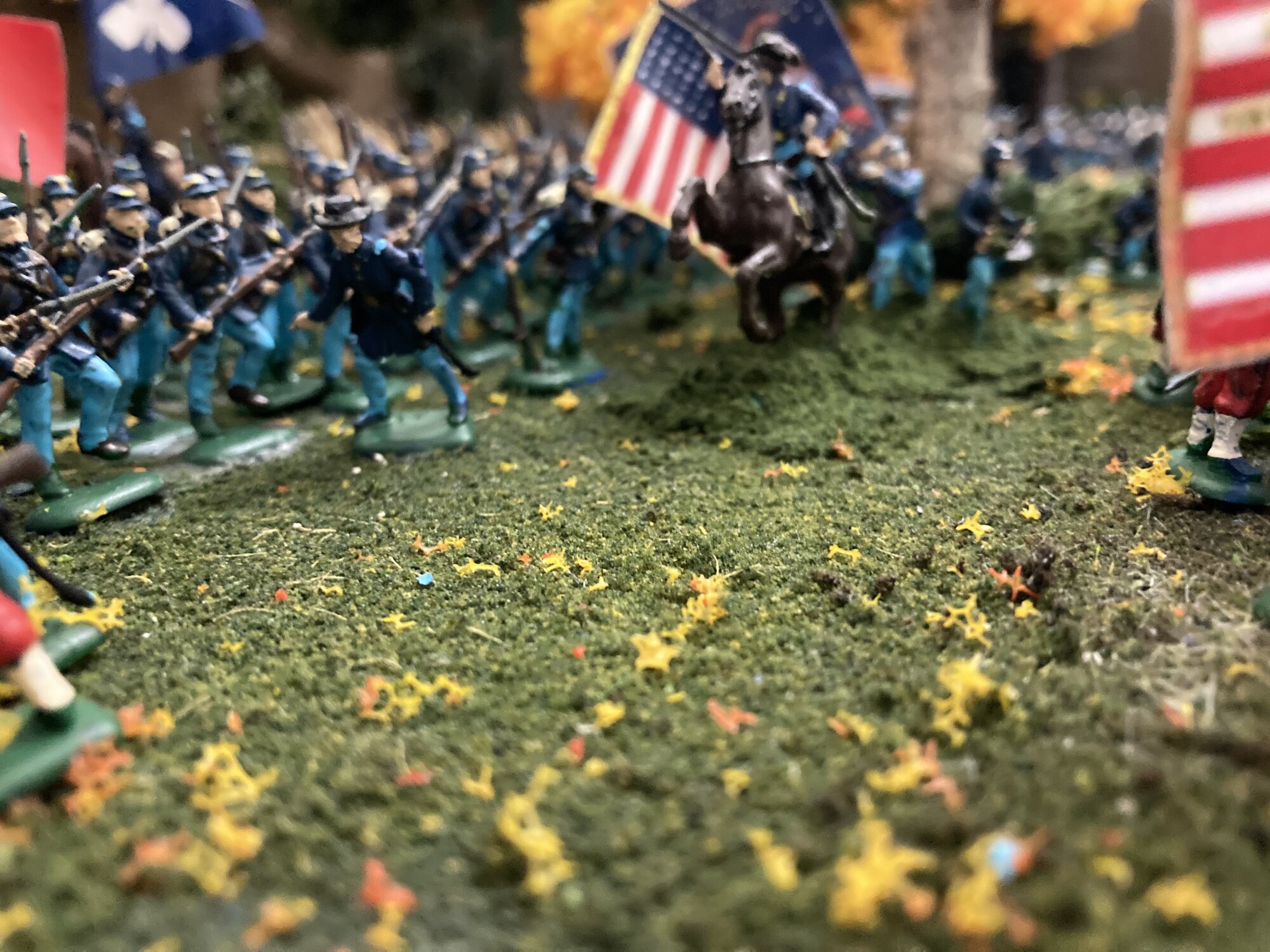

I'm not completely understanding your question; "I glued them all. I only painted the based instead of texturing them." The bases do look rather thick, and I imagine that you want to get rid of them or texturize over them. On second look, it looks like the bases are molded to the feet of the figures. Is that true? What is the terrain made of? How hard is it to poke or drill a hole in it?
Kurtlg gave two solutions about how to fix your diorama, but I would use his first suggestion if possible. That would be to remove the base and put pins in the figure's feet and glue them into the landscape, because this method doesn't require re-doing so much landscape work as in his second suggestion.
I would take one figure and try the following. If it works to your satisfaction, then problem solved.
I would use a Jewlers side cutters (found in the jewelry section of Walmart), to cut the base from around the feet of the figure, which when done will make the figure look like he has a huge sole on his shoes. You can use the side cutters to trim the size of the sole down to a more manageable size then using an "exacto" blade trim it down to where it looks decent in its thickness. From a hobby store, get some tiny drill bits (they should sell a package of very small drill bits in various sizes), and either a collet hand drill or ideally, use a cordless drill to drill holes perpendicular through the foot of the soldier. It would be better if you drill into the heal of the boot rather than the instep wherever possible so you can set your post deeper. Use a small sized paper clip to use as a post, cut to size, but you might be able to find some small finishing nails that you could use, although you might have to cut off the head of the nail, so it'll work better. Take the side cutters and do a little "crimping" on the entire shank of the paper clip or finishing nail to give the glue something to grab onto. I would use superglue (probably the "gap filling'' type) to glue to post into the figure, and you (hopefully) might find that you only have to use one post on most of the figures. Now you're ready to set the figure onto/into the terrain. Simply drill a hole into the terrain, put some glue on the crimped portion of the post extending from the figure and insert that into the hole. You might want to try different glues to see what works best and experiment with how long that post has to be that gets inserted into the terrain in order to see what length of post works best to hold the figure in place.
I'd try something like this first, as you wouldn't have to re-do any terrain features or it would minimize what you do have to correct. Every hobbyist should have some Jewlers side cutters, and everything else I've mentioned, so we're not talking about much cost. The biggest expense will be your time. You said you have around 1000 figures in your diorama, so now you'll have something to do for the rest of the year! (I'm a glass half full type of guy).

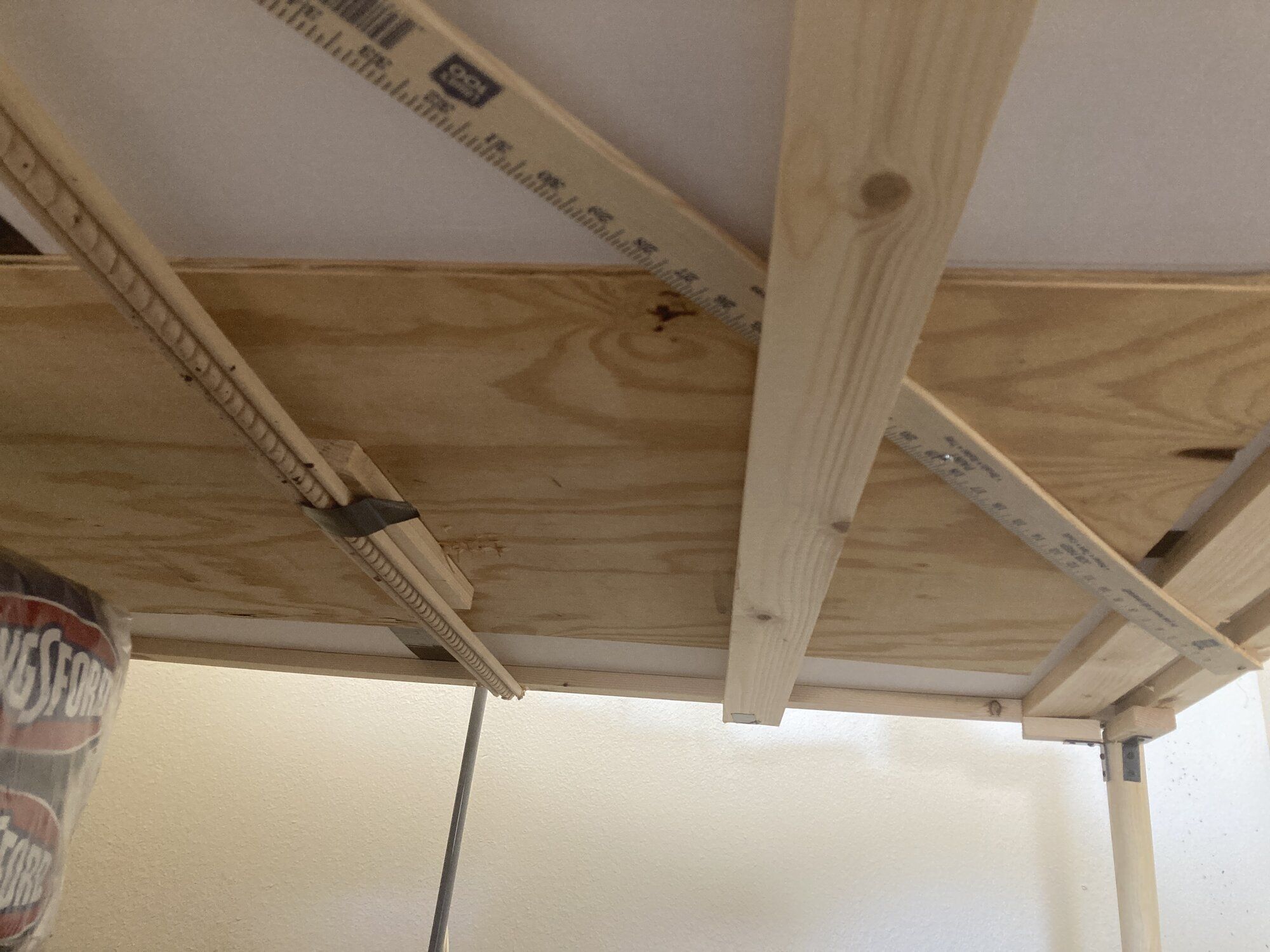

So, the groundwork is laid over foam board. Is there anything under the foam board to help support it, like a piece of plywood?
Counting the ground features and foam board, how thick would you estimate it all is? The bases of the figures are pretty thick, if you cut a hole in the terrain and placed the base of the figure into the hole and glued it down, then you'd have to do a little filling in of terrain over the base and around the legs.
I was just looking at one of your pictures that contains a horse. It'll be pretty hard to pin a horse down to the base so I was wondering if you could cut the groundwork out from the area where you want to place the horse (current base included).
If there was a strong backer under the foam board, like a piece of plywood, you place the horse where you want, and with your Exacto knife cut the terrain out as if you were tracing a line around the base. You take the terrain out and place the base of the horse into the whole you created and then do your terrain making magic in covering the base.
Now you have two choices on how to proceed. I'd think about the work involved in each case and go from there. No matter which you choose, I'd want something under that foam board to give it some strength and protection.
As I think about your situation, there is a third choice. You can re-do your terrain.

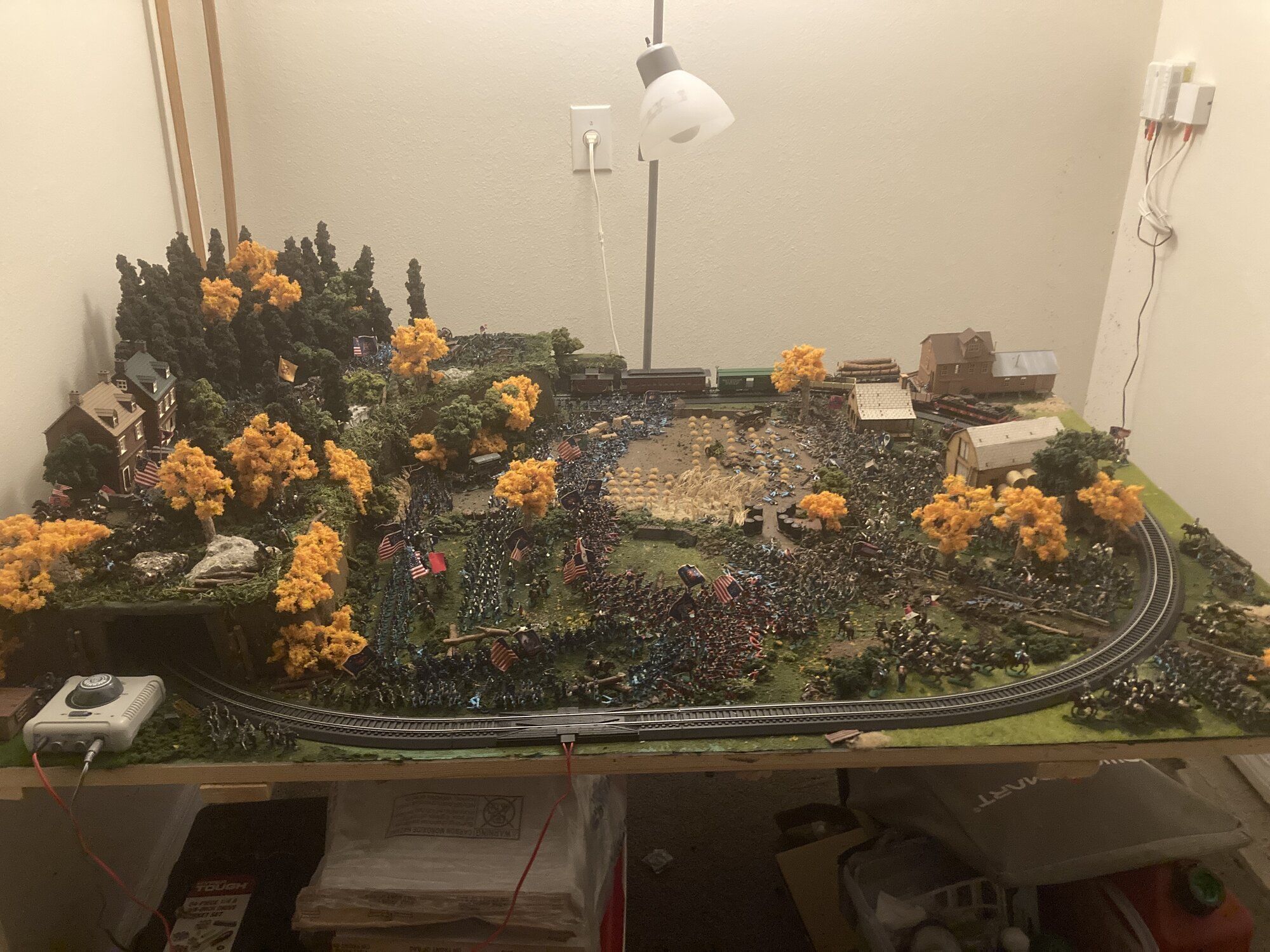

We might be able to come up with some other ideas, but it would help if you were to tell us how you made everything, and perhaps a picture of the whole diorama? Just how big is the whole thing?
Sure…here are some pics. Also there are some cavalry where you can see where i attempted something like what Kurtlg suggested with not so great results. The whole thing is 5x4 with foam board over 1/4 in plywood, glued together. The mountain ridge is all foam with wood stilt support below.
