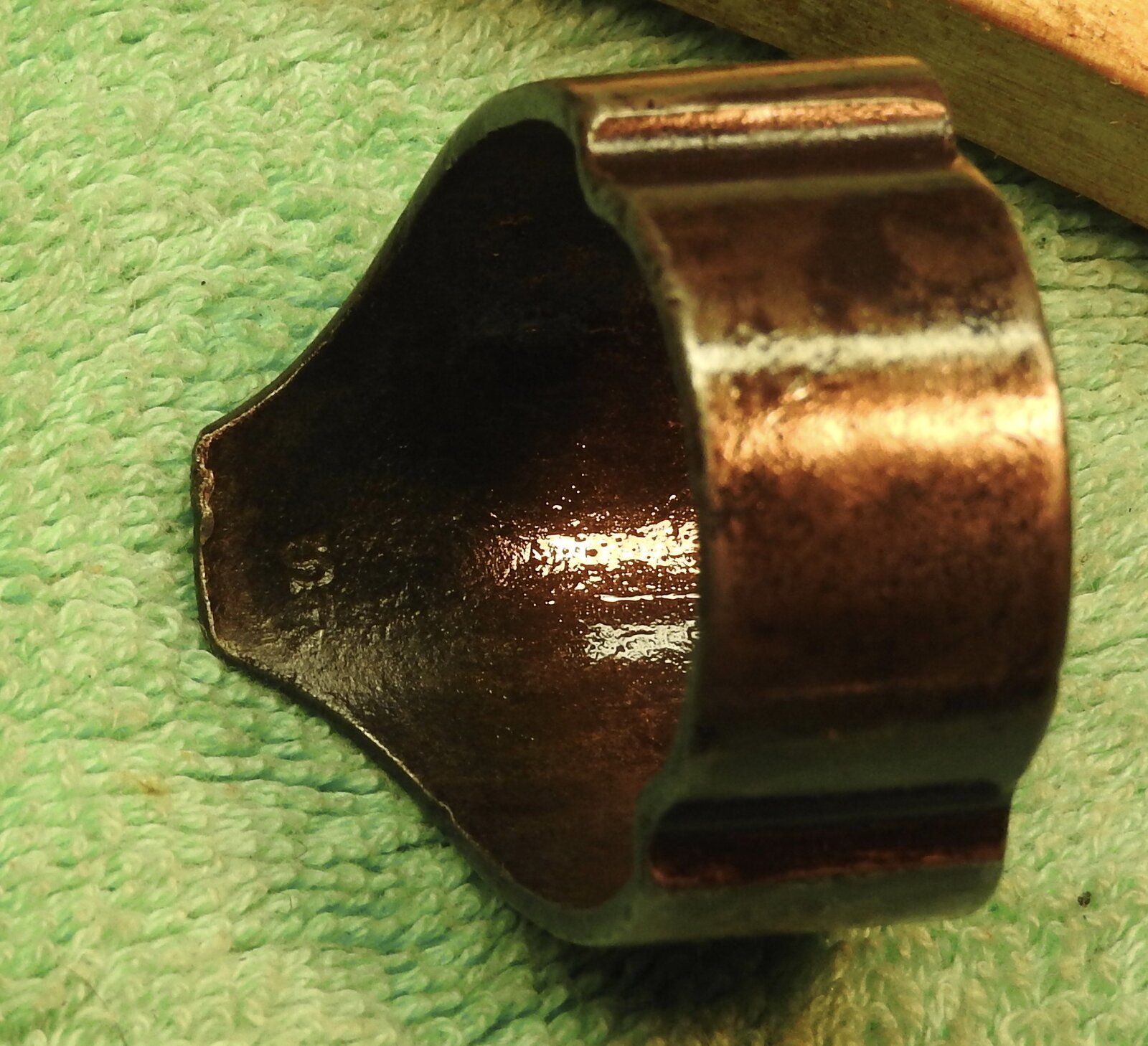

I'm having some difficulties in trying to pin this musket down. I think it's one of the many variations of U.S. contract muskets.
Am I correct in understanding that the underside bayonet lug is from one of the earlier muskets? And, if so, the only "H. Groot" I've been able to find is from the mid-1850's. Any help is appreciated.
This musket is not a US contract musket. It was made up for private sale with some surplus components. Based on the position of the rear sling swivel the gun would not have been made prior to 1828. Given the standard US contract barrel proofs it is likely that the gun was assembled with a barrel from a surplus musket from one of the many unserviceable muskets sold off as surplus in the late 1840s and 1850s.
As I noted in the first post with this musket, the front barrel band appears to be from a M1840 or M1842 Musket. The sideplate is from a M1816/22/28 type musket. The barrel may be from a M1816/22/18 with the bayonet lug relocated or it could be a M1840 barrel. Measure the muzzle's diameter and the length of the breech flats and we can confirm. The buttplate is not from a martial musket. The stock was also probably made or at least fitted by Groot as it doesn't match established M1822/28 patterns particularly in regards to the comb and wrist. The lock is a commercial English lock. It has had some work done to it including replacing the cock, a new frizzen spring, and a replaced mainspring. Those repairs are were probably not done when the gun was built by Groot.
