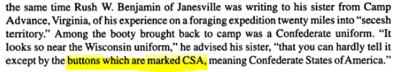

Excerpts from the reminiscences of two soldiers in the 33rd Alabama Infantry, note;

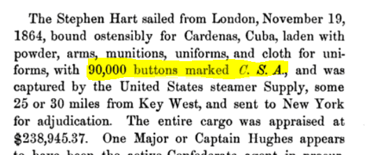

90,000 stamped "CSA" uniform buttons coming in on one British blockade runner ?
Wow !
( and that shipment was even intercepted )
I wonder how many more London buttons successfully passed through the Union blockade ?
Wow !
