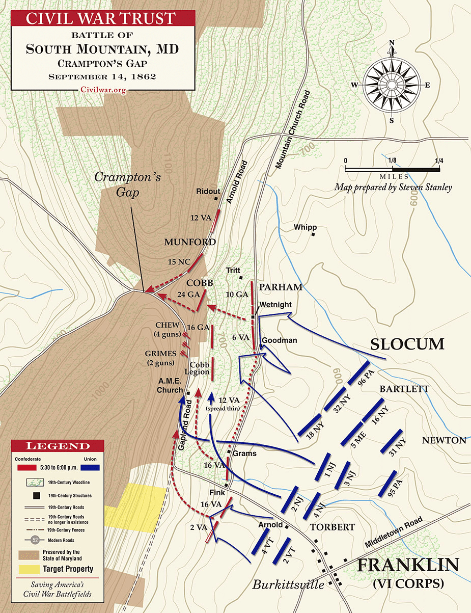

In the map below, look for SLOCUM's division and the arrow marked "3 p.m.". I believe that is the movement being described in the OR I quoted above.
[Image by Gene Thorp from Ezra Carman Vol. 1 - South Mountain, edited by Tom Clemens.]
