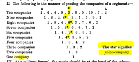

Suffice to say, the fifth company (from the right) is the color company of a given regiment, and in all cases was to be the right of center company.
In reviewing through the pre-war regulations/tactics, I see that from 1825 before a battalion/regiment was paraded and prepared for maneuvering by the tactics, the adjutant informed the company commanders how many files to form, with the excess men being sent to weaker companies so they can all be equal. There is also notice that the color-company was to form with three less files, so that with the color guard it would be equal to all the others. This latter was not specified in Scott's 1835 and Hardee's, etc., but I suspect it was understood to be the case since they note "equalized" companies.
Hardee also mentions, "In battalions with less than five companies present, there will be no color-guard, and no display of colors, except it may be at reviews."
From The United States Service Magazine, 3, (May, 1865), New York, gives the following diagram for assigning the color company in any sized battalion, from the full 10 companies of a regiment, to two companies; with the numbers representing their seniority of captains, as Hardee and Casey's tactics note, no color-guard with less than five companies.
