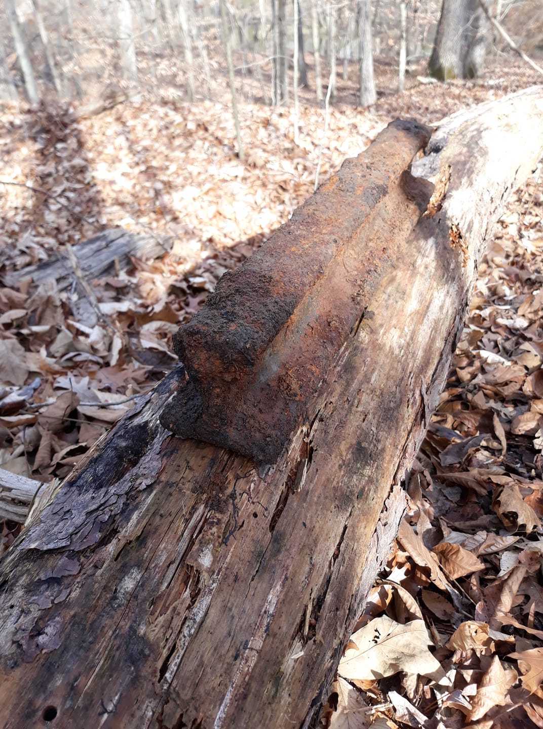

Hi all.
Found this today where an old line ran. There was a CW battle when the Union came to burn the trestle. The old line is no longer there but I've been hoping to find a piece of the old track. I assume this is from that era, but I know some of the older track is U channel not T like this. I realize it's hard to gauge the scale, but it's about 5 inches tall and quite a bit smaller than modern track. Is this probably CW era? Thanks for any insight.

Would help a lot to know where the line of track is located.
North of Greensboro, North Carolina.

The Piedmont Railroad was the CW railroad in that area. It was, unfortunately for RR sleuths, constructed by taking iron from about a dozen other railroads, with great variation is size and type of rail. There were several roads constructed in that area after the war, as well as logging roads that were laid down when needed, then moved to another area, al without records.
To have even a guess about its past, we need the best measurements you can get -- height, width of the bottom piece, width of the upper part, weight, length of what you weigh (yes, we will try to get to pounds per yard), whether it is iron or steel, and any words/numbers/letters on the side of the rail. Rails were connected to each other with fish plates (placed on the side of the bar, they were bolted to each of two bars to keep them from separating) and/or placed in chairs (iron pieces that sat under the rail, especially at connections with the next rail, spiked into a tie, and holding the rails like a hand with the rail going across the palm and the fingers wrapping around the lower part of the rail). Can you find any sign of either a fish plate or chair?
Certain identification is almost impossible, but we can give a try.

You say about 5 inches tall, but it still puts the length indeterminant. I thought most track was made at 10 and 12 foot sections, or maybe 10 and 15(???). If this appears as maybe 5 or 6 feet at best with smooth ends, would such a short piece be used as a final fitter?

Rails were mostly 18, 21 or 24 feet long, with a very small number of shorter pieces.
Thanks so much for the responses. I was hesitant to give out the exact location, but this place has been detected for many years, so I don't think it would hurt. It's actually Reedy Fork Creek. But I just checked and it is indeed the Piedmont Railroad that owned it.
The length of that piece is only roughly 2 feet. I'm not sure what the process is for tearing out old tracks, but I thought they may have cut up some before pulling it out. They wouldn't have cut a section this small though, so I don't know if there is a good explanation on why the section is so short. Like Lubliner said, maybe it was a filler piece before they started the bridge or something. 🤷‍♂️

I have the piece of rail home. Also found one of the plates that connects the rail to the ties. Give me some time to get cleaned up and some lunch and I'll post measurements and weight later this afternoon. How would i tell if it's iron v/s steel?

Here are the measurements and weight.
The piece is a hair over 22 inches long. The height is approximately 3 1/2". The width of the bottom of the track is also 3 1/2".
The weight is 30.4 pounds. So 1.38 pounds per inch. I don't know if that helps or not.
Here is a pic of it with the plate.
