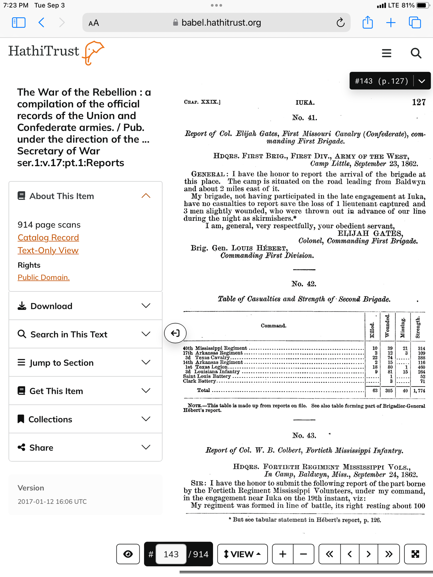

The 1st. brigade (Gates) did not participate in the battle and had no casualties. (see 'OR': Vol. XVII, Part 1, at page 127).
The 2nd. Brigade (Hebert) casualties return showed the additional count of 40 missing (see 'OR': Vol. XVII, Part 1, at page 127).

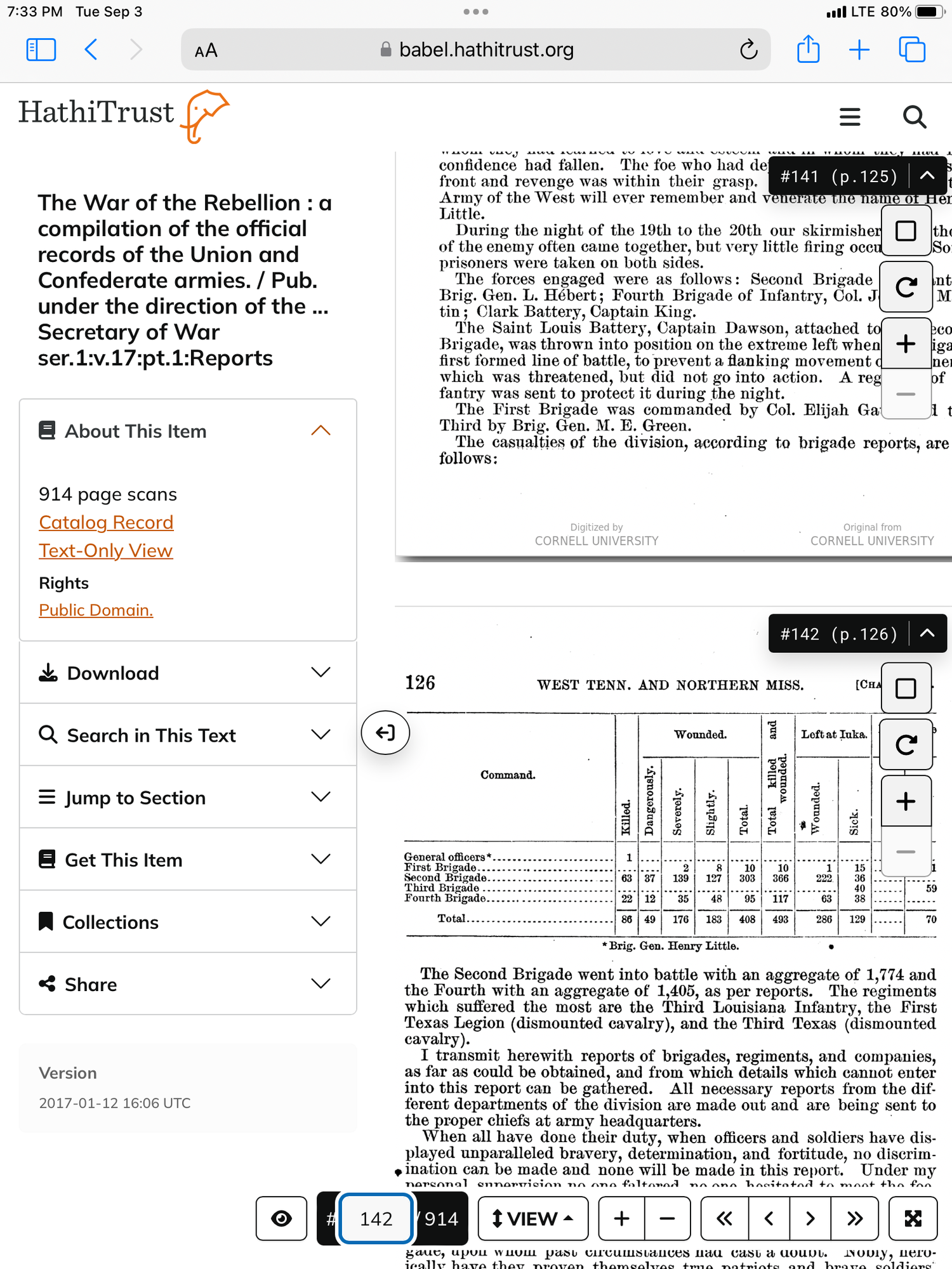

I agree wholeheartedly with Mr. @Nathan Stuart above, albeit with one tiny caveat regarding the official returns. The brigade level returns for Herbert's brigade (17 OR 1: 127) showed two additional wounded that the cumulative casualty return for the Division for killed and wounded (found at 17 OR 1: 126). This would be 305 men wounded in the brigade, as compared to 303.
Hi guys,

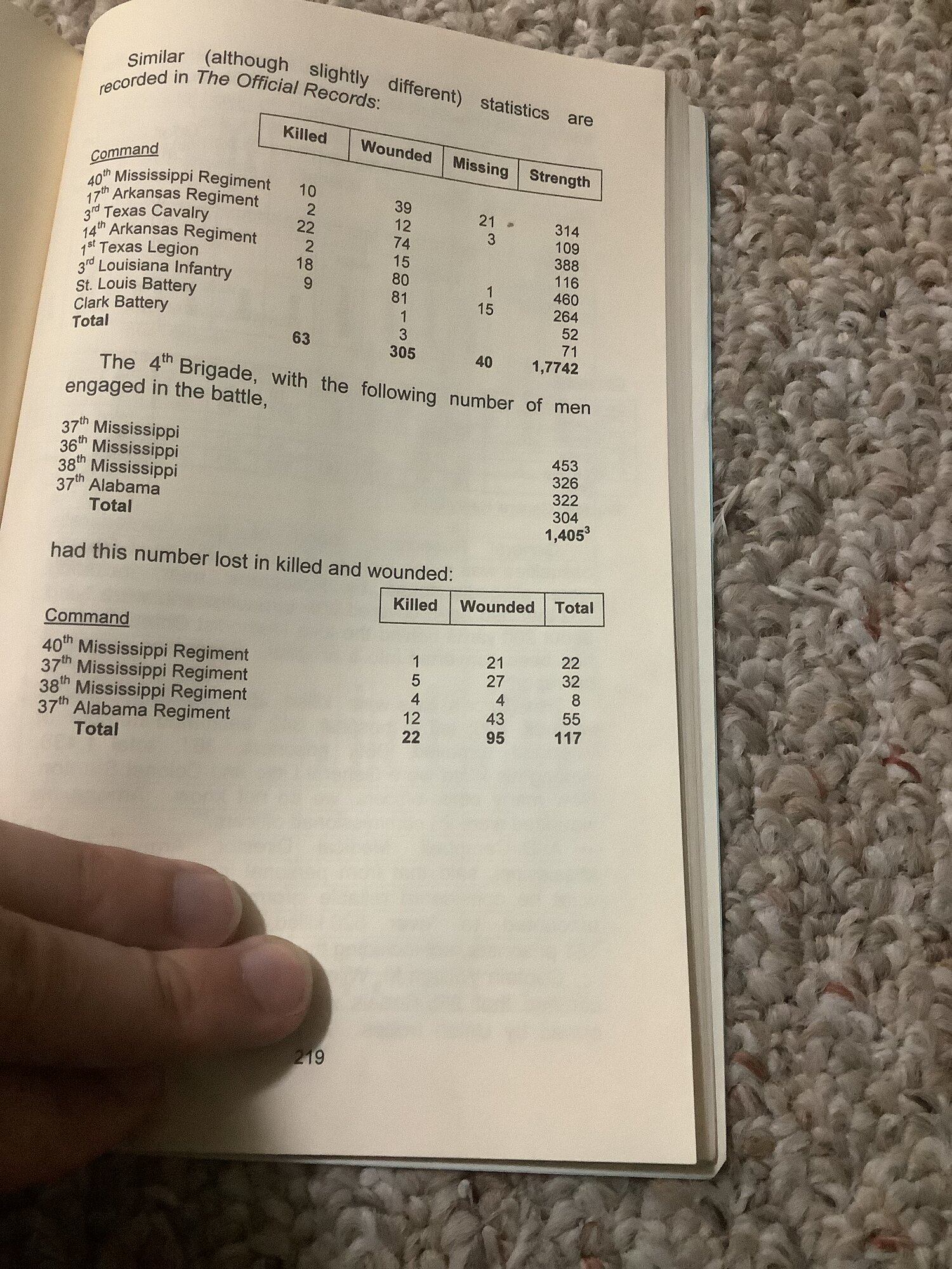

Which book do you have pictured here by chance?

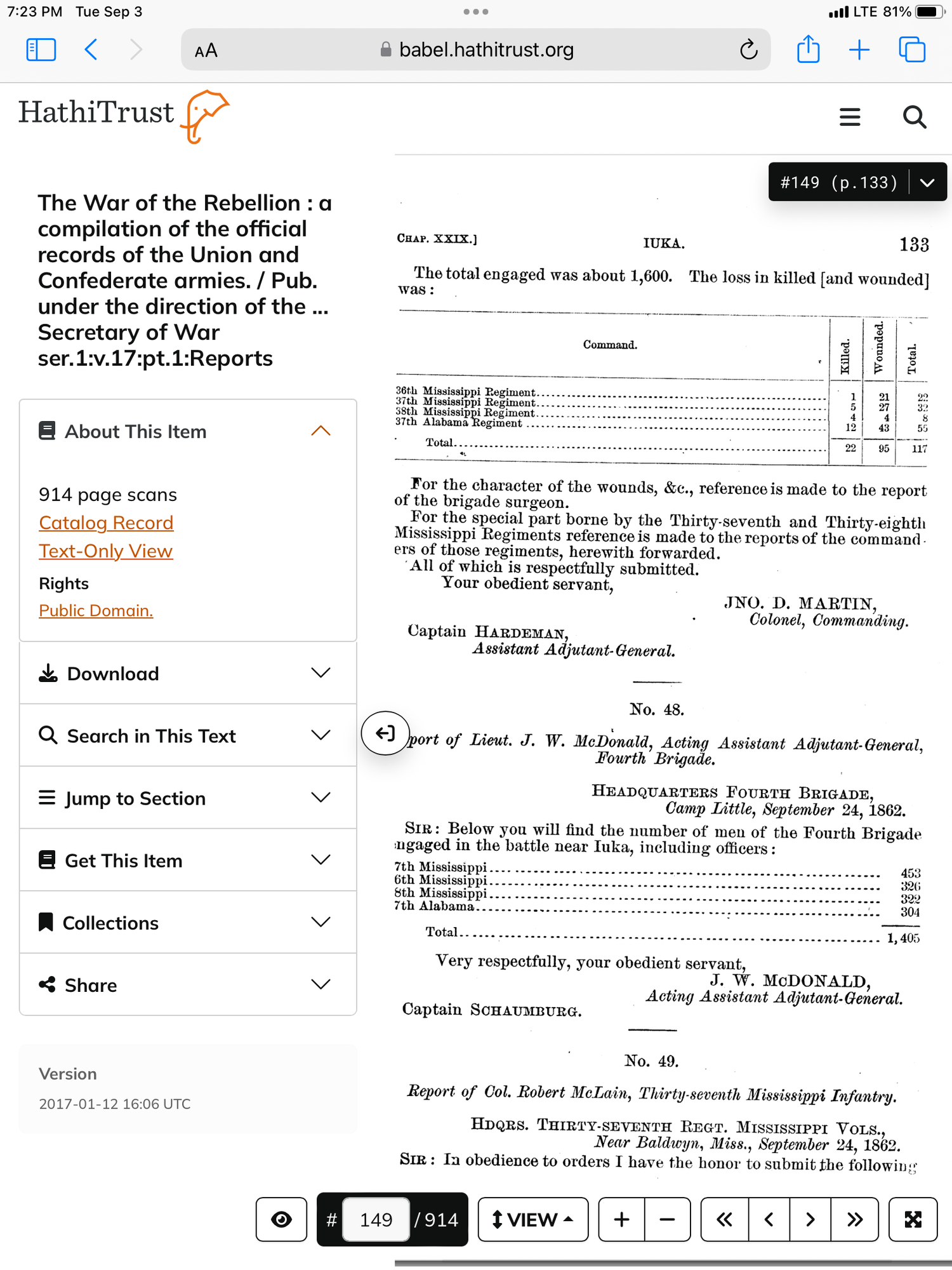

The losses for Hebert's brigade can be found at 17 OR 1: 127 and came to 63 men killed, 305 wounded and 40 missing/captured. The missing total was not reported in the previous returns on the preceding page and the final count of wounded was two persons higher in the final tally than in the preceding one. In John Martin's brigade the total can be found at 17 OR 1: 126 and is restated at 17 OR 1: 133. The brigade sustained 22 men killed and 95 men wounded for a total of 117 casualties in the brigade, per their reports. Peter Cozzens, in The Darkest Days of the War, accidentally took the total figure and thought that it represented missing/captured and hence double counted the casualties from the brigade. Along with Henry Little's death that results in a total of 526 reported Confederate casualties.

Kitchens-Iuka-1987.
I picked up Douglas Hale's book "The Third Texas Cavalry in the Civil War", and the numbers he gave match the photo of the open book posted above.
3rd Texas Cavalry Out of 338 men, they had 22 KIA and 74 WIA. That is approx 1 of every 4 men fell during the battle.
