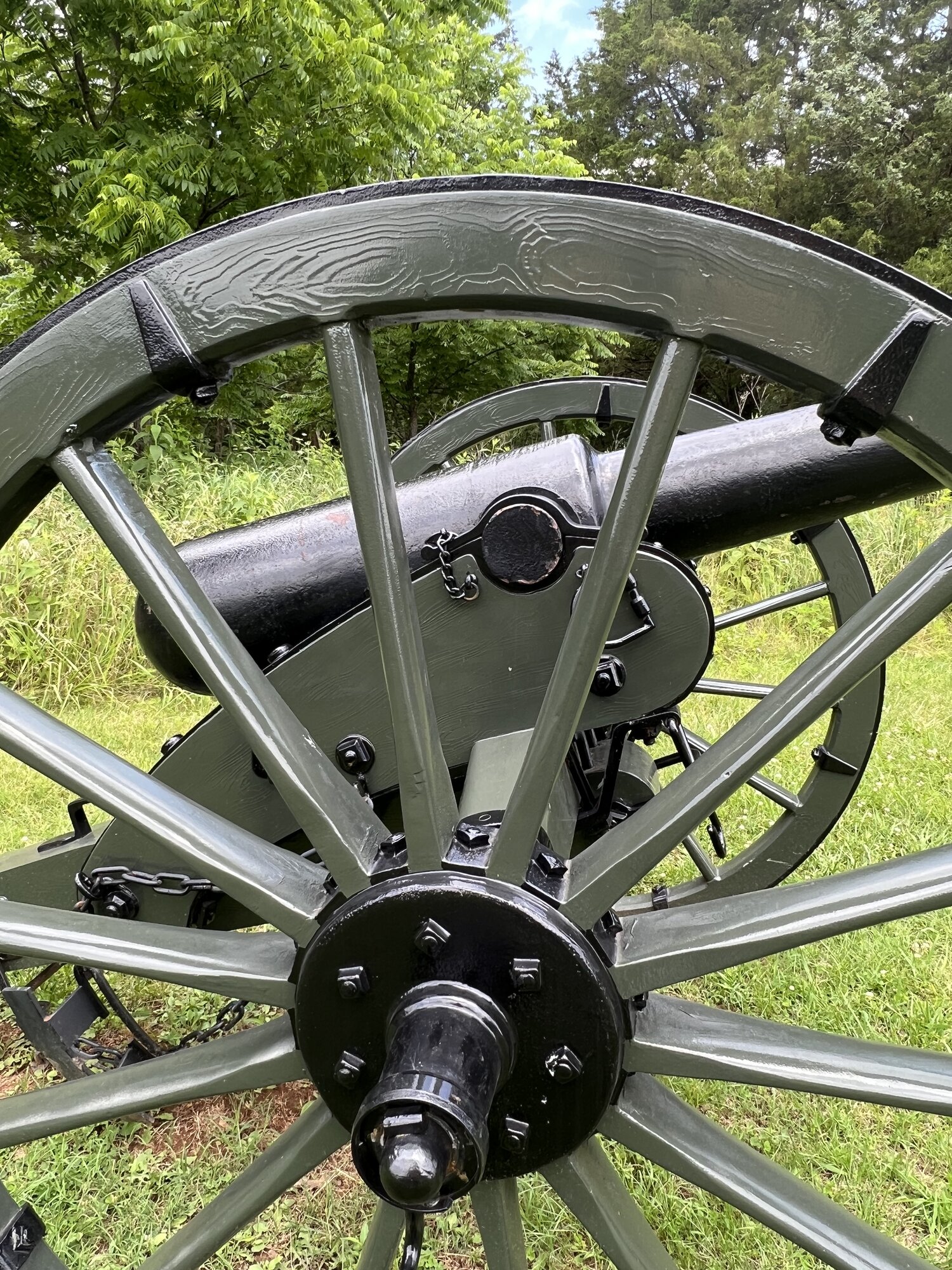

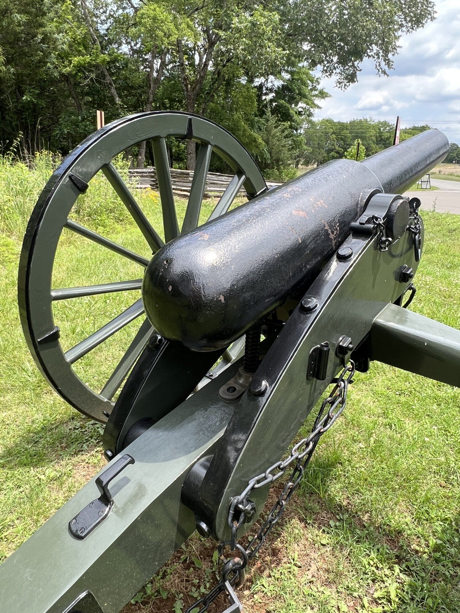

Suffice to say that some lessons were learned by the time Griffen developed his wrought iron process for what became the 3" Ordnance Rifle.
I had always wondered how they achieved that long graceful swell. Upsetting the billets makes perfect sense. I have done it myself many times, but on that scale it is an entirely different matter.
The wrought iron used to make the 3" rifles made the forge welding of the gun barrel possible.
