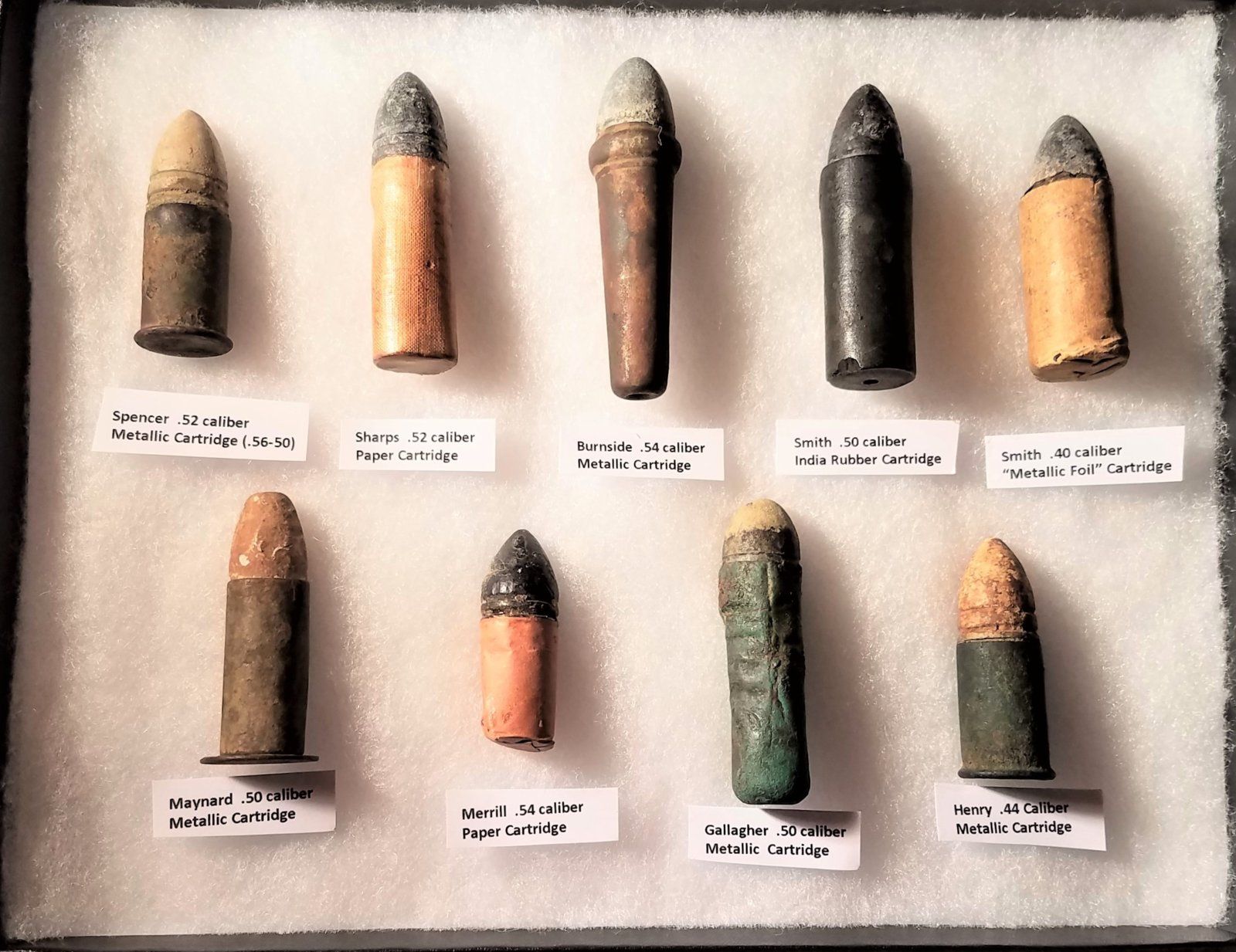

At the recent Franklin Civil War Show I picked up a couple of carbine cartridges. I decided to put what I bought in Franklin (a Sharps & an India Rubber Smith) together with some of my other cartridges in a Riker case, see photo.

The Sharps and the Smith carbine captions have been reversed... You'll have to correct that. Note the metal foil and .40 cal. vs. the paper.
Very cool carbine cartridge display! Thanks for sharing it and the presentation of it here.
I believe that the Sharps is labeled correctly, in fact, it appears that the cartridge has the correct linen in lieu of paper...….
Golly, yes, I think you are right. That is a linen Sharps cartridge... I guess the only thing that needs changing is the ".40 caliber" Smith? More like a .50 or larger maybe, yes? Thanks for catching my mistake. My apologies.
You are correct the .40 should be .50, it was a typo. All the Smith carbines were .50 caliber. Thanks for the catch!
