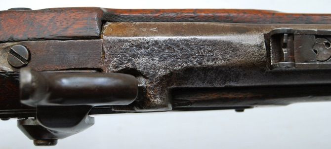

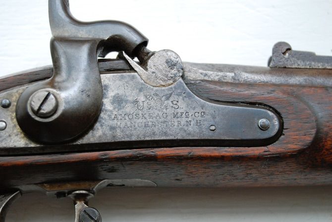

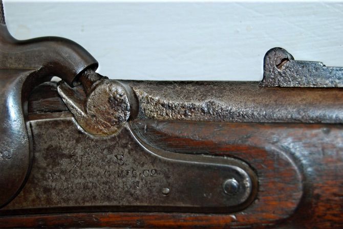

Here are a few pics of an Amoskeag US M1861 Special dated 1863. Several collectors have told me that is a likely Confederate battlefield pick up because of the heavy pitting around the nipple. They say is due to the very hot caps used by the Confederates. No way of knowing for sure, just interesting.
