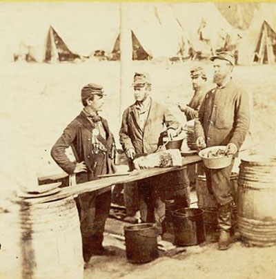

The attached photo shows a soldier on the right holding one of the Mess Pans. It was a sort of serving tray, and a company kitchen was authorized 15 of these to serve 45 soldiers. There also appears two examples of the Camp Kettle sitting under the improvised table. I'm looking for fairly close representations of both of these items to go along with the 5-gallon wooden barrel I'll be getting to replace the plastic water cooler.
Does anyone have a lead on a source for the kettles and pans? "Close enough" is also acceptable as we're hardcore mainstreamers.

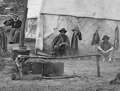

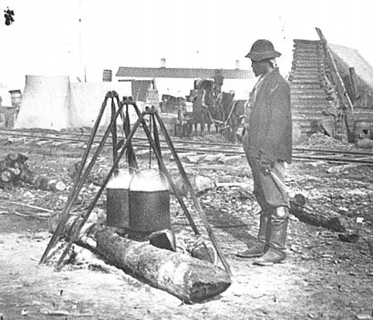

And this one has the 5gal kettles. Not sure if nesting kettles were actually available, as practically all the photos appear to show multiple ones of the same approximate 5gal size. I also saw a scan from a wartime manual that authorizes two 5gal kettles and five mess pans per 15 soldiers.
