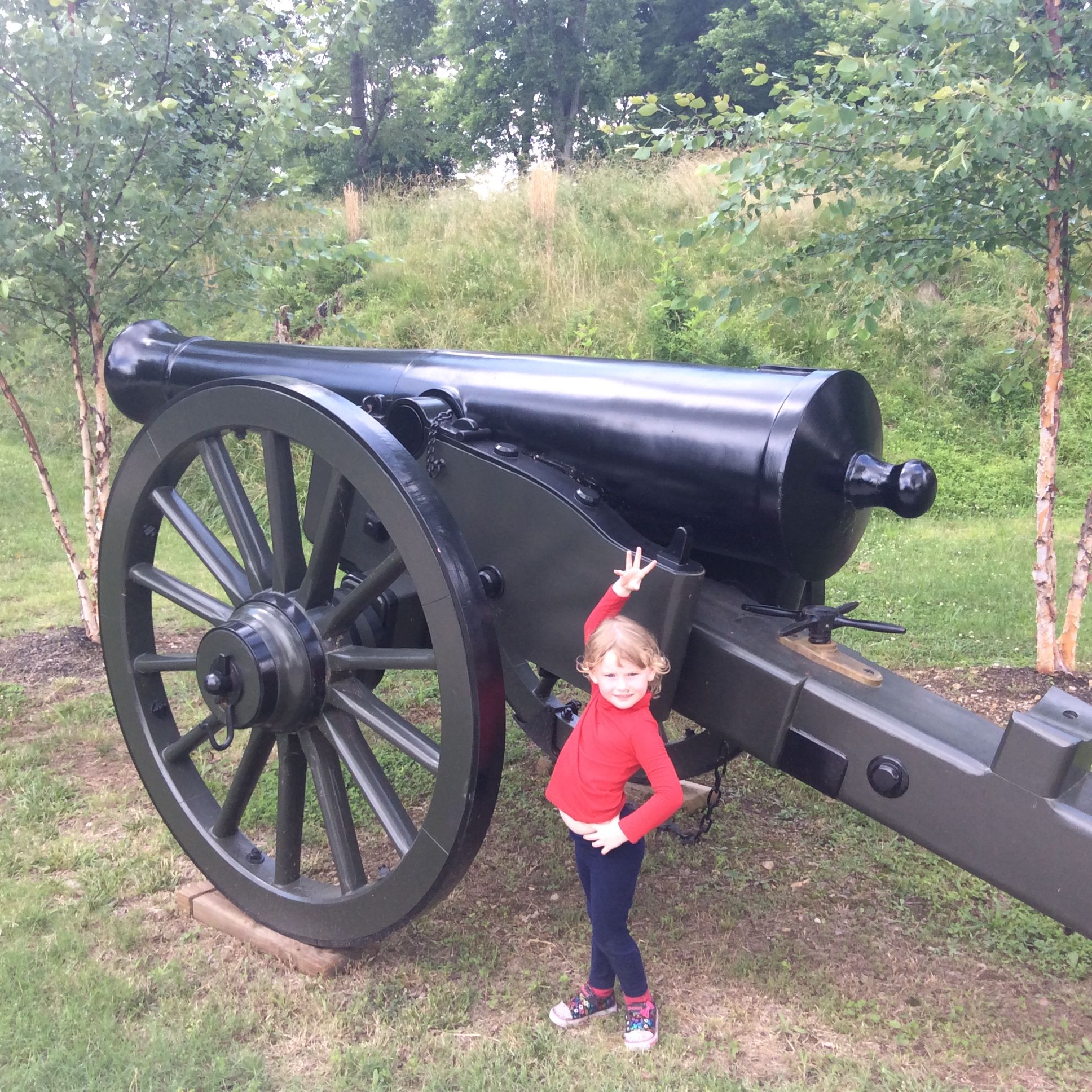

I recall reading in the Artillerists' Companion that the wheels were dished so that dirt, mud, etc. would be thrown to the outside but, more importantly, wheel dishes essentially make the carriage wider and more stable/stronger without having to lengthen the axletree.
From an engineering standpoint, I was inclined to think the dish in the wheels was to cause a stress bias in the spokes that would exist in the opposite direction as what would be imposed by side loading from going around a corner. (yawn) The effect would be a wheel that may not be quite as strong in a straight line, but more durable overall because it can handle more side loading. That said, I have no desire to find the data and run the numbers on these wheels anytime soon so there is a decent window that says I'm wrong. As an engineer once said, "In God we trust, everyone else better bring your numbers."
Gibbons ( page 181) in alludes to that, I think. "The wheels are made with a certain convexity called the dish. The obliquity of the spokes gives elasticity to the wheel and protects it from shocks which, were the spokes in the same plane, would destroy it."
So, that's a different dynamic than what I was describing, but the two kind of go along with each other. He's describing it as a spring, which helps in every direction. In his explanation, the dish could go either way, but facing them outward offers the advantage of stability when cornering. For something I never cared about, I'm getting way too interested .:bounce: Thanks

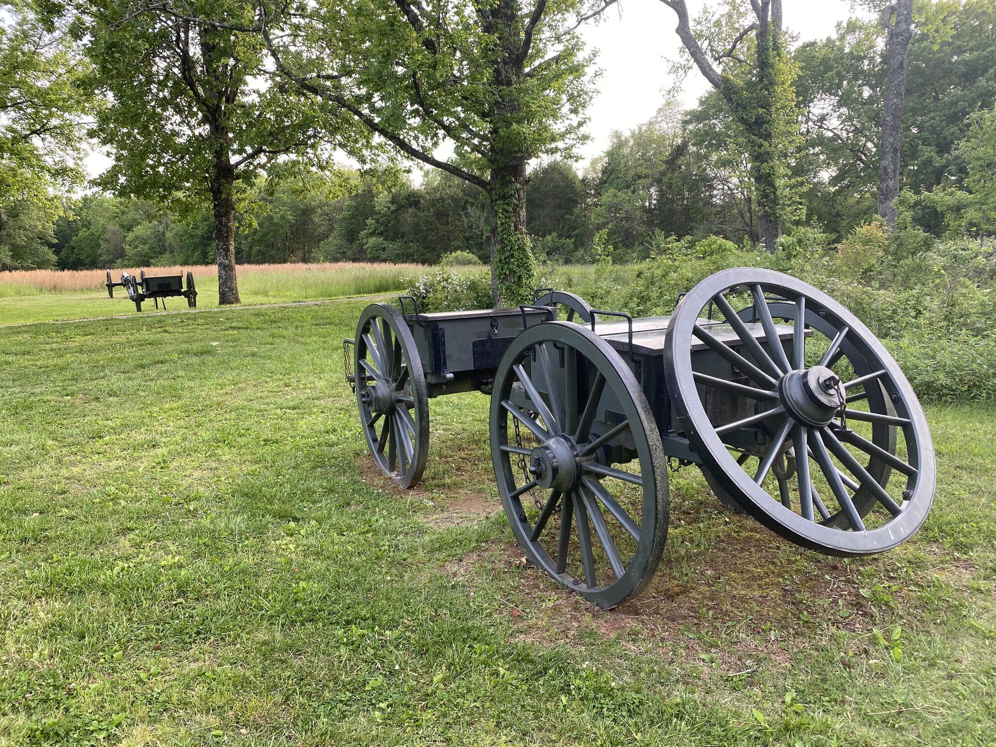

A battery's artificers could use spare parts to repair a wheel. However, the wheelwrights in the artillery reserve would have been the preferred method.
An artificer standing next to a battery wagon.
During a lull in the Battle of Stones River the Chicago Board of Trade Battery recovered a broken down cannon. The battery wagon carried spare parts for a carriage. During the night artificers of the CBTB repaired the captured gun. From that point onward, there were seven guns in the battery.

Wheels are conical so that the sides of a wagon or carriage can be wider.
According to the Worshipful Company of Wheelwrights, wheels are dished so that the sides of a wagon or carriage could be wider. By angling the axil it made the wheel more secure.

And more fun with numbers - from the AWI. I'd have to check my books but IIRC at least two of the carriages for the RA 3 lb gun were 10 spokes. The standard carriage for the RA light 6 lb gun was 12 spokes. For the US it should be kept in mind that it was a ways into the 19th century before the US began adopting a true system.
Well, even in those old days, balance would have been important. And I don't mean balanced as in an artistic view point but literally balance as in weight and center of mass. They didn't run at 60mph like our cars, which have balanced wheels. The other reason is stress. If you have gaps between some spokes then that rim will have to carry more load than the other parts of the wheel.
The strangest thing is how the spokes are not perpendicular to the wheel axle but they lean out. They form almost a cone. However, the spoke that is supporting the wheel is vertical to the ground.
From "Field Artillery Weapons of the Civil War":
"Wheels were made with a convexity or "dish" which gave them elasticity and protected them from shock. The "dish" also served to make the carriage wider with decreased length of the axletree"
I have also heard ( but don't have a documented source ) that the dish in the wheels would help in preventing mud from caking on the wheels.

As an engineer, I think it had something to do with reducing loads on the spokes or something.
I need to get my NASTRAN software out and build a 3-D stress model of the carriage. :nerd:
In the 1980s, one of the curators at the Ft. Sill museum told me that the load was the reason for dished wheels. A single spoke could not bear the weight of a barrel and carriage, particularly while turning.
