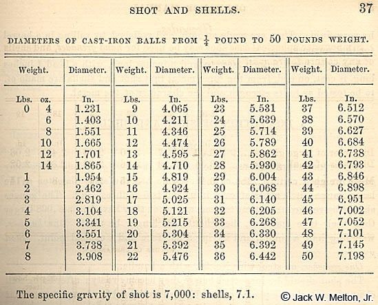

If im not mistaken, there is a 3.908 8lb right on the list.View attachment 101752
That chart is out of the 1862 Ordnance Manual but I think it's just a chart that says IF you had a ball of a given weight it would have a diameter of X. That manual doesn't mention an actual piece using shot or shell of that weight and diameter and I've never seen a reference to a an 8 pounder smooth-bore field gun although there was a 9 pounder used in the Revolution I believe. There were 6 and 12 pounders before and during the war but no 8 pounder smoothbores that I've ever seen referenced.
There's also the issue with the indentation: I still don't think that's a fuse hole.
So I'm still gonna say it's not a cannon ball and certainly isn't one from the Civil War.
