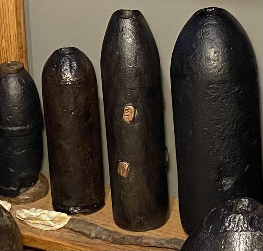

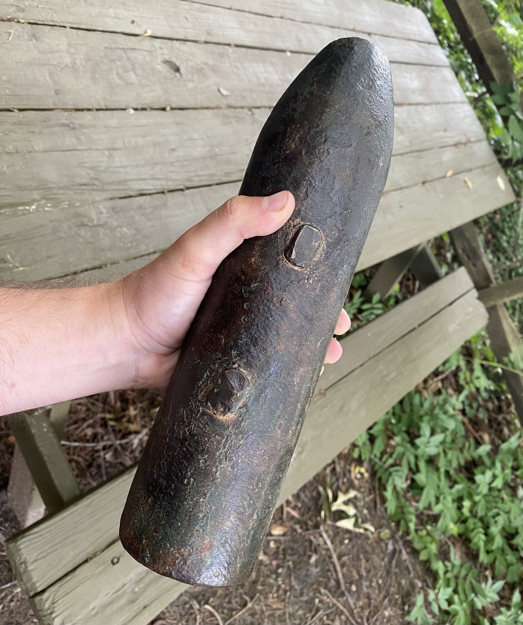

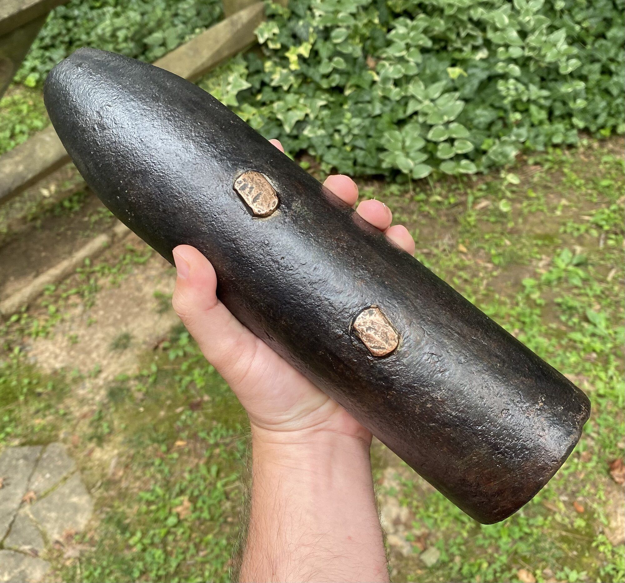

After being thoroughly satisfied with the results in cleaning up my wax-covered 6.5" Harding a week ago, I decided to give another rare bird of mine covered in wax the same treatment.
I sanded off the old-yellowed wax on the Armstrong and slapped on a coat of Gempler's (inside and out) and also used a mixture of vinegar and peroxide to spiff up the copper rifle studs which were a bit oxidized in places.
Overall the shell was in pretty good condition so it didn't really need much treatment for rust but overall, I think it looks a lot better and is a little more uniform in the patina of its shelf-mates
View attachment 510460I sanded off the old-yellowed wax on the Armstrong and slapped on a coat of Gempler's (inside and out) and also used a mixture of vinegar and peroxide to spiff up the copper rifle studs which were a bit oxidized in places.

Good job. Do you ever use 0000 wool to clean off rust?
Thanks! I usually use a wire brush and rough grit sandpaper for really bad rust and concretion to smooth out the finish for the Gempler's and a very fine sandpaper and vinegar-peroxide for the copper or brass
