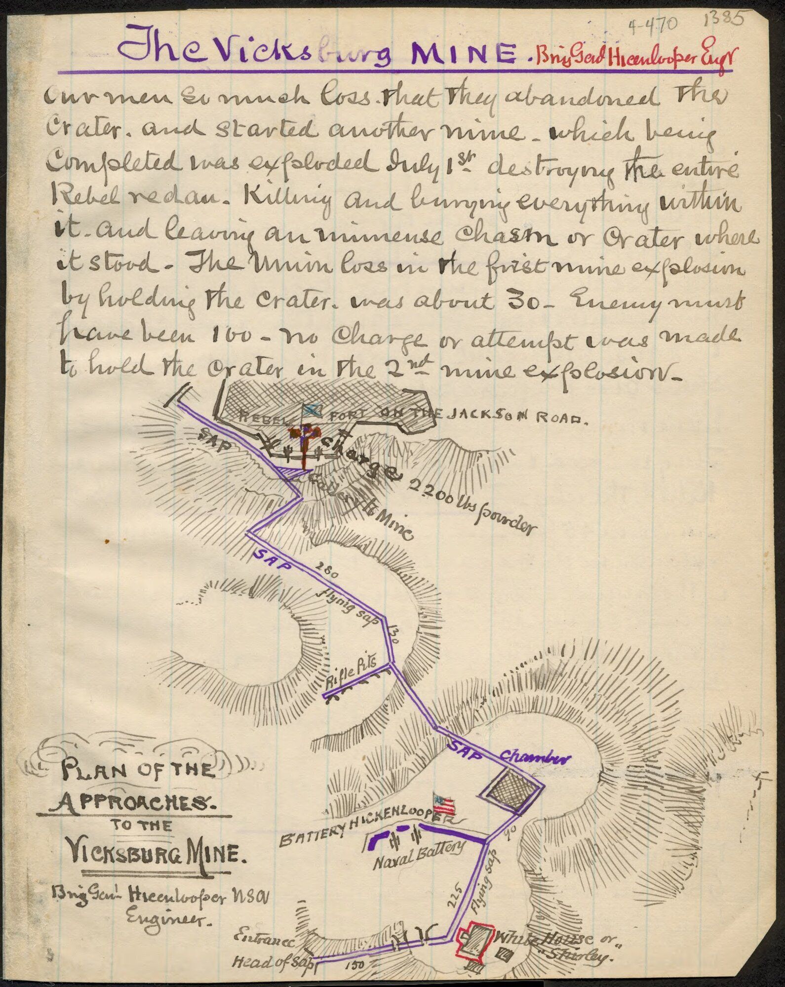

The "pioneers" of the corps were at once sent to the cane-brakes, swamps, and lowlands in the rear to construct sap-rollers, gabions, and fascines, and details of 150 men for day and the same number for night duty were made for work on the main sap, which was commenced on the Jackson road at a point about 150 feet south-east of a large frame plantation house, known as the White House, which for some unexplained reason had been left standing by the enemy. Up to this point troops could be marched in comparative safety under cover of the intervening hills, supplemented by the construction of parapets at exposed points.
The line of the first section was selected during the night of the 23d under cover of an attack made upon the enemy's pickets. Upon this line the workmen were placed at intervals of about five feet, each equipped with a gabion, pick, and shovel, with instructions to cover themselves securely and dig a connection through to the adjoining burrow before daylight. The day relief was engaged in deepening and widening the sap thus commenced, and on the following night the second section was laid out and occupied in the same manner.

The general plan of conducting the work with flying-sap by night and deepening and widening by day was pushed forward with the utmost energy until June 22d, when the head of the sap reached the outer ditch surrounding the fort. A few days previous an order had been issued for all men in the corps having a practical knowledge of coal-mining to report to the chief engineer. Out of those reporting thirty six of the strongest and most experienced were selected and divided into two shifts for day and night duty, and each shift was divided into three reliefs. On the night of the 22d these men, properly equipped with drills, short-handled picks, shovels, etc., under the immediate command of Lieutenant Russell of the 7th Missouri and Sergeant Morris of the 32d Ohio commenced the , mining operations by driving a gallery, four feet in width by five feet in height, in at right angles to the face of the parapet of the fort. Each relief worked an hour at a time, two picking, two shoveling, and two handing back the grain sacks filled with earth, which were deposited in the ditch until they could be carried back. The main gallery was carried in 45 feet, and then a smaller gallery extended in on the same line 15 feet, while from the end of the main gallery two others were run out on either side at angles of 45 degrees for a distance of 15 feet. The soil through which this gallery was driven was a reddish clay of remarkable tenacity, easily cut and requiring but little bracing. So rapidly was this work executed that on the morning of the 25th the miners commenced depositing the powder, 800 pounds at the extreme end of the main gallery and 700 pounds at the end of each of the lateral galleries, making a total of 2200 pounds. From each of these deposits there were laid two strands of safety fuse,- obtained, as was the powder, from the navy,-this duplication being made to cover the possible contingency of one failing to burn with the desired regularity and speed. These six strands were cut to exactly the same length, and having been carefully laid, the earth, which had been previously removed in grain-sacks, was carried back and deposited in the most compact manner possible, and well braced by heavy timbers, beyond the junction point of the three galleries. From this point out to the entrance it was more loosely packed in.

The powder was brought up in barrels and kept in the main sap at a safe distance from the enemy's hand-grenades and shells, and there opened and placed in grain-sacks, each one of which contained about 25 pounds. These were taken up on the backs of the miners, who made the run over the exposed ground during the intervals between the explosion of the enemy's shells ; and so well timed were these movements that, although it required nearly one hundred trips with the dangerous loads, all were landed in the mine without a single accident.

The crater being secured, again the miners were set at work running a new gallery under the left wing of the fort. This mine was exploded on the 1st of July, leaving the fort a total wreck.
