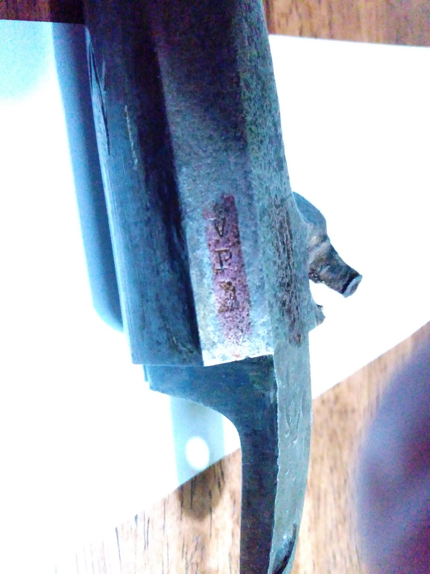

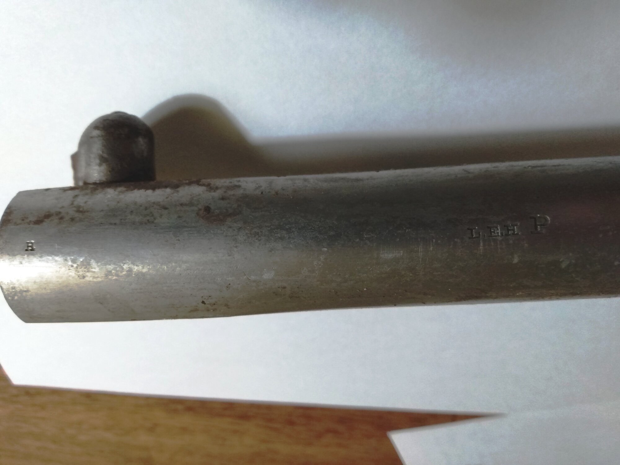

I typically collect Helmets from WW1 and WW2, but as a opportunist collector, found what I think is a M1861 Springfield with a 1862 lock plate for a considerable good price. It being Winter in Massachusetts, one tends to amuse themselves with, lets take it part and really look at it.
Barrel has no date that is visible due to considerable pitting. The V P and Eagle is faint but eagle looks to be associated to Springfield. Under side of Barrell is marked with initials of L.E.H. P. I can find no reference to these.
Lock is dtd 1862 U.S. Springfield, but eagle is not present again due to pitting.
The stock has two cartouches, one horizontal the other vertical towards the rear. The horizontal one has a three letter code, with what looks like to be a A(3rd ltr,). Not sure if this is for Erskine S. Allin, as the ones I've seen the outside edge is oval vice rectangular.
Other oddity is the lower Bridle screw has been replaced with a copper rivet. Anyone ever seen this before?
Any thoughts or opinions on who is the proofer L.E.H.?

Any one have photos of Stock Cartouche's. Found past post showing the various VP Eagle Proofs. Was wondering if anyone has done the same for the stock proof initials.
Here you go. There are several different inspectors. I believe the Springfield CW musket book has them all listed.
Thanks, still doing the Forensics, and pretty much know this is a parts gun. Barrel was proofed by L.E.H. In a reference Bulletin from the American Society of Arms Collectors, the author notes that Barrels for Wm Mason Guns were supplied by either the Providence Tool Co. RI or by Washburn in Worchester, MA. The Eagle proof for Prov does not match the Proof on this barrel. I do not have a reference of Proofs that Washburn used, so could be from them, or simply proofed at Mason in Taunton, MA. From the same reference this is the the Stock Flat Cartouche on a Mason Contract M1861. From evidence in this Forum and others, the cartouches are typically both horizontal unlike this and my example. Going to try to use Photoshop to do a overlay of the stamps like I saw in a different post.
