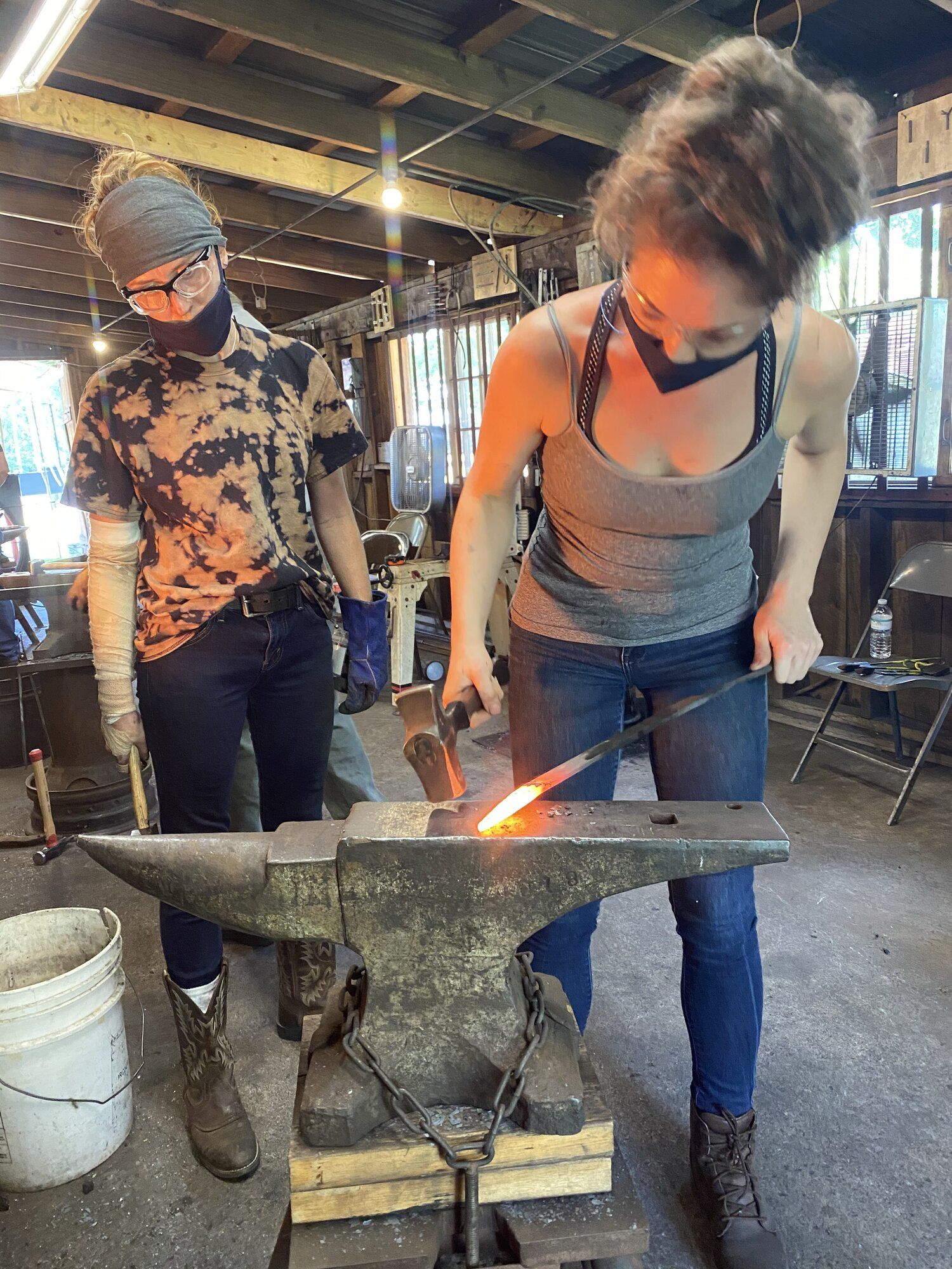

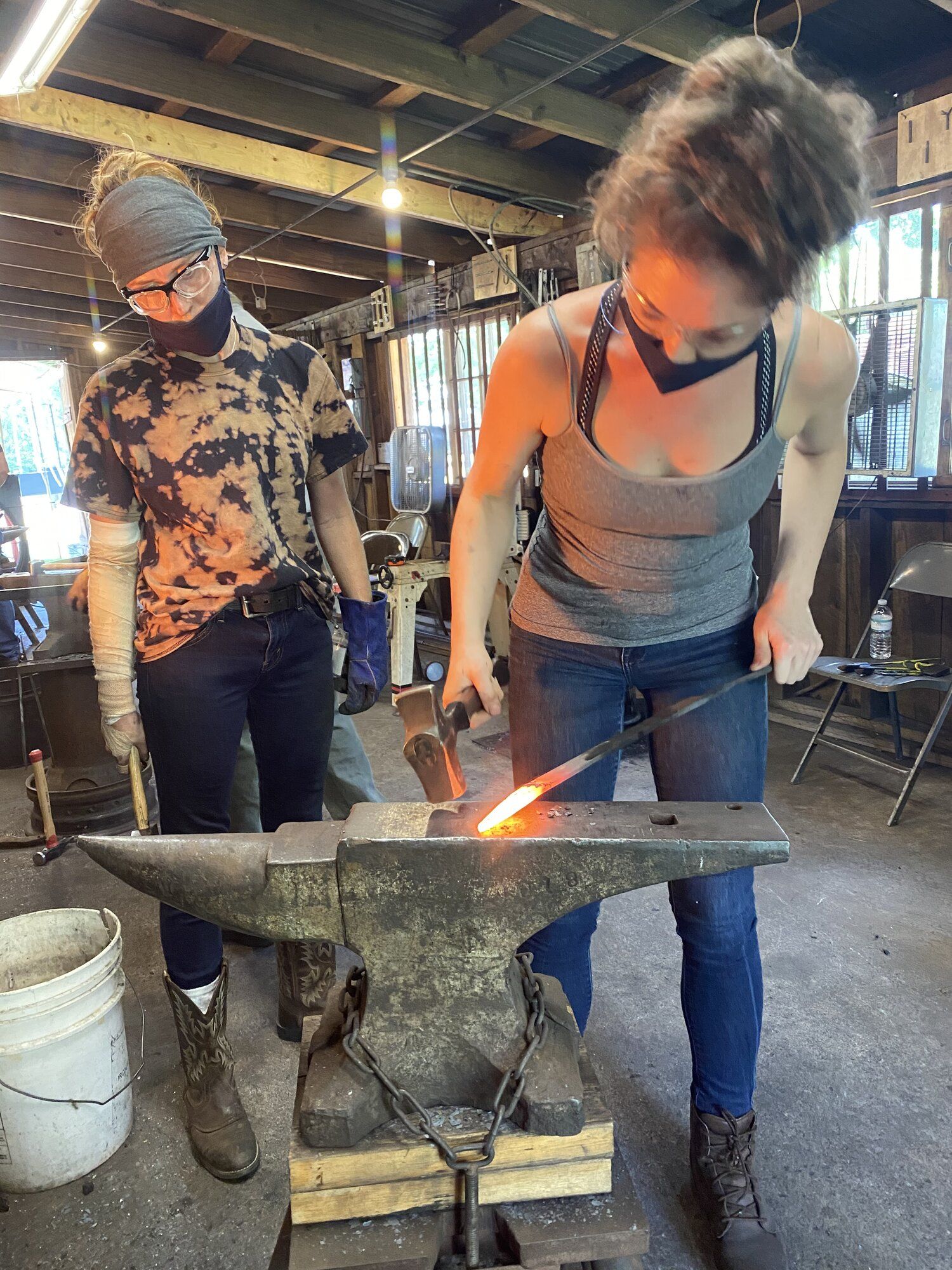

Granddaughter & master smith Ellen Durkan of Iron maiden Forge. , Rutherford County Blacksmith Association.
