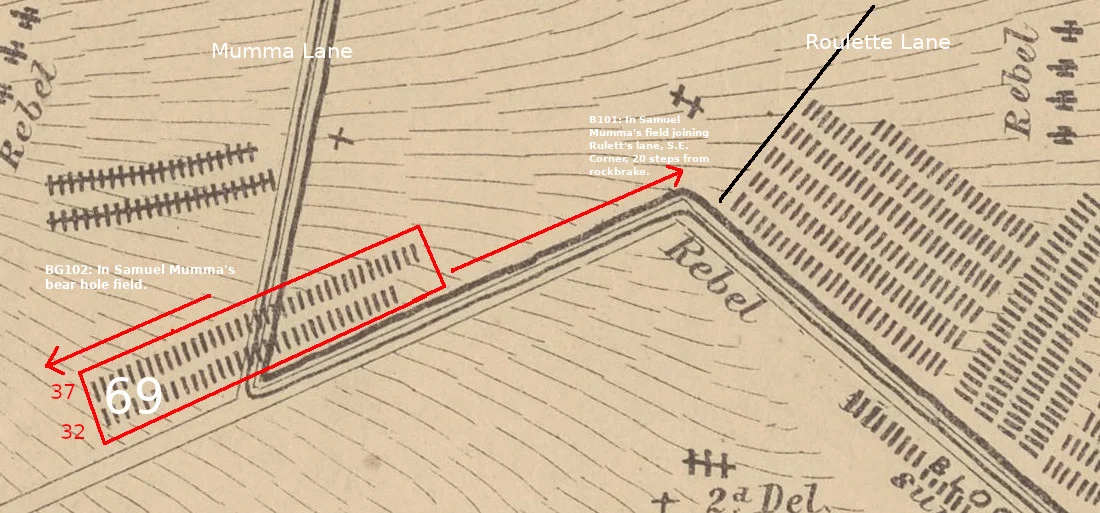

I've always wondered about a set of Confederate burial trenches which the SG Elliott Map places across the Samuel Mumma Lane. It makes no sense because a) the road would be compacted and hard to dig in and b) it was an actively used road.
The Bowie List records graves in this general area, but not in the exact location Elliott placed them: "In Samuel Mumma's field joining Rulett's lane, S.E. Corner, 20 steps from rockbrake."
When we add the Roulette Lane to the map, the situation becomes clearer:
If the graves surrounded by the red box were shifted northeast, they would be in the same location described in the Bowie List:
My hypothesis in this instance is that whomever worked on this section of the map confused the Mumma and Roulette lanes, or was working with materials which made such an error. This would not be the first instance where Elliott appears to have misplaced features. Indeed, this corrective shift would be a relatively minor one compared to some others which appear to be necessary.
One argument against matching the Bowie and Elliott graves is that Bowie recorded 20 graves here, while Elliott shows 69. Indeed, the shorter of Elliott's rows is 32 graves long, which itself is 50% more graves than Bowie's total. But these are the only Confederate graves both Elliott and Bowie placed in this field. Unless Elliott missed the 20 graves in Bowie, and Bowie missed the 69 graves in Elliott, there can be no other candidates. Some of the graves present in 1864 may have been destroyed by 1868-69. I also believe it's possible that at least some of the multi-row trenches on the Elliott Map represent one trench which is two bodies deep, which would appear to contain fewer bodies to an observer in 1868. However one of these observers would have been Aaron Good, who was not only present during the battle but compiled a list of burials within days of its conclusion. One would think he might be aware of double burials.

The second clue is Elliott's depiction of the graves running across Mumma's lane. This is one way to describe these trenches. Another way to look at it is Elliott shows graves in the fields on both sides of the lane, which would be the "field joining Rulett's lane" and the "bear hole field." These are the only graves to appear in either field.
Using that interpretation, for some reason Elliott may have combined the two groups described in Bowie: the one in "In Samuel Mumma's field joining Rulett's lane, S.E. Corner, 20 steps from rockbrake" and the other in "In Samuel Mumma's bear hole field." This would also put Bowie's total for both groups (40) closer to Elliott's (69) and may explain why Elliott shows the trenches running across the lane and into both fields.
If some of these graves were in fact located in the "bear hole field" their exact location is hard to determine. The fact Elliott placed them across the lane may suggest they were near it (the argument against this is that the "adjoining field" graves should not be, based on Bowie's description), that modern satellite imagery shows a low area just west of the farm lane and just north of the Bloody Lane (a location which would have been a logical place to dig a burial trench in 1862), and that Bowie had just recorded graves along the Bloody Lane (suggesting these trenches were at least in the southern part of this field if not along the Bloody Lane itself) all point towards the graves west of the farm lane being in about the right spot on the Elliott Map, but these are speculations and the exact location is open to interpretation.
