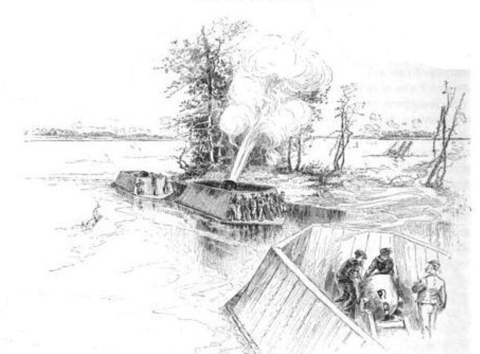

Like many here, I’ve had an interest in CW mortar rafts for many years. Over the years I’ve collected a few photos and woodcuts about them, but few indicate that a rotating mortar base was used. Below is the only one I have which hasn’t been posted. An assumed contemporary woodcut doesn’t prove anything, journalists haven’t improved their accuracy any since the mid-19th century, but it is one data point. Hopefully this helps the OP, at least a little.
Thanks!

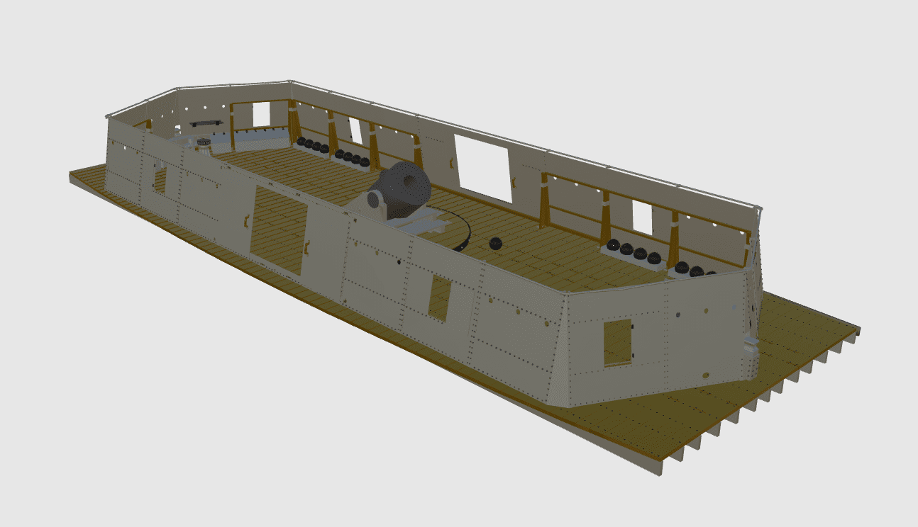

Here is the shaded wireframes of where I am at the moment on this. 10degrees slope on the 3/8ths thick walls. Mortar pegged at 41 degrees. 22 feet at the ends and 25 in the middle. 65 feet long. Hopefully, if things calm down in my life I can finish the hull and move on. If anyone is not using their time machine this weekend, I'd love to borrow it so I can see one of these things up close and personal like.
