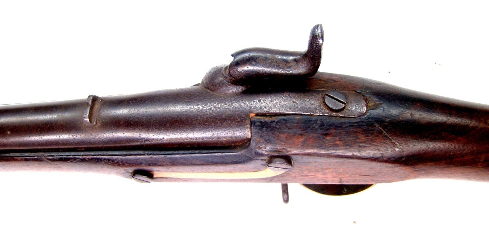

The book you might want is "American Military Shoulder Arms vol.3" by George D. Moller. It has all Flintlock and Percussion alterations of shoulder arms 1840-1865. Regarding the Leman alteration, there is only about one page. The bayonet, 1012 pieces of 1841/42 angular. As the lug was now .11" high , the bridge and locking ring's height was increased to clear the .135" high stud on the altered rifle. The bayonet lug was rectangular .23" x .24" brazed under the barrel. New front sight. Barrel was reduced to .853" tapered to .64" at muzzle. Rear sight was not changed.

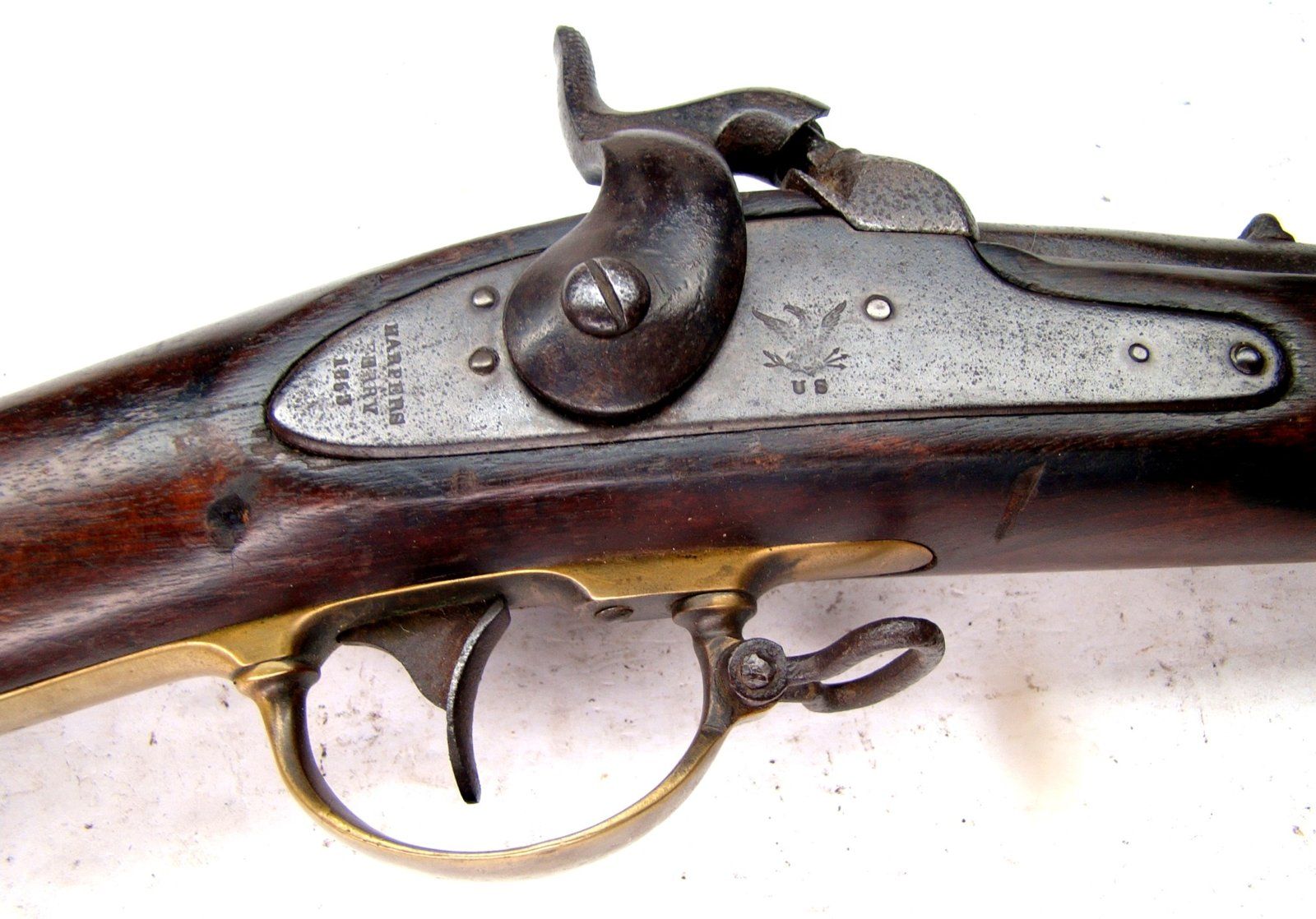

I just bought an M-1841 Mississippi (due to arrive any day now). My “Missy” (she's a bit of a rough-looking girl) was made at Harper’s Ferry in 1853.
In 1861, it had been re-bored to .58 cal, and also had the Leman modification to accept a socket bayonet. These modifications were made to 2,352 of the M-1841s that had been issued to Pennsylvania. Thie picture below shows the Leman modification:

I have a 1841 Mississippi rifle as you described, lock dated harpers ferry 1853 the 3 in the 1853 is deep set and it has been altered to 58 caliber with a socket bayonet affixed with a lug beneath the barrel, the date on the tang is 1848. My rifle has been in my family a very long time and is is near museum quality. I believe the lock plate might have been a replacement when alterations were made. The deep set 3 is identical to an1853 Springfield cadet musket.
Nov 1, 2018
Interesting! Please post pics. The Leman alteration for Pennsylvania was done mostly on Tryon's and a limited number of Harpers Ferry's. Perhaps yours is a Tryon (other than the lockplate)? Lets take a look at the pics and see what the markings tell us.
Thanks for posting details. I was going to ask. I was just interested to see how they attached the lug. I didnt think they could weld steel without hammer forging and losing the heat treatment.
