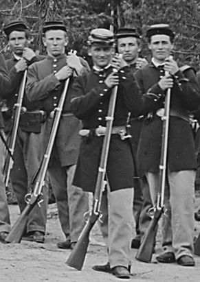

What interest's me is we see everyone with 1842 Muskets, most sighted/rifled, some smooth-bore.
In the close-up photo, I see three of those 1842's, the far right is smooth-bore, the middle one is clearly rifled with the typical long-range rear sight we normally recognize, but the third one on the left, looks like it has a rear sight that is more like that of an 1861 musket. If you look closely at the main photo in detail/enlarged, you see others with the same type rear sight.
Can anyone tell me if it's a variation of 1842 I may not familiar with?

There is another musket with an 1858 style rear sight in the hands of the man just to the right of the officer on the left side of the frame.
George Moller states that some rifled and sighted M1842s are known to have 1858 style rear sights, but they are fairly scarce. He speculates that those sights are encountered on the 1,500 altered at Harpers Ferry and the 110 altered at Springfield in 1859, and quite probably all alterations performed post 1861, of which numerous reports and contracts point to. Moller lists 20,076 only rifled, and 23,683 rifled and sighted from 1856 to 1859.

The smooth bore musket may not be a smooth bore. The government did not always place a rear sight on the M1842s it rifled and there are some contractors (Miles Greenwood) who also did not place rear sights on the muskets they rifled. My guess is that all the muskets in the picture are rifled; the logistics of having both .69 minie and round ball ammunition in the same company would be difficult.
I had in my collection a model 1816, rifled for .69 caliber, Maynard primer added when converted, but no rear sight of any kind. Considering the recoil of firing .69 minie balls the shooter probably shut his eyes and flinched anyway when he pulled the trigger. No rear (or even front) sight required for that.
