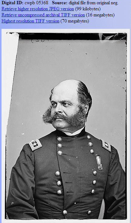

    Anyway, let's move on. For this tutorial I've chosen Major General Ambrose Burnside. Now, I went on http://memory.loc.gov/ammem/cwarquery.html (My preferred website) and searched. Once I found the portrait I wanted by looking through the options in gallery mode, I clicked in on the image, however I'm then faced with three options.
    [IMG]
    1) Retrieve higher resolution JPEG version
    2) Retrieve uncompressed archival TIFF version
    3) Highest resolution TIFF version
    Now, let me explain the options a little bit indepth. The first one is a very small (compared to the .tiff) image that you won't get very far with. The middle, and second, option is a very large image, but it's compressed slightly at the cost of resolution, this particular uncompressed version of the image is 3373x5120. For a comparison, a standard "24 inch monitor is about 1920 pixels in width, so that image is almost double that height. For the uncompressed higher resolution TIFF version, this image baloons to a whopping 4941x7500. Now this is an incredibly large image, and for our purposes, nearly pointless, and this last option should only really be used for when you're doing environmental images, so I chose the middle option, like I usually do with portraits.
    So, let's load it in to Photoshop, by right-clicking it and opening it with photoshop, or simply opening photoshop and dragging it in, either way you do it is fine.
    .tif files usually have one major malfunction, they come in Gray, not RGB mode, which means no color but grayscale can be added, so we have to change that, which is very simple, you go to the dropdown menu at the top named 'Image', then go in to 'Mode', and press 'RGB color'. If you already have layers created like 'Levels' or 'Brightness and Opacity', it'll ask you to flatten or don't flatten, press 'Don't flatten'.

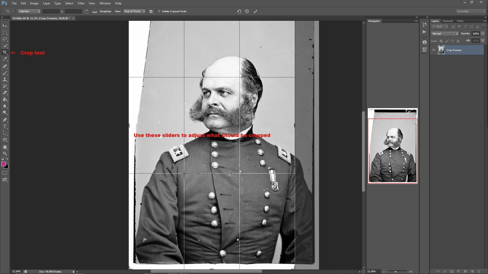

    Alright, now that we've gone over that, it's time to crop out/remove flaws of the image. With CS6, that's made incredibly simple, you press the crop tool
    [IMG]
    The image should be self-explanatory, but this is basically what you need to know to use the crop tool, and don't worry about the layers dissapearing, they'll return once you're done cropping. You can crop out major damage or you can crop out family members if you dislike them aswell, the decision is yours - in Photoshop, you are a God. I chose to crop out the white & black borders, and shave a little bit off the top of his head to just make the image smaller, and more manageable.

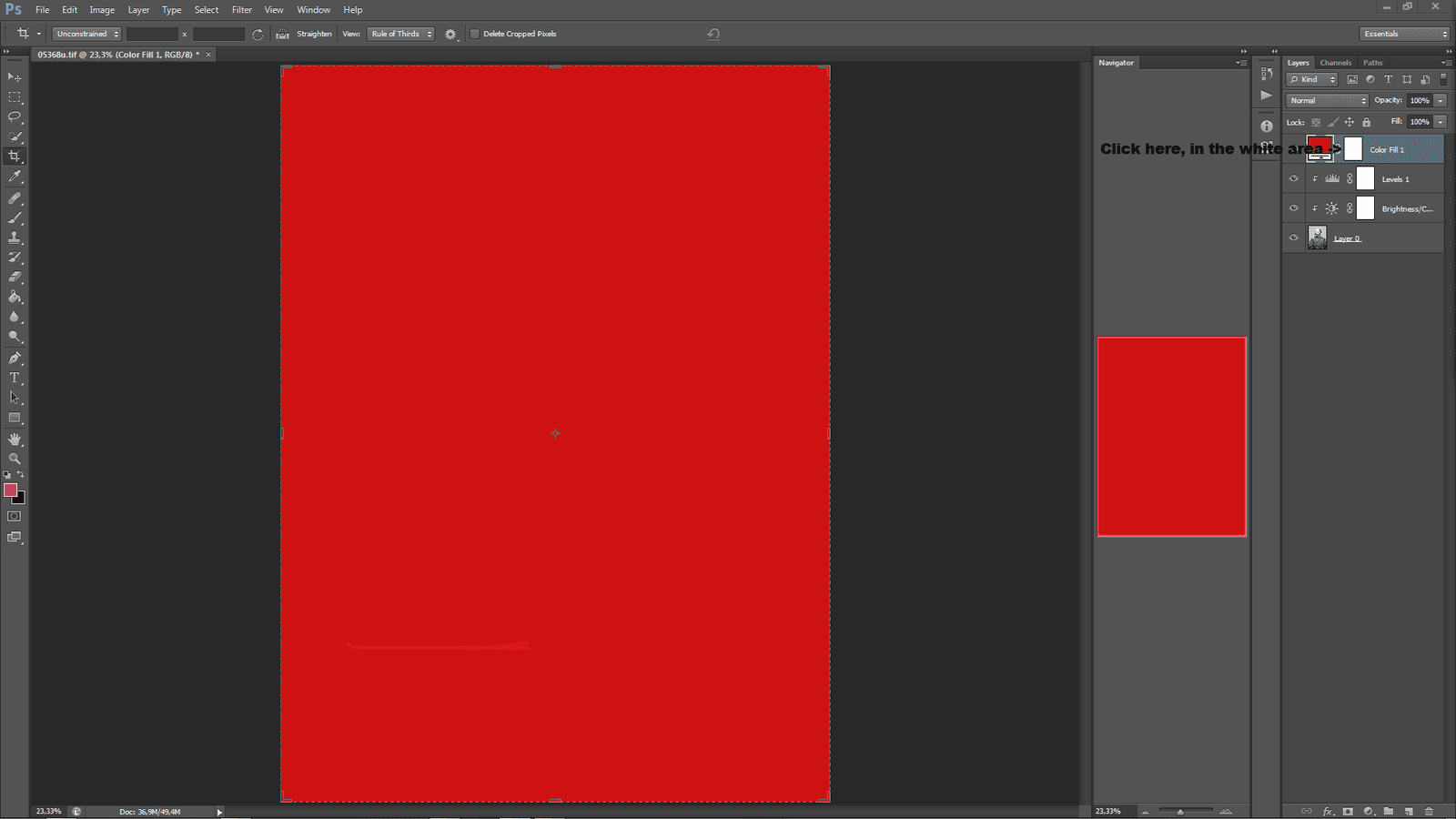

    Right, let me show you what to do when creating a layer aswell, because when you want to colorize, you press the black/grey half-moon and create new 'Solid Color', and you'll be tasked with an image that's completely filled with color, now, what you wanna do is press the white area of the new layer. This is white because of all the color added to it.
    [IMG]
    Once you clicked ONCE there, you hold down Ctrl, and then press A, then press Delete on your keyboard. What this does, is when pressing the white part, you de-select the layer itself, and when using the Ctrl-A command, you select all of the color, and by pressing 'Delete', you're removing all the color from the image.

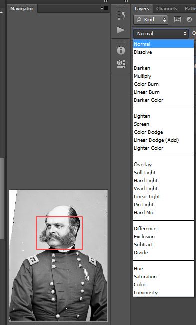

    Before we do anything, change the blending mode to soft light.
    [IMG]
    Soft Light is right-smack dab in the middle, impossible to miss.
    Now, change the opacity of the layer itself to 12% so he doesn't look like a granny smith apple. You can even color the face/skin areas in with bright red to make sure you don't miss anything. The Opacity slider is in the top-right corner next to the blending mode, if you don't know how to find this, I can't give you directions to it, you need to phone me immediately and we'll get you help.

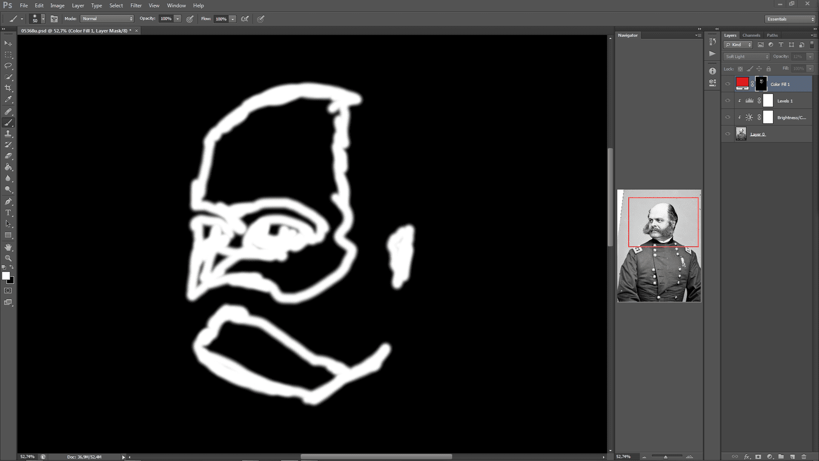

    Here's a little tip that a lot of people might not know. You remember the white part of the layer, the part we Ctrl-A- Deleted? Hold down Alt, and then click it again, this'll bring up a weird new interface.
    [IMG]
    This is the part I've already colored in. You can see where his beard and hair is, you can see where his ear is, etc. Now, the reason for me making closed circles is because, when I hit G, I select a new tool called Paint Bucket tool, by pressing my mouse on his forehead, it fills the layer in completely, save for a little outlining.
    [IMG]
    In this image you can also see where his eyebrows are, try not painting them over, but remove the black areas and make them white by pressing 'B' to select the brush tool again. Holding down Alt and pressing the white part of the layer mask will bring you back to normal, and you can fill the rest out. Because Ambrose Burnside had quite blood-shot eyes in this image, aswell, I decided to paint the red over his eyes. Once you're done, press G again, and click where all the paint is, once for each section, just to make sure we have everything colored in. This is important to do for each layer. Right. Now, the red face layer is only one out of many, let's make another layer with the same opacity and nearly same color code, just a little pinker. This is for the cheeks, nose, and ear area. I also add it over the mouth to give it a stronger red. Since that last layer is very subtle, there's not much point in showing it, let's go over the lips. Take a red layer, maybe a little darker or pinker depending on how the grayscale hue looks, and splash it on the lips.

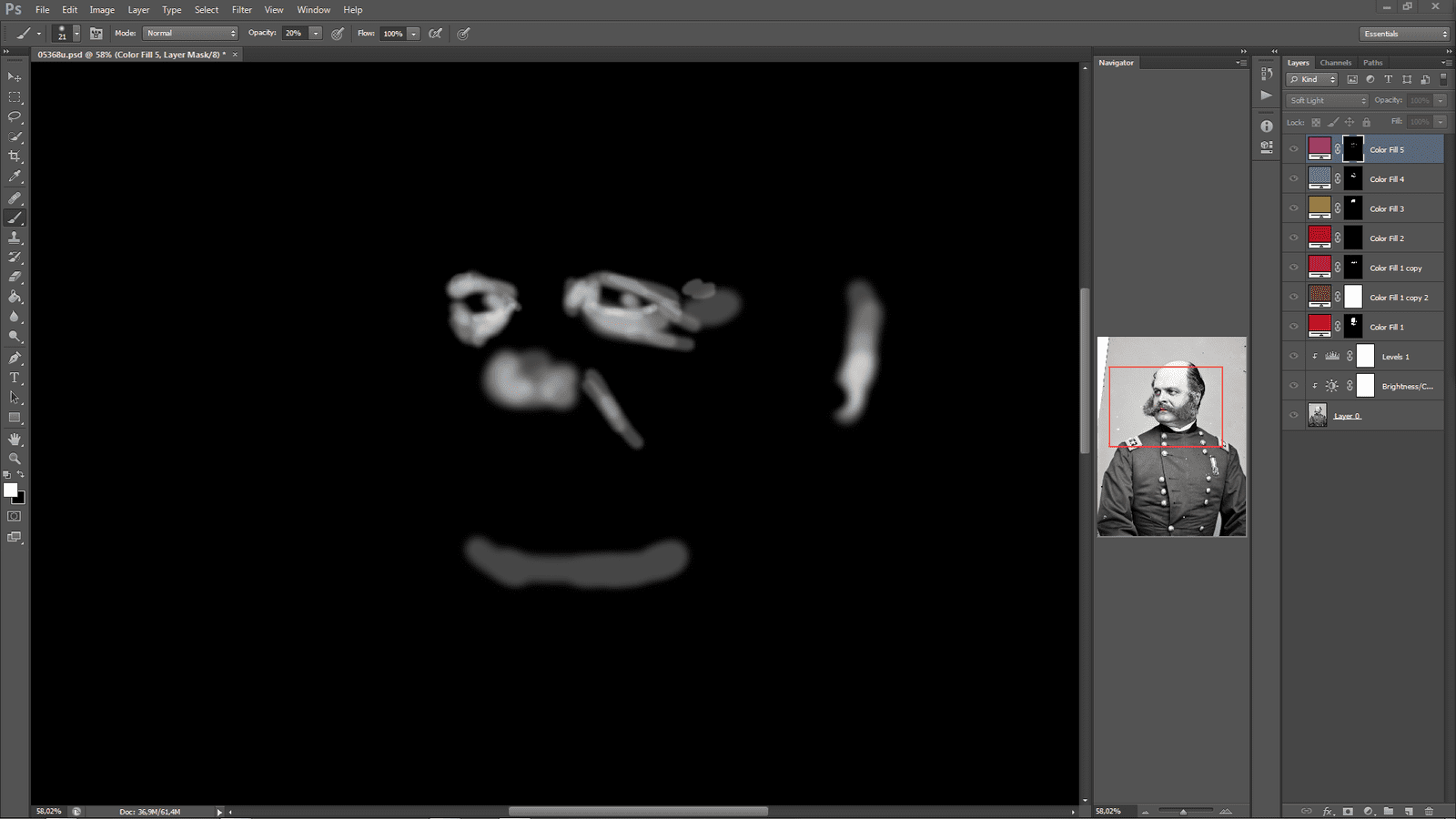

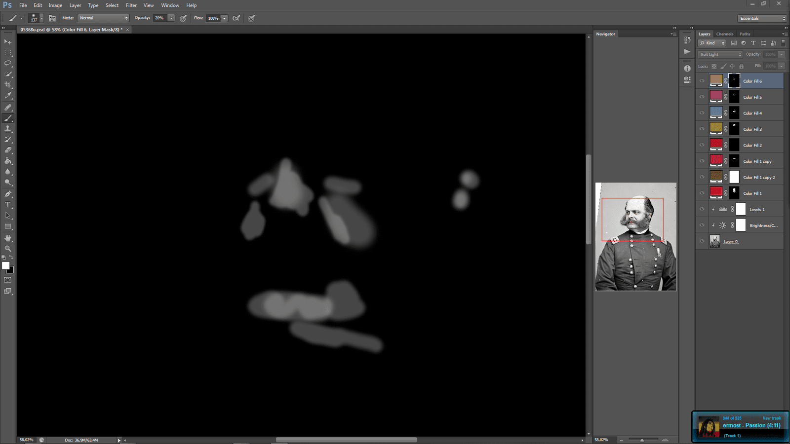

    Now that that's handled, time to color the layer in. You need to remember this next bit.
    Pink in the skin is all over the place, but it's mostly prevalent in places like the ear lobe, the inner and outer parts of the eyes, any creases in the skin, and tip of the nose. Basically any place on your body that feels incredibly warm to the touch, and also any wrinkles will have a little bit in them, aswell as the raised edges of the ear. Here's what I colorized on this particular image.
    [IMG]
    Now for the yellow area. I painted the bottom of the eyesocket a little bit, aswell as the cheeks, and his chin got a splash too, aswell as select parts of his ears. The way I colorize the yellow is dependant on what areas of his skin has a lot of fat in it, i.e. smiling cheeks, skin that's laid close to the bone (Nose-bridge) will also have a bit more yellow skin color to it, here's what I colored in anyway:
    [IMG]

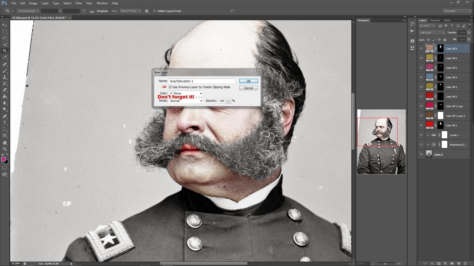

    Now that the entire face is colored in, it'll always look a little pale, I intended that. In the top of Photoshop is a dropdown menu next to the one we used previously. This one is called 'Layer', you need to get to 'New Adjustment Layer' and add a 'Hue/Saturation' layer, now it's important to remember to check the little box that says 'Use previous layer to create clipping mask', so you're editing the layer, and not the image itself. This is what you want to do:
    [IMG]
    Don't forget!
    [IMG]
    Now that that's handled, we'll just leave it for now, this was just to show you how to do it so I don't have to show you later. Let's make a hair-layer. Mr. Burnside has faded-brown sideburns, and slightly darker brown hair, we'll pull the hues out later with some clever stuff, let's add a hair layer, and color everything in, I always use a slightly faded brown because of a little trick I learned not too long ago.

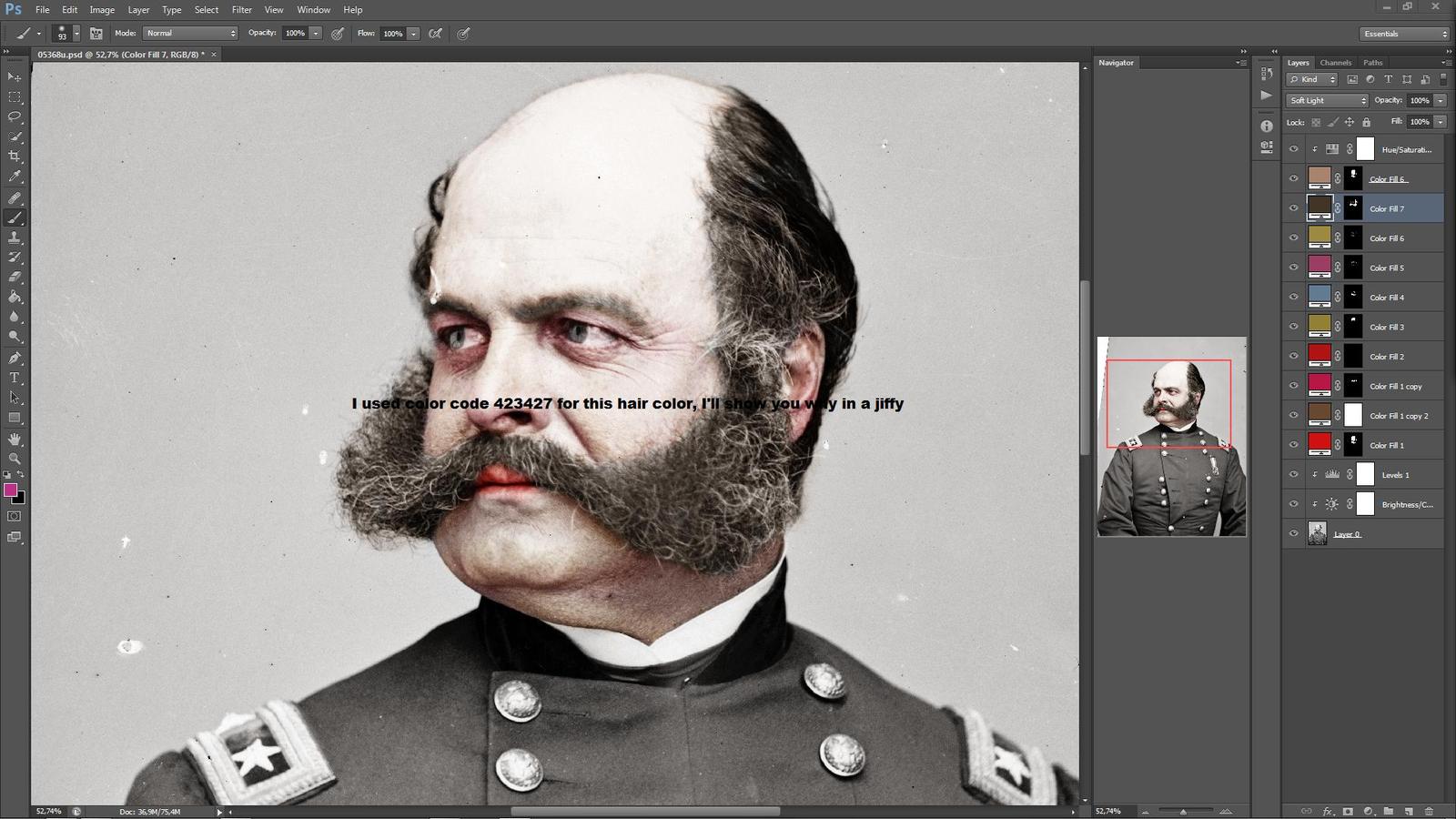

    Skin color to the hair will make the entire thing seem a lot more natural, so, if you've read the entire thing, you should know how to turn your brush opacity to 20%, let's do the same here, and select your skin layer, and start adding a lot of it to the hair, and a little bit less to the beard. I'll show you how to draw out the individual gray hairs and accentuate them in a little bit.
    [IMG]
    Big change. Now press 'E' to select your erase tool, and turn the opacity of this down to around 10-15%, and find any gray hairs in his beard that stands out, and then erase the skin color off of it, very simple, but incredible results.
    [IMG]
    Right, so I took out a lot of skin color along his beard, some in his eyebrows, and a lot aswell in his hair. Any whiter-than-usual hair needs to get some color removed from them to look natural. Now, let's pick an eye color. Depending on the lighting this is incredibly easy to tell. Ambrose Burnside had clear eyes in black/white hue, this is usually an indicator that he had blue eyes. If they were darker and less a lot less clear, they're usually brown. I've yet to hear of a General with green eyes, but there are of course green-eyed people out there (Including yours truly.).

    Any idea how to do this step wth Photoshop CS2 (I know it's ancient)? The folowing step(s) do not seem to work with this version of PS
    "Once you clicked ONCE there, you hold down Ctrl, and then press A, then press Delete on your keyboard. What this does, is when pressing the white part, you de-select the layer itself, and when using the Ctrl-A command, you select all of the color, and by pressing 'Delete', you're removing all the color from the image."
    [IMG]
  15. Joshua Horn Sergeant
    Member Since:
    Apr 9, 2012
    Message Count:
    585
    Location:
    Wake Forest, NC
    What you want to end up with is a layer filled completely with color, with a mask applied and set to completely black.
    Look at step 2 from this link:
    http://digitalscrapbookplace.com/university/tutorials/ps_layermasks.shtml
    You then want to click on the mask (the icon to the right in the layers panel) hold ctrl and then press a to select all and then fill it with black and then continue following Zuzah's tutorial.
    Let me know if that makes sense

    If I follow your question you can remove or add the mask to the whole image by just using the paint bucket, and filling the image with white to add the mask or black to remove it..
